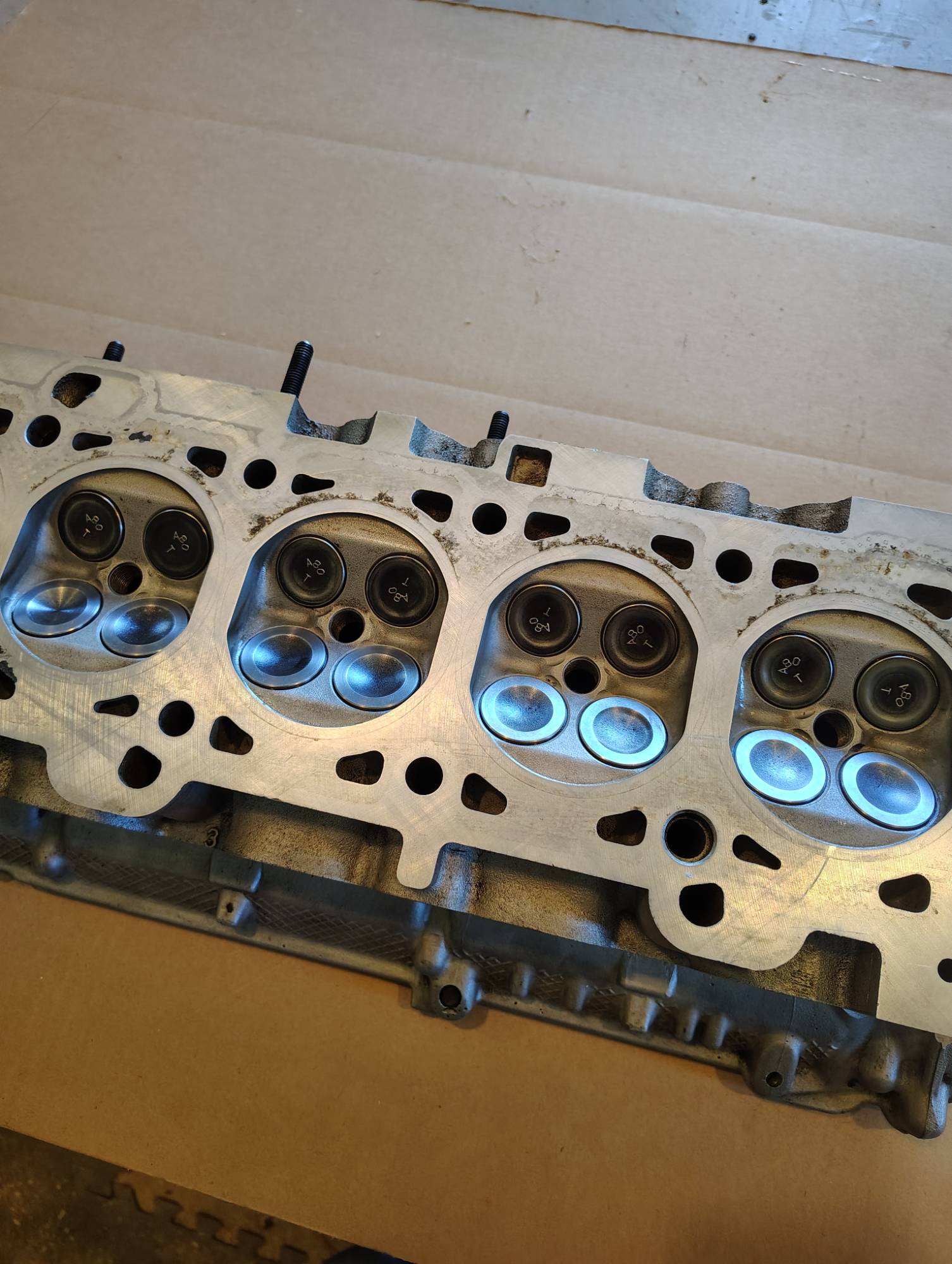

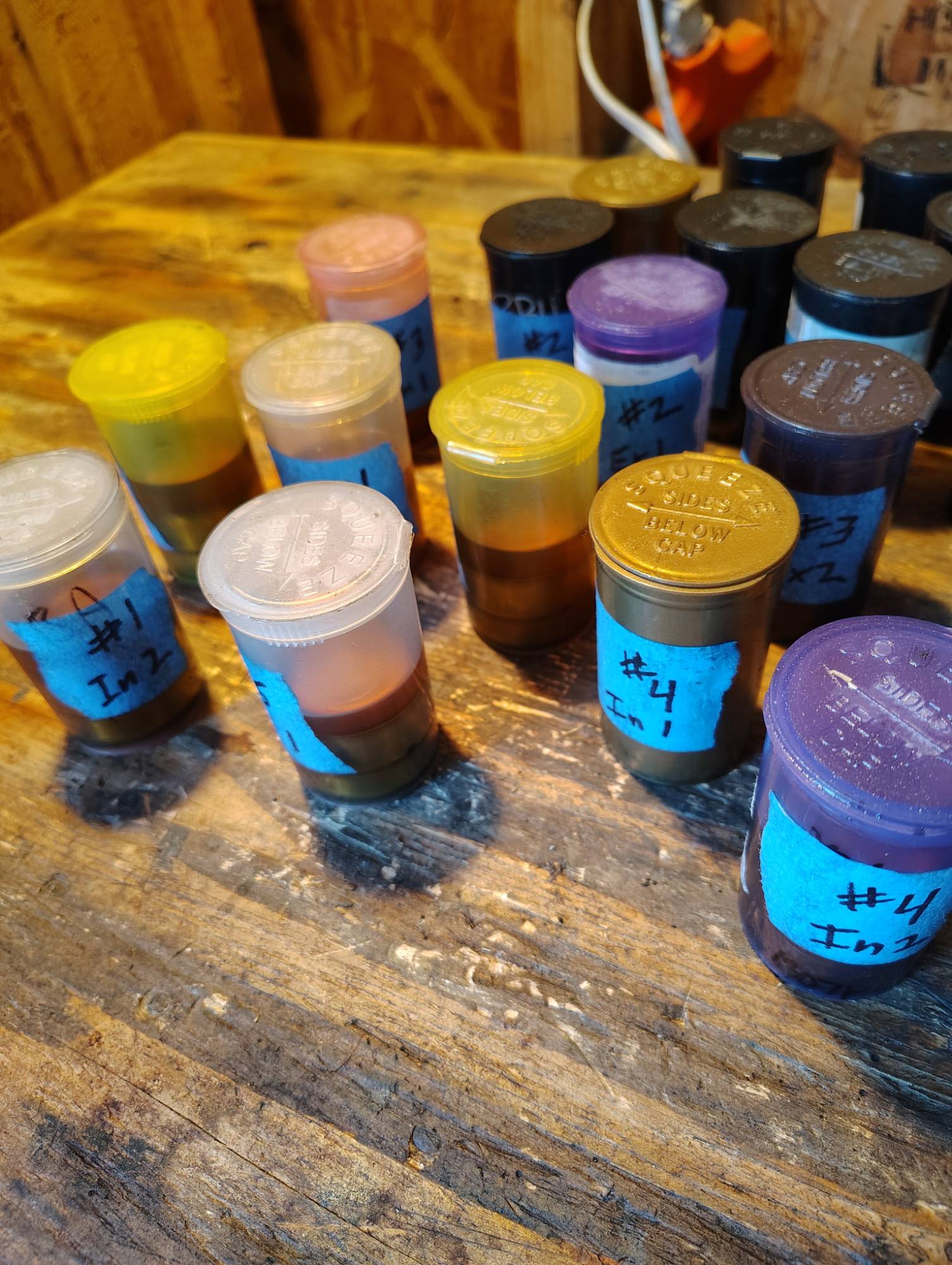

Well after receiving the valve stem seals a few days ago ( mucho Thanks abscate ), I was able to assemble and install the head.
I'm feeling like it's all down hill from here. Fingers crossed.
Lifters sitting in oil awaiting install

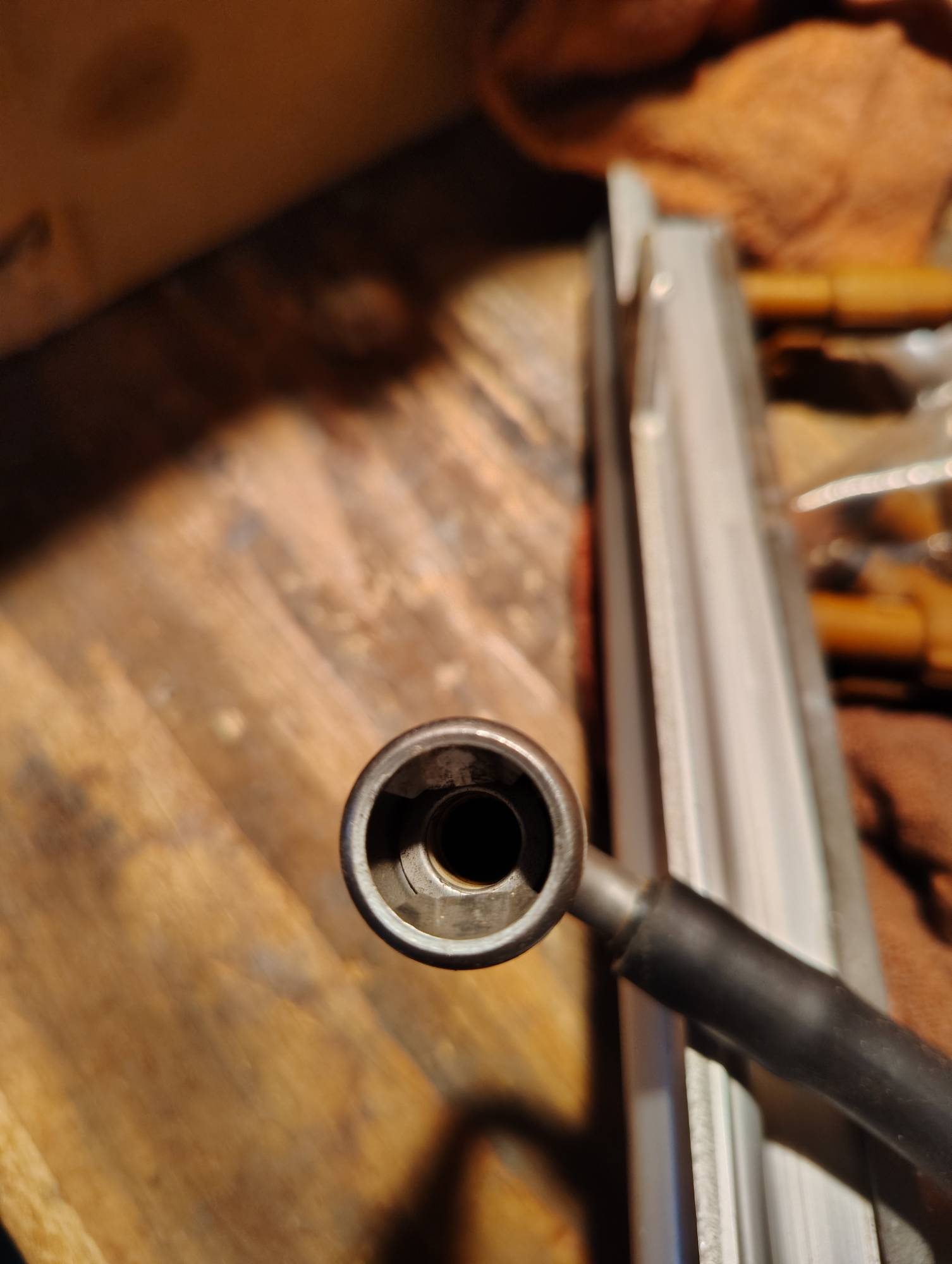

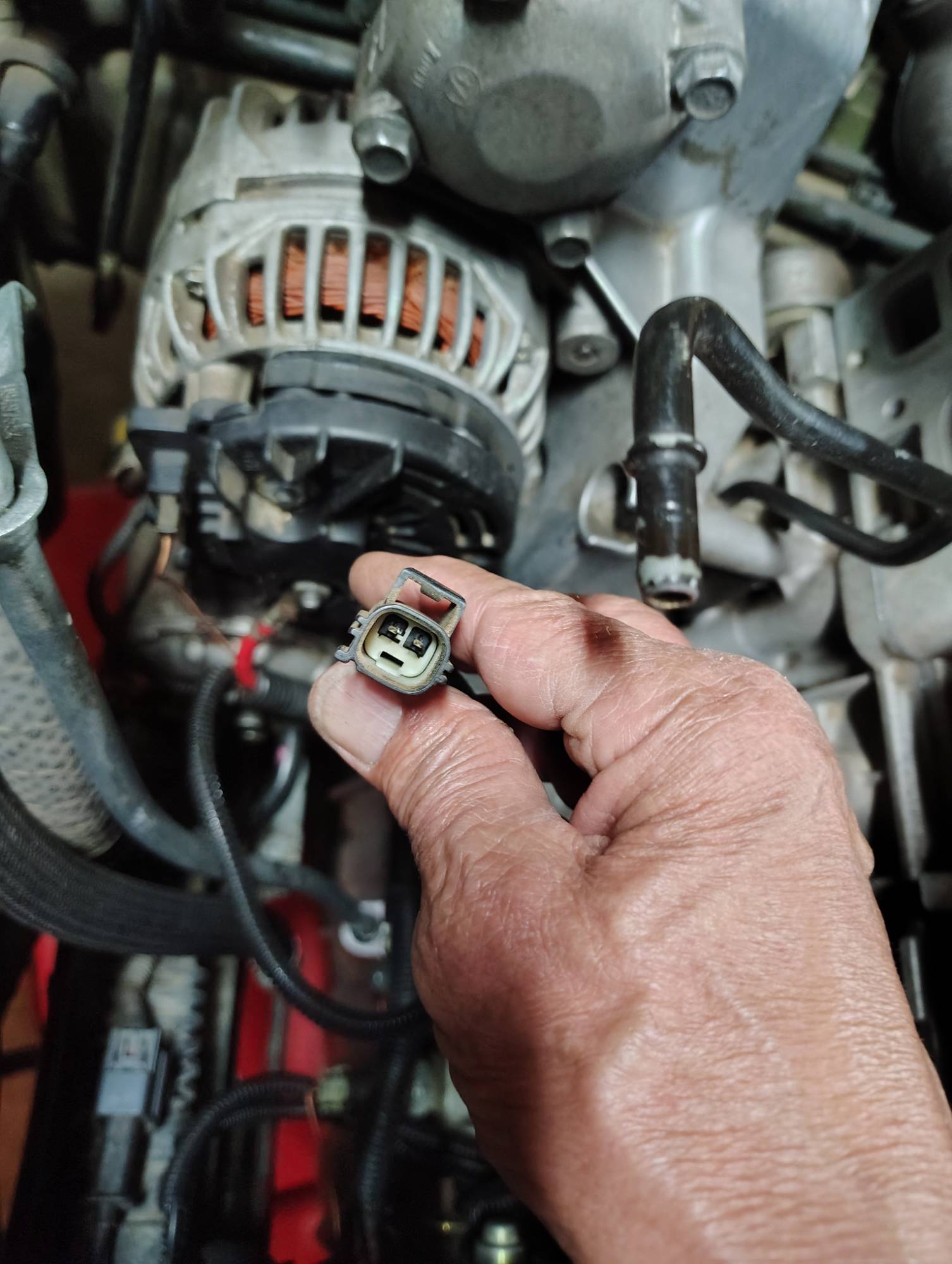

So I was looking at the fuel line connector at the fuel rail and I'm wondering how this thing seals. The 850 has no such thing.
It looks like there is an o-ring in there, but how do you service it ?
Also have this connector on a pigtail that comes out of the harness at the alternator. It looks like it needs a male plug, but I haven't seen one looking for a socket. Is it maybe the ECT connector ? I'm still missing that part.
1999 V70 GLT
Posts: 36154
Joined: 17 Feb 2013, 17:54
Has thanked: 1610 times
Been thanked: 4071 times
The hard fuel line slides right into that bell shaped connector and seals on those O-rings
It’s right above your index finger holding the ECT connector
THat is the ECT connector for the 99 00 years

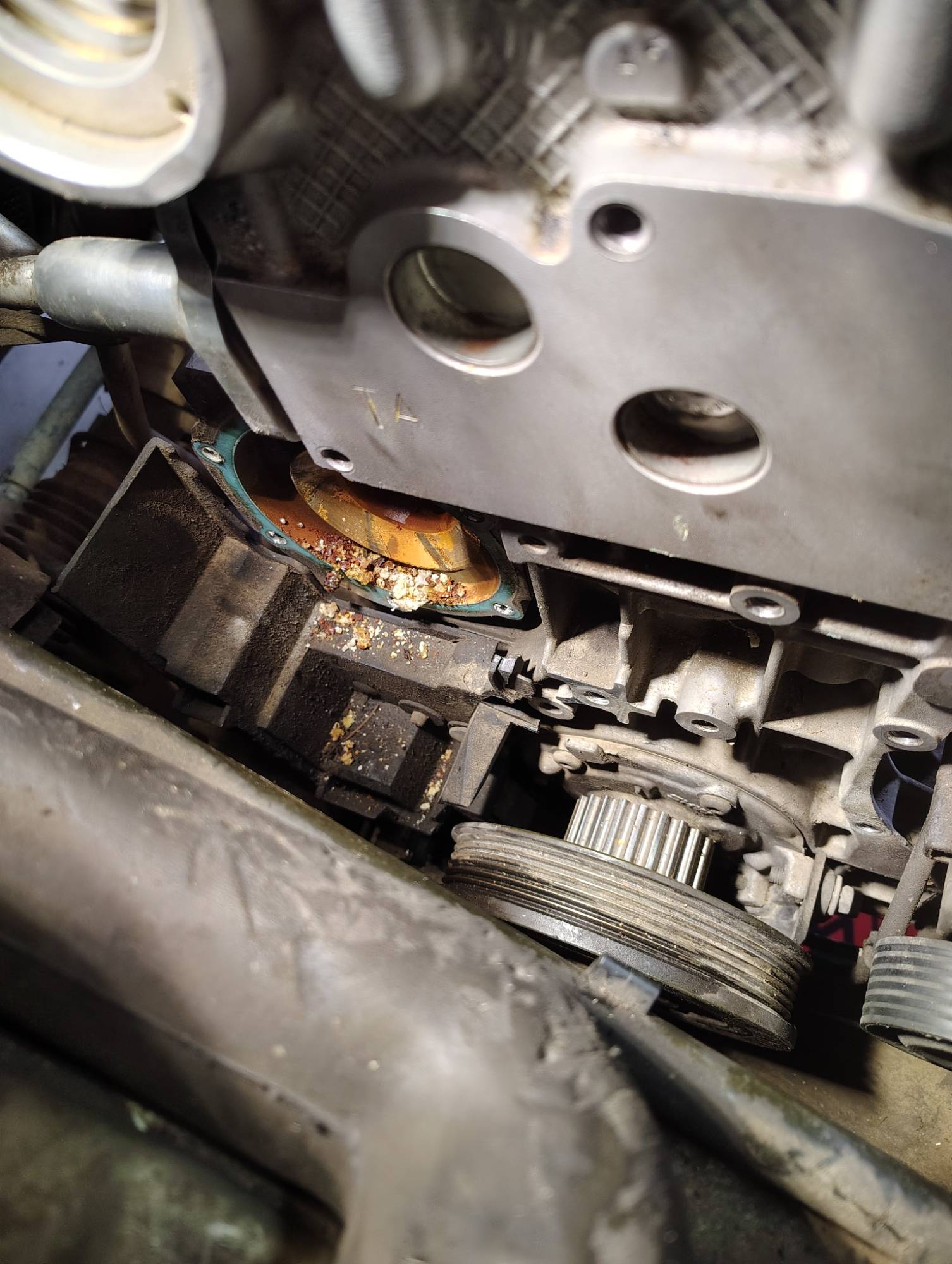

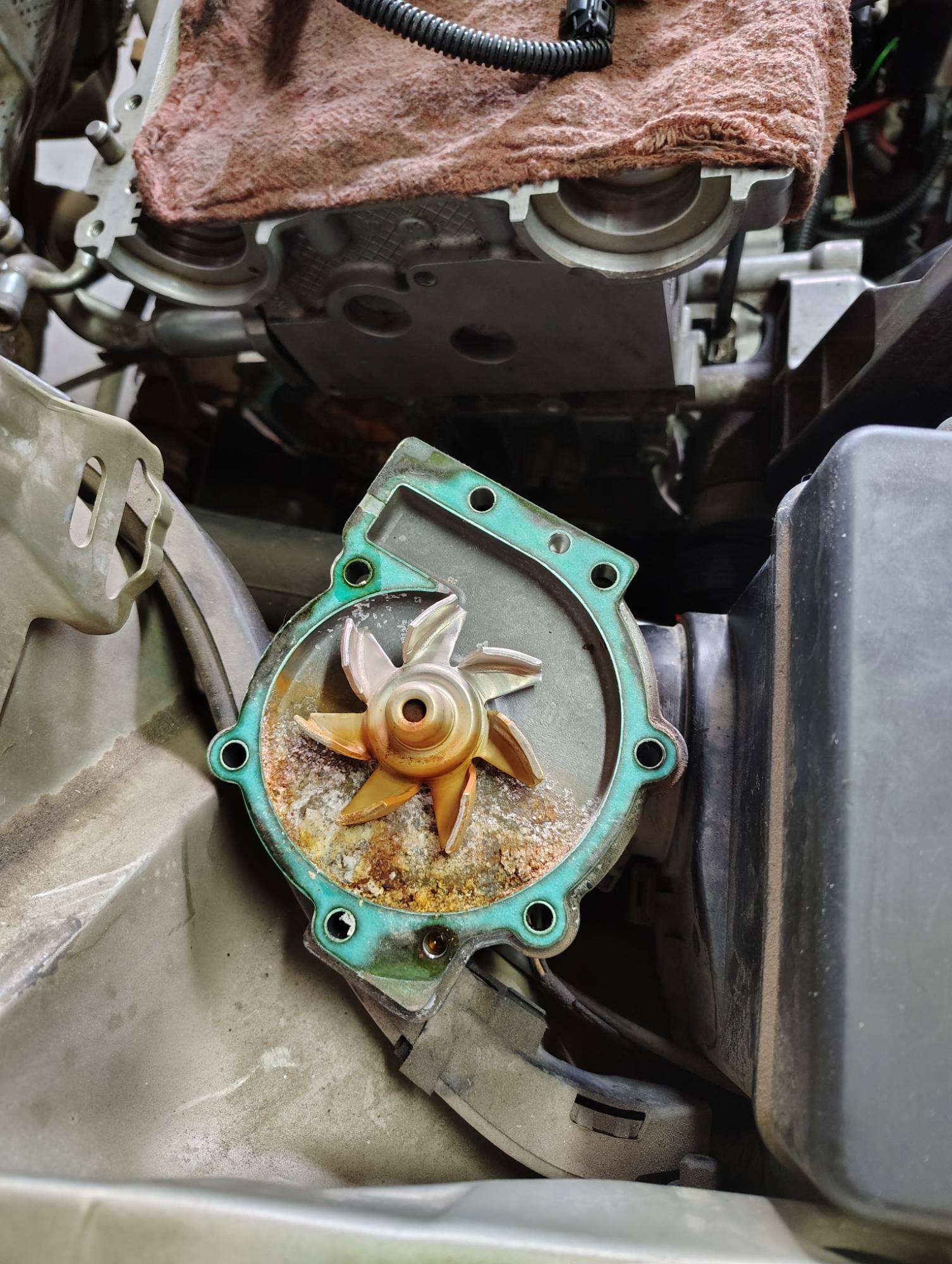

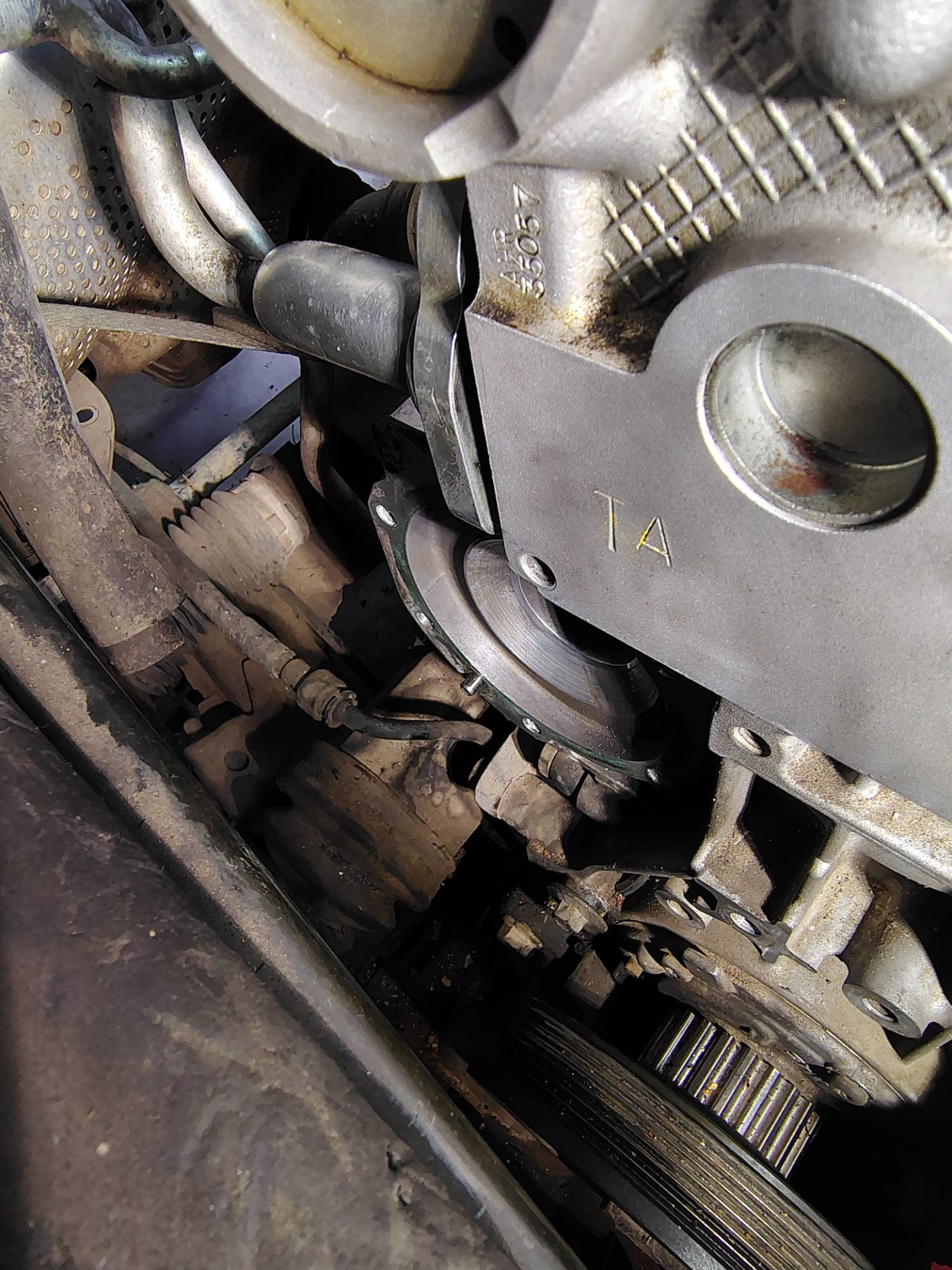

I'm guessing that the previous owners didn't use distilled water or a premix for the coolant system.
Now I'm thinking that maybe I should try and flush the block out before I install the new pump. Maybe just stuff a hose in there and give it a blast... ? After installing the cam cover etc of course.
