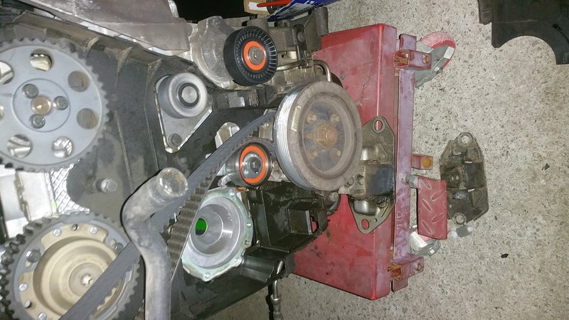

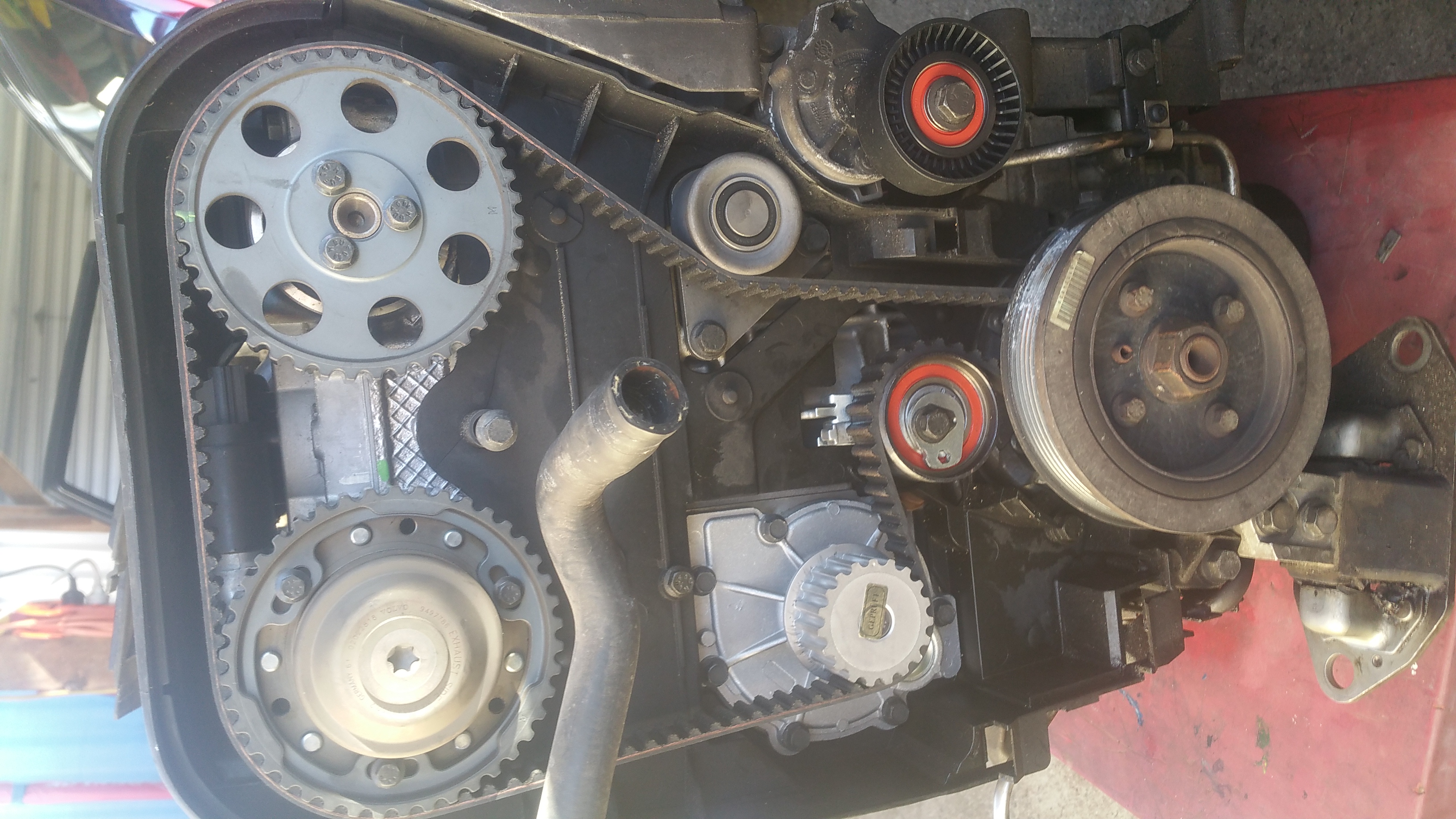

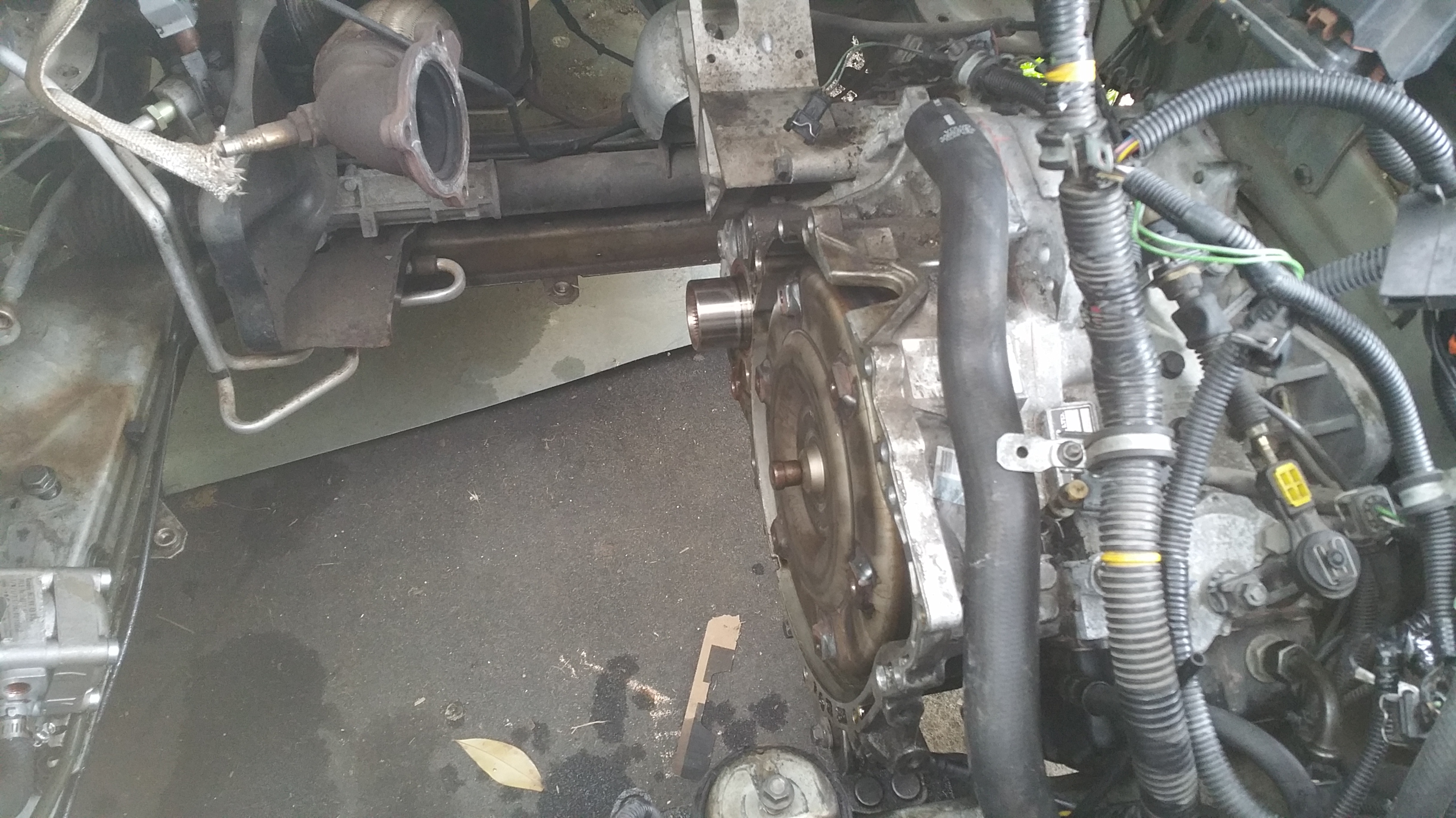

Picked up a 2002 auto and engine from a pick and pull as a complete assembly for $356. Car it was sourced from was written off due to a front corner collision.
I jerked it from the top by bending over the ABS unit and fuse assembly. Wasn't too bad. Left the angle gear on during the pull and had some clearance problems at the edge of the wiper cowling however went better than expected.
Need a new water pump. Will spring for a Hepu next week as they come with bolts and it will be a low annual mileage machine..

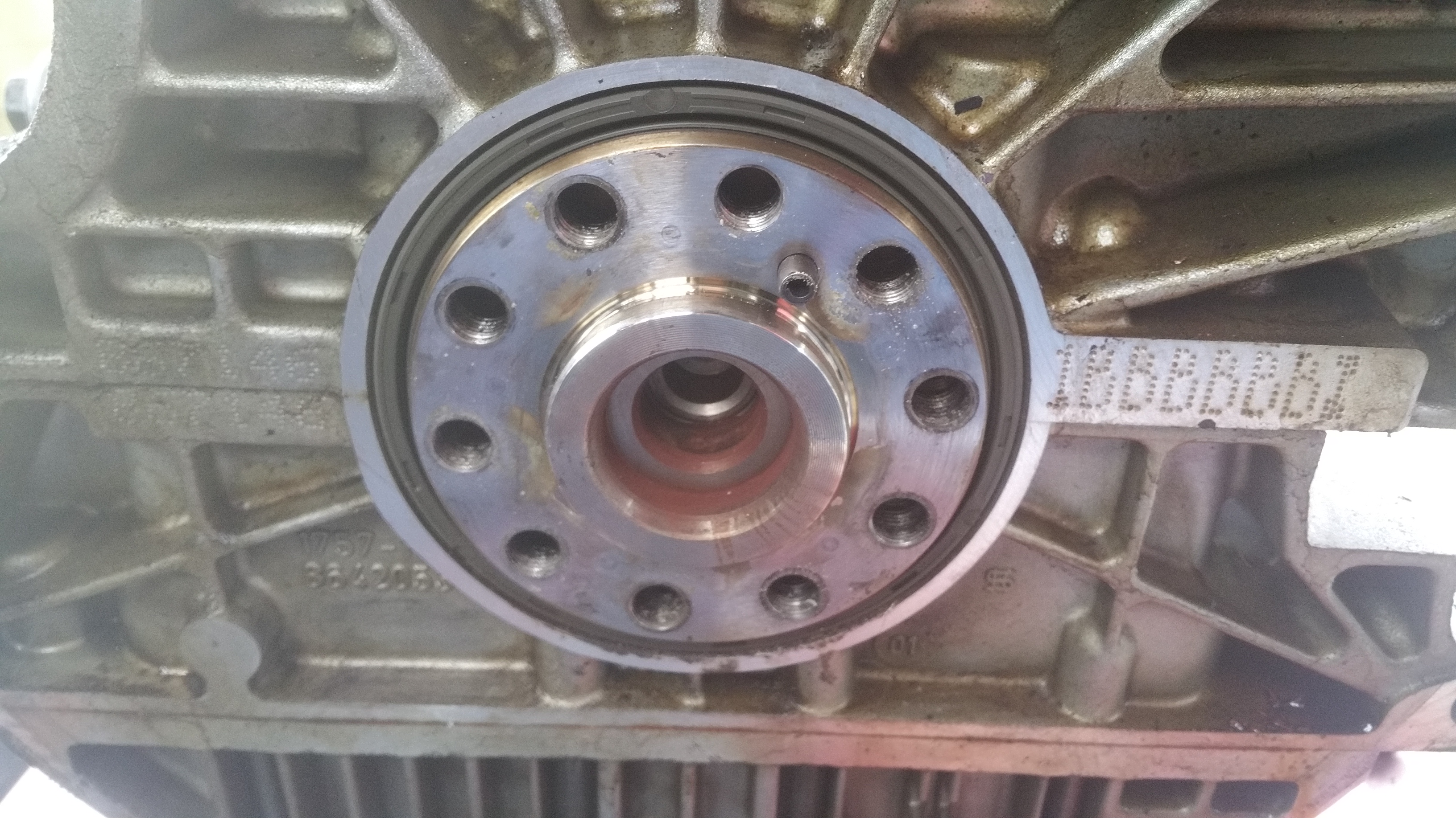

I'm using a 2002 thermostat and upper radiator hose with a 2001 temp sensor. I have only one potential problem and that is the 2002 crank sensor has a new design and plug. Have to take measures to see if 2001 and 2002 crank sensors have the same impedance.... In order to swap the crank sensor and crank sensor carrier the transmission needs to be separated from engine. Want to avoid this however now is the time for an RMS so I guess I'll just do it..
Yes lots of other projects have come and gone for me yet this one is 3 years in the making

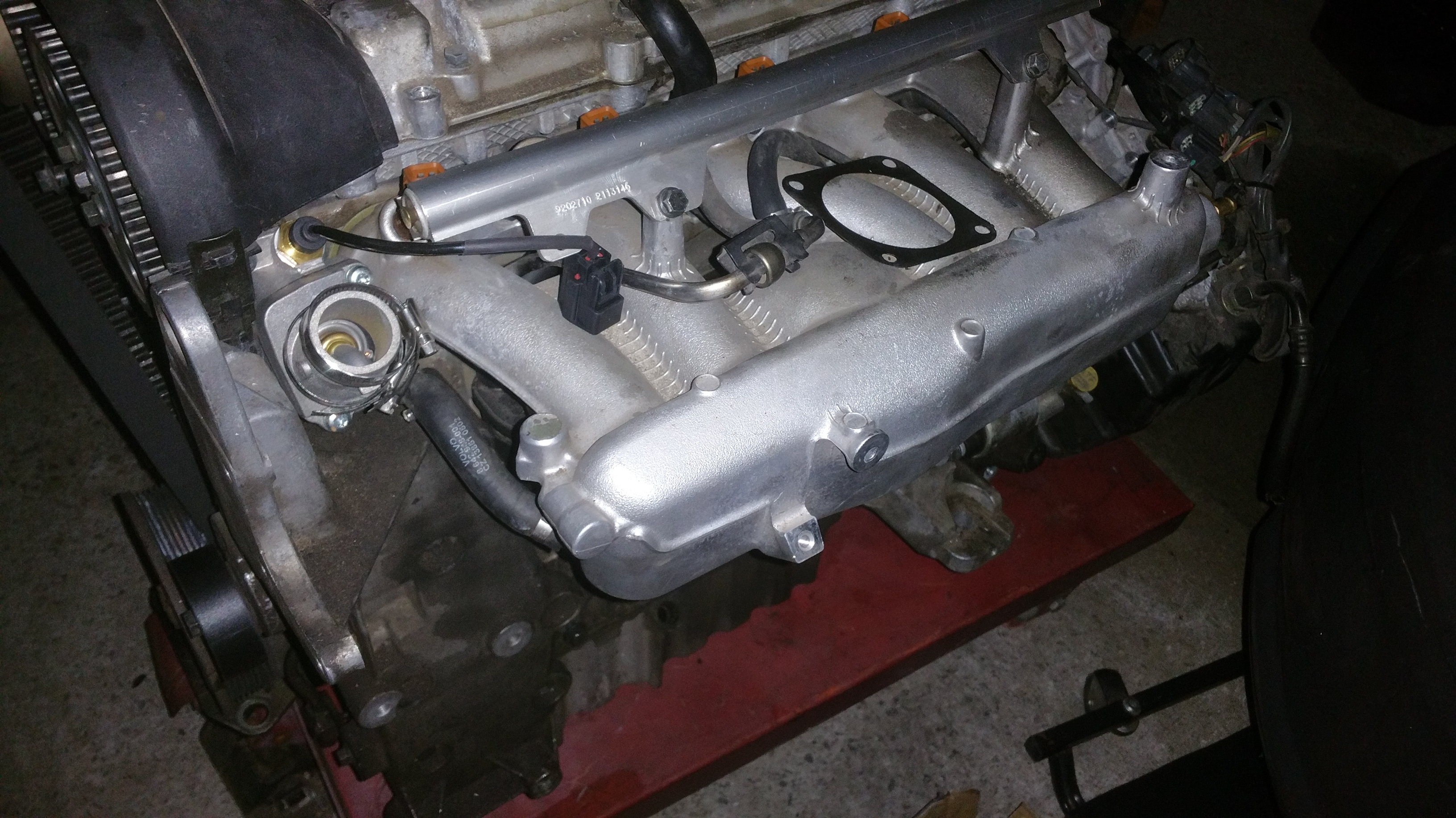

@fixer333 I fitted the LPT motor to a V70 T5 (another project car
That one will also be finished shortly now that Spring is finally here.
Some more progress and another step sideways. Broke the accessory bracket by using a short chain instead of a load leveler. Those accessory brackets can't withstand much sideways force on the lifting eye. It was a good thing that it broke only two inches into the lift......have to thank my lucky stars for that.
Hooked up a battery today only to confirm that the sunroof control and extra two reading lamps are still not working so I'll ask Henry for a UEM software reload.
Still need a good ABS pump and a good throttle so another visit to a pick and pull tomorrow should yield some more pieces.

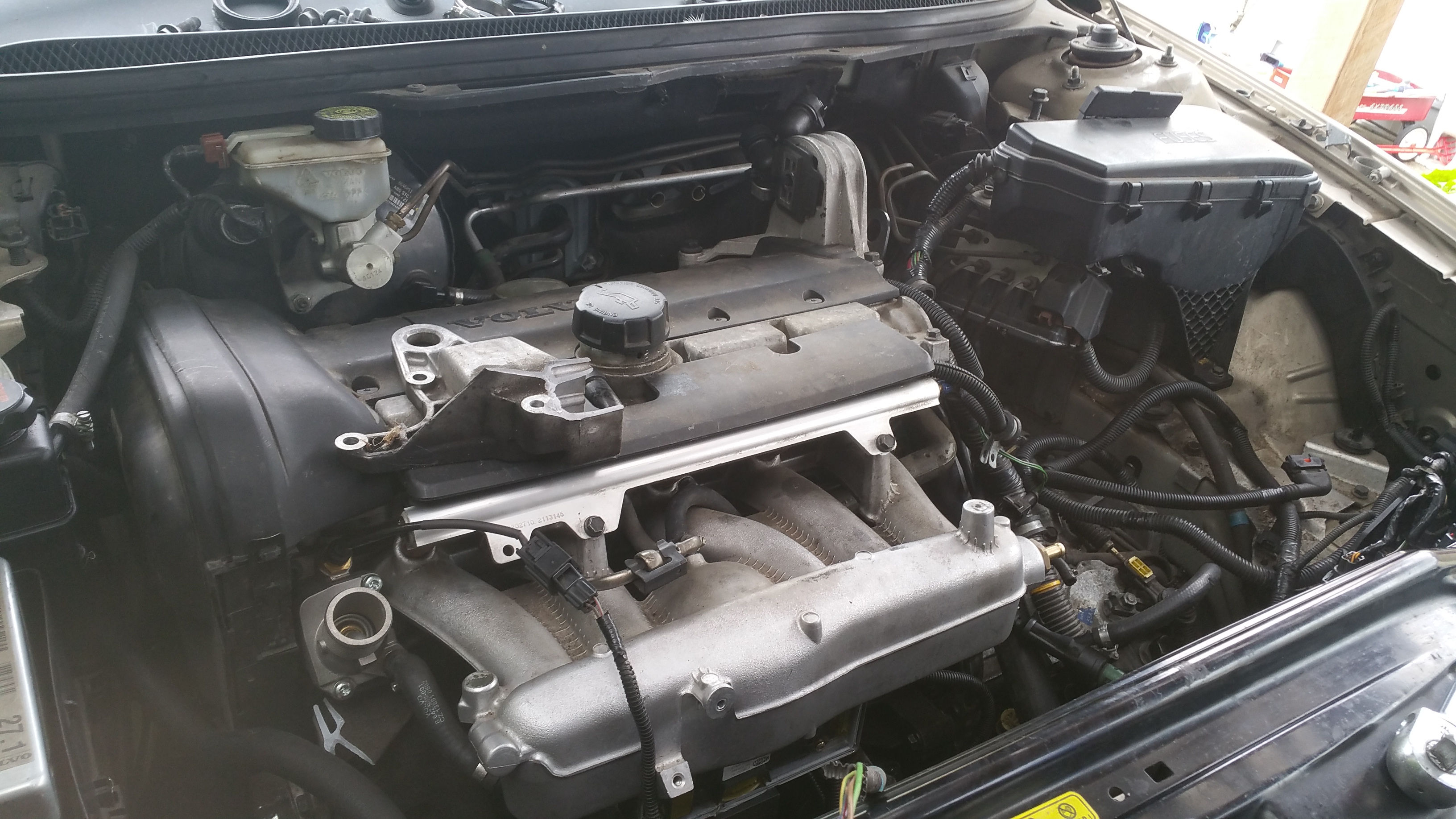

First road test last night!!
ETM hose blew off midway around the block but has great response and transmission will be a real beauty after an adaptation.
Heat shields need to go back on the exhaust manifold and tidy up some wiring. I removed the tailshaft last year and this has given her heaps of pep!!
Can't believe it sat here since late 2012 without being driven.
