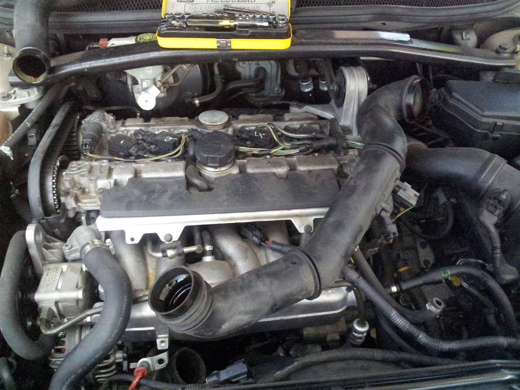

- Lots of conduit work to do
- 20130209_151809 (Large).jpg (181.97 KiB) Viewed 3712 times

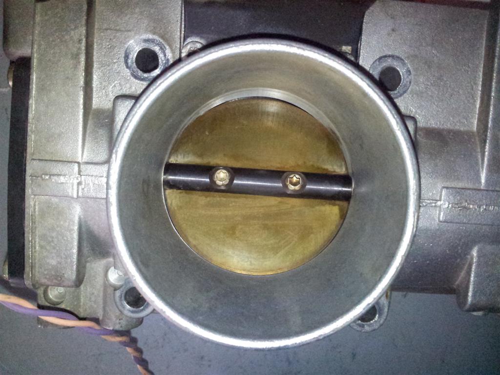

- Cleaned the ETM before Sacer sensor fitment
- 20130209_151956 (Large).jpg (160.47 KiB) Viewed 3712 times

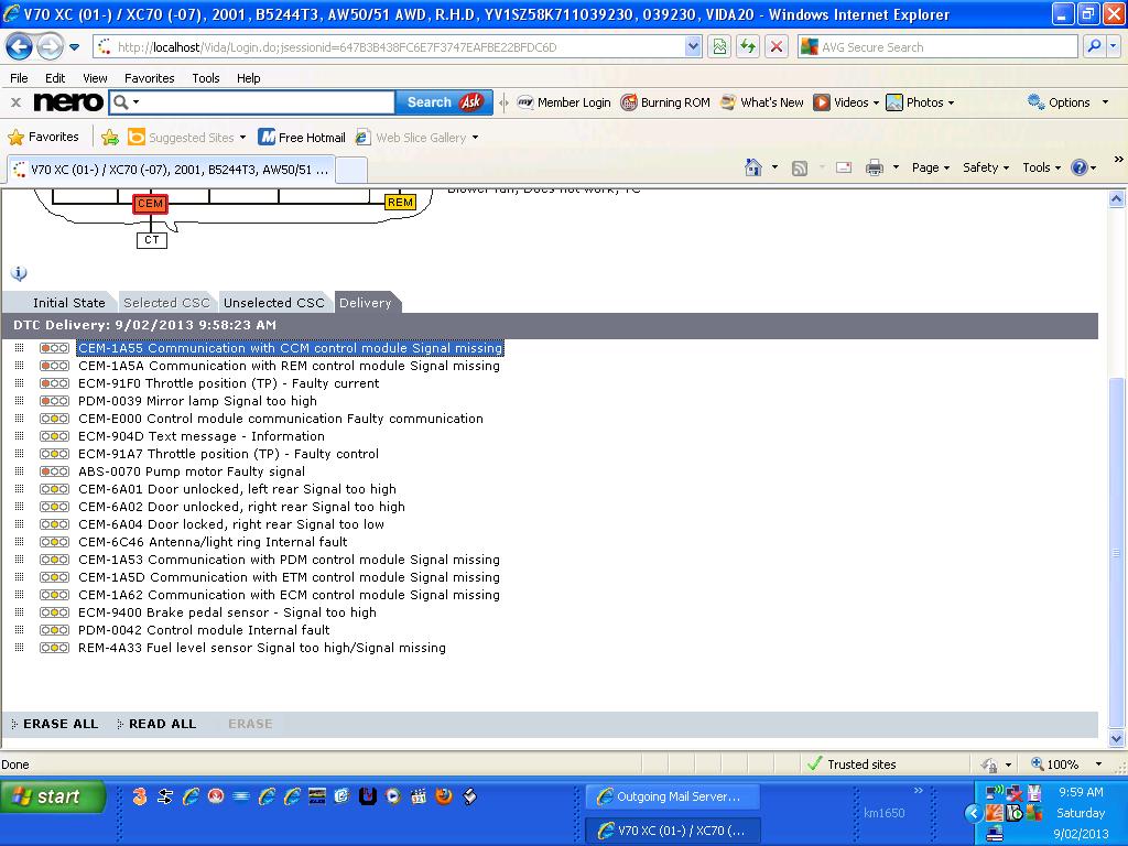

- DTCs 1.JPG (128.75 KiB) Viewed 3712 times

ETM from a 2000 S70 with updated software installed today with Sacer sensor. New gasket also. The original ETM hadn't been updated so I did a swapover from my stock rather than a rebuild to save time. Replaced a bunch of conduit to the wiring leading to the intercooler plumbing. I also disconnected the fuse to the passenger door as the courtesy light relay for the door mirror seems fried as I can hear it sometimes flickering in the door and then the lamp stays on, flattening the battery.

- A shot of the Sacer sensor
- uploadfromtaptalk1360402341226.jpg (71.67 KiB) Viewed 3706 times
- ETM from S70 '03 build with updated SW
- uploadfromtaptalk1360402601953.jpg (92.23 KiB) Viewed 3706 times

At first it was a little shaky and I had to reset ETM codes a couple of times. The brake pedal position sensor is still lighting up on Vida so I'll need to order one. The idle is 640rpm....seems a little low???

Removed the brake pedal position switch. Remembered to let all the vacuum out by repeatedly pressing the brake pedal. This stops the O ring from being sucked back into the booster. The position switch is held in place by a simple spring steel ring that is flicked out of a recess with jeweller's screwdrivers (don't worry about losing it as it's captive)
It was difficult to remove all the sealant but after 15 minutes I gave the connector a pull and cracked it. Later I repaired it with my iron. Once it was out I soldered the terminal back onto the board and a little way down the brass plated track. Then I repaired the broken connector as best I could. I used plumber's sealant around the sensor.
Checked the impedance with a DVM and it ranged from 3.5K ohms to a near short if memory serves right.
Sealed it back up again and cleared the previous ETM codes and ECM codes with Vida.
The occasional hesitation and hiccuping seems to be gone. The reduced performance message has gone as well as brake pedal position code and an ETM code I think it was 904D and all seems good.
Also replaced the MAF sensor and readings became far more stable at around 17kg/hr at idle without much variation.
