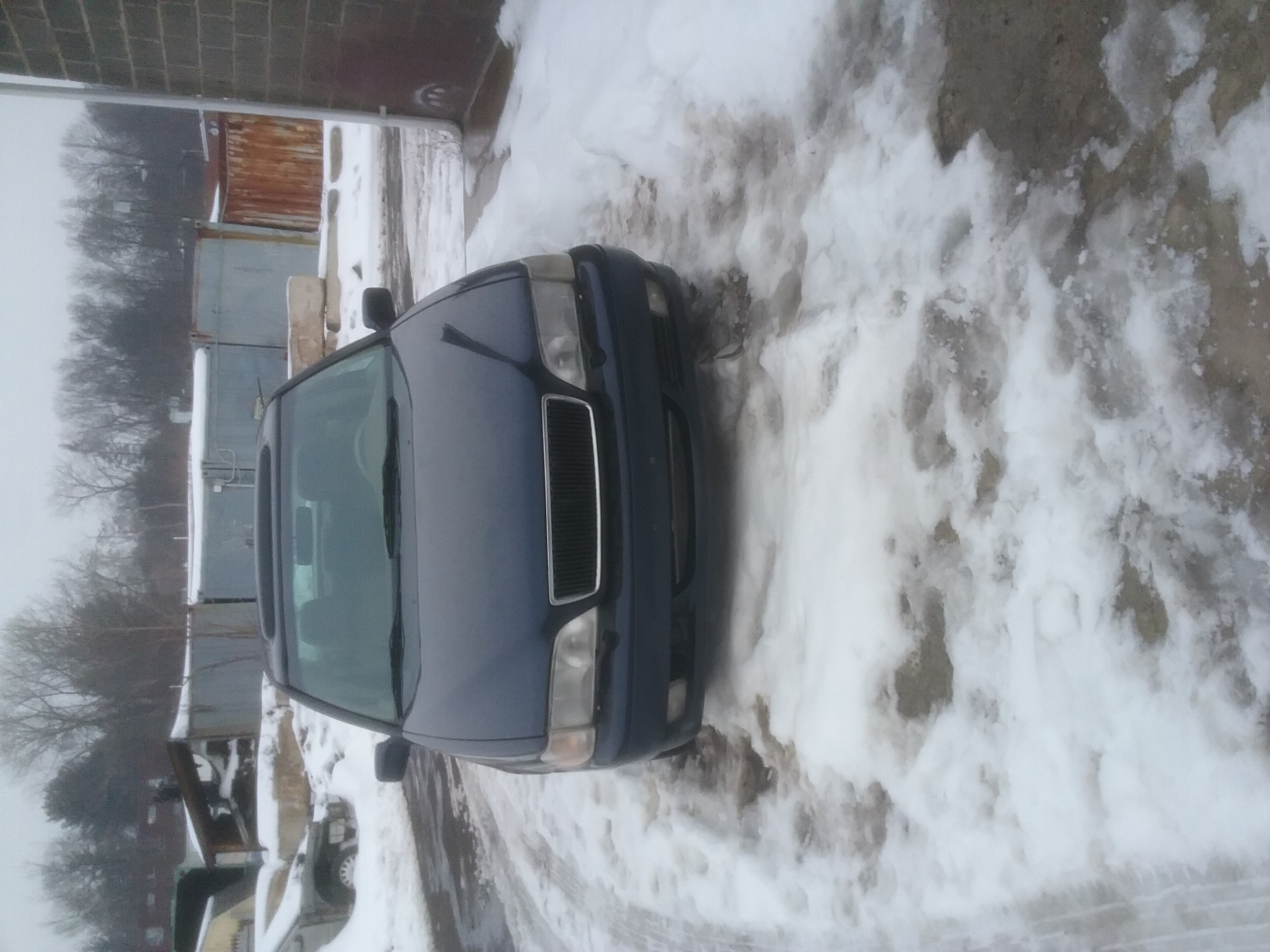

Saved a '98 S70 with 78k on it from being scrapped for $400 last year (ate a timing belt) My son has been driving it for a year with no problems. He got a set of Dynaudios for Christmas and we are in the process of adding the C70 amp to run them. Over the past year I have picked up bits and pieces required for the full system. SC-901, center speaker, Dolby processor, dash pad with center speaker hole. Hopefully by next weekend we will have everything in!
