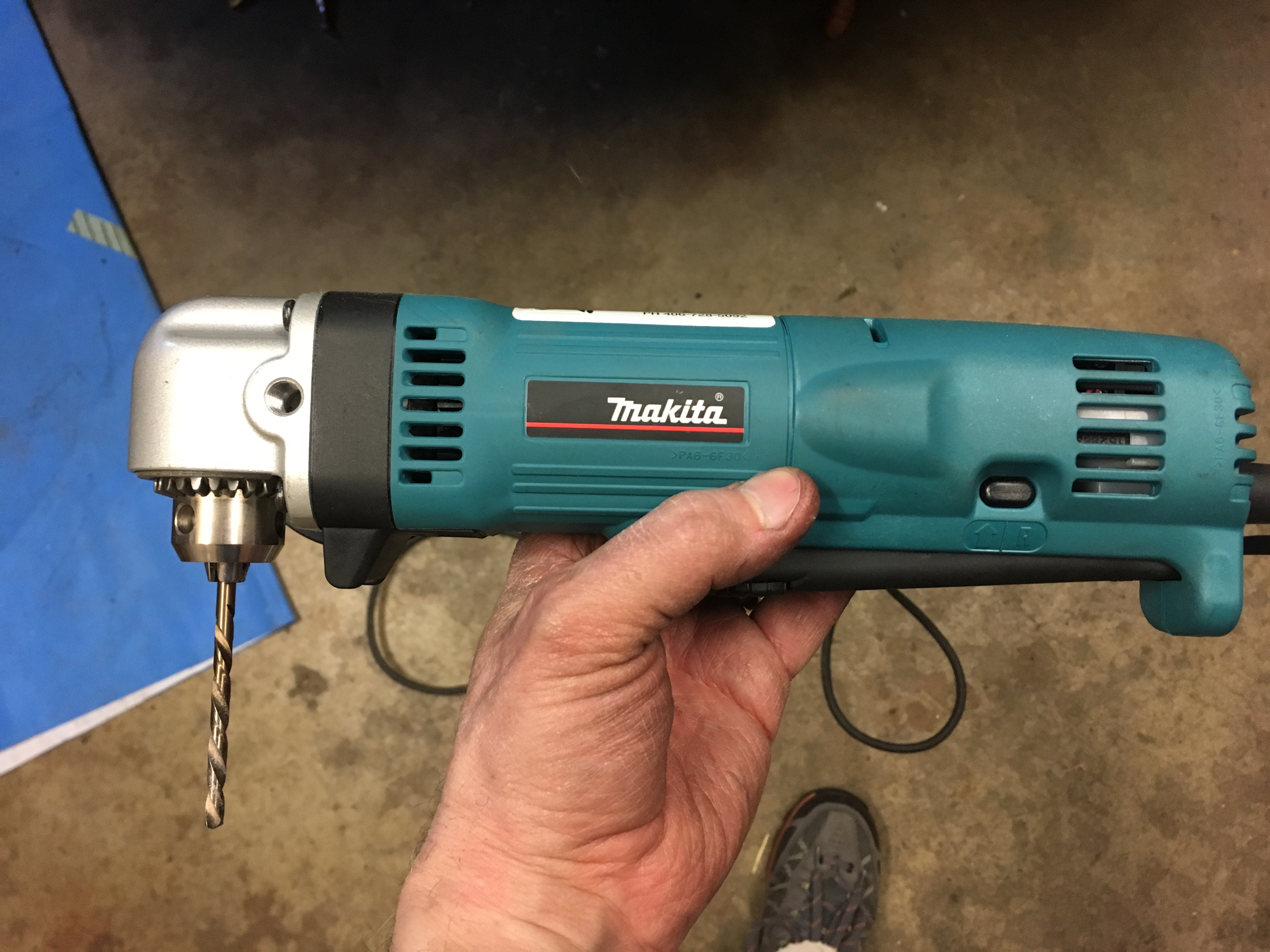

BlackBart wrote: 26 Mar 2018, 00:18 It finally warmed up here and I got some time to work on this. Didn't go as planned.
I seem to be in the same situation prwood found himself.
Bought a nice, sharp, expensive, left-hand Fastenal bit.
Rented a nice short Makita 90º drill.

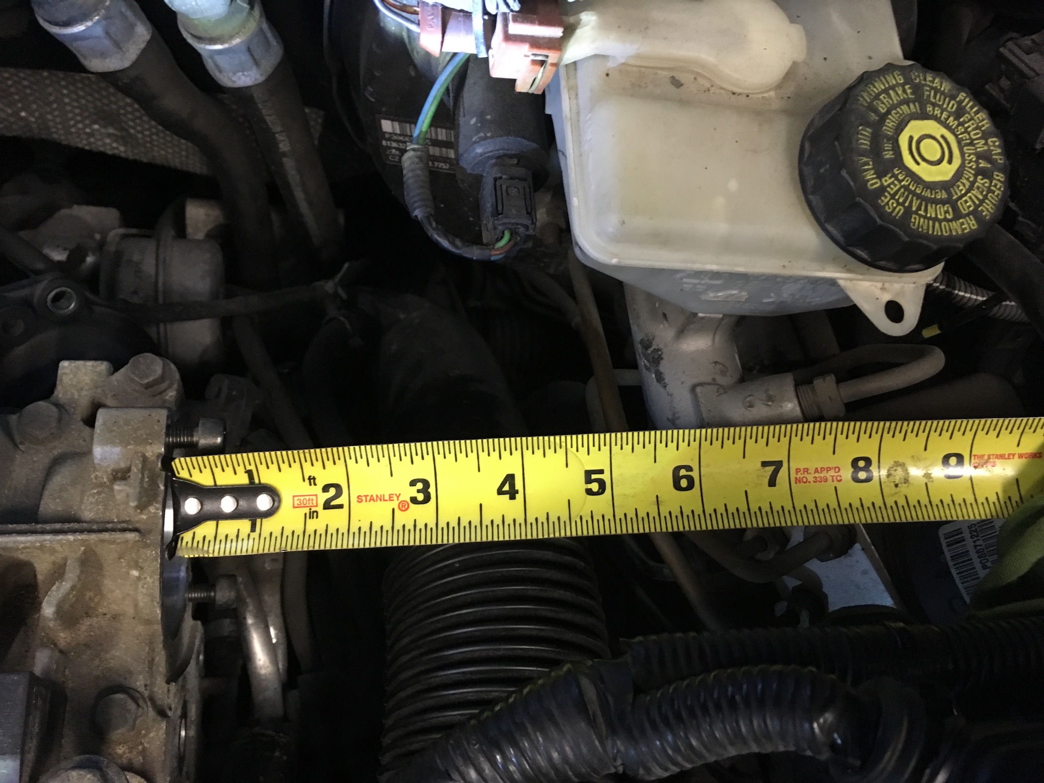

There is really no room to get a punch and a hammer in there, and then it would be blind anyway. I could only see down into the camshaft with a mirror and a bright light.
There seemed to be a divot close to the center of the broken bolt so I drilled very slowly, only a few turns at a time.
Mirror / light / measure / check / drill a bit.
When it got off-center, I attempted to steer the bit towards the center some - you know how well that works.
The end result was it cut really easily through the soft metal, but it wouldn't stay centered. I turned it slowly starting and stopping to get it to catch and back out - nothing.
It gave way so I assume it went all the way through the 20mm of bolt end...
BUT.. it's not centered and I assume I chewed the threads in the hole. Swore some, put the tools away, went in.

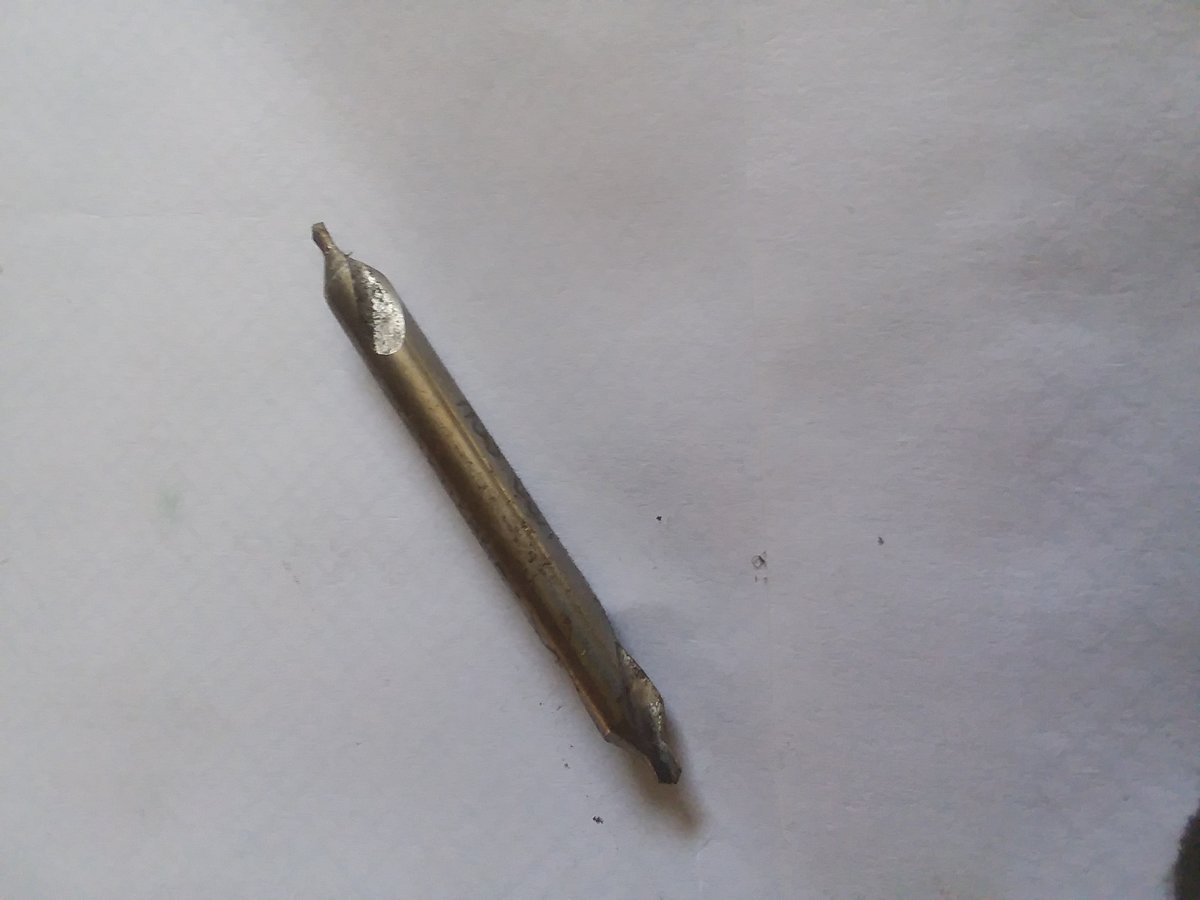

Erie Volvo, but you can save this situation.
Make a bushing to fit in the end of the alum cam cover, with a hole for the drill, that will keep the drill from wandering around.
You can make it from wood.
With access you can punch it and preferably start with a center drill to create a proper divet the reverse bit will not jump.
You can still do this without pulling the head...or cam cover as its called.
If you misdrilled right through the alum to the oil galley you can seal it with some jbweld.
Here's a pic of a centering bit, it cuts toward the center of the shank, only go deep enough to make a divet. If you go deeper the tip will snap off.
1/4 shank centering bit.

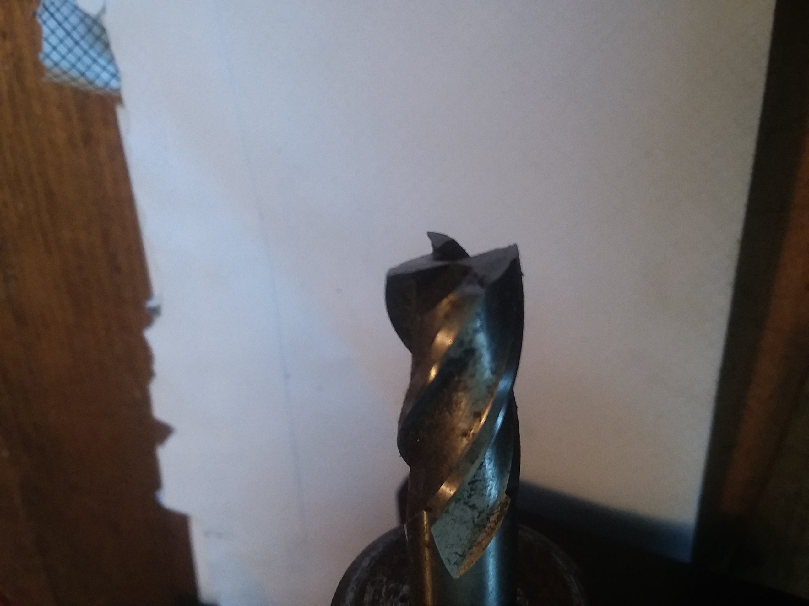

If you didn't wander into the alum and did actually bore an offcenter hole through the bolt ?
I wouldn't start with larger bits because they will follow the hole...offcenter again.
A 4 flute end cutting mill bit will correct the hole.
Slightly larger than the pilot hole you already have. Again, you have to use a bushing to keep it going straight . Once centered switch back to drill bits. You can get mill bits from sherline.com make sure the shank is long enough to reach the bolt . doh.
You can try with just drill bits too, I would want the best odds.
Here's one of my mill bits, 4 flute.
If this happens you are truly well fubarred, as now you have a hardened tool steel invader stuck in your cam, and nothing short of electric discharge machining will burn it out.

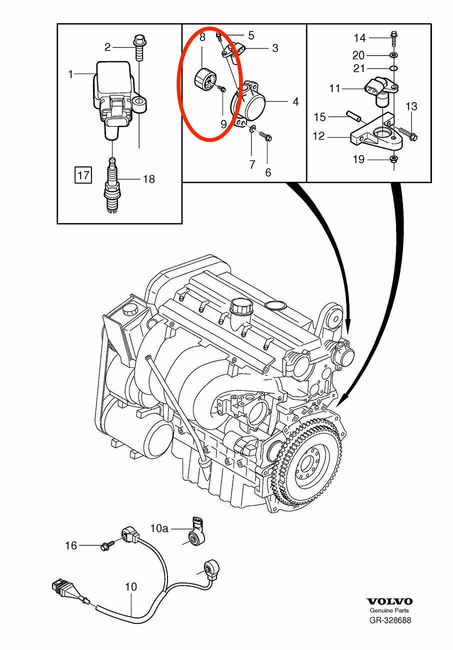

The threads on the back end of the exhaust camshaft on this model are needed for the bolt on the camshaft position sensor aperture to thread into. Note that this threw me off when I was looking into parts, but the camshaft position sensor, although it bolts onto a camshaft on the cylinder head, is considered part of the ignition system, not the cylinder head:
Volvo Parts Ignition System Diagram
If you didn't install it, the ECM wouldn't know what position the camshaft was in, and I'm not sure what horrors that would create. :-) Maybe it would have some default fail-safe behavior, but I'd rather not chance it.

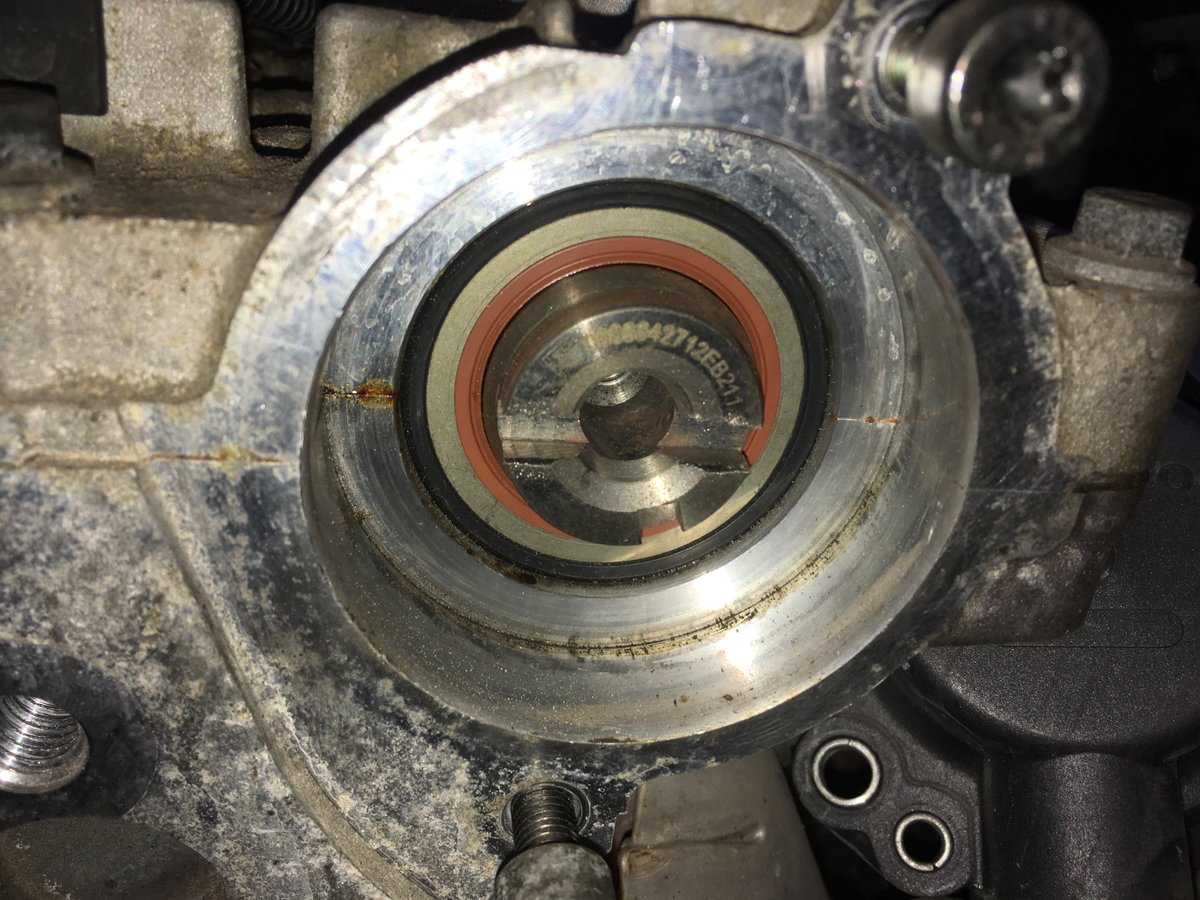

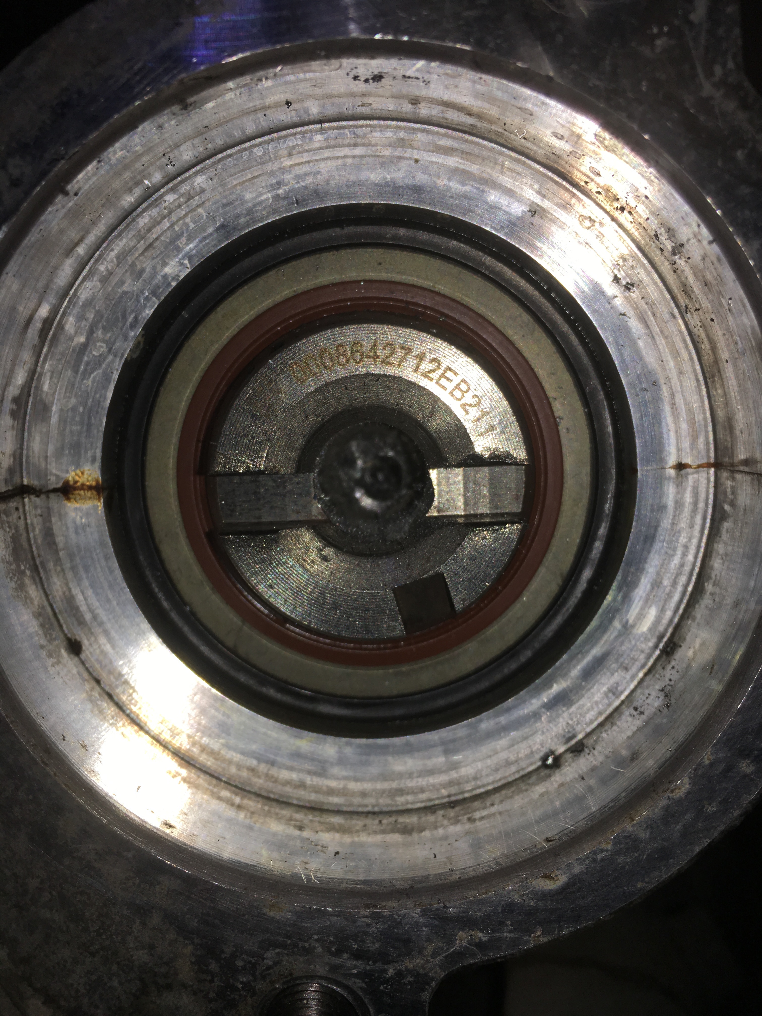

I don't understand "drilling through the aluminum into the oil gallery." I went through the broken stud length, where the hole seems to be tapering smaller. Is the cam hollow? Is there oil pressure in the center? I'm confused there.
abscate - "Wander into the aluminum?" I'm assuming a cam is hardened steel..?
I don't have a pilot hole, I have an 11/64 hole off-center in a 7mm threaded shaft, which means I'm very likely into the threads. I can see trying all those things in a machine shop maybe.
The broken bolt end seems to be very soft steel. The bit is very sharp. It just never grabbed to back the bolt out.
My exhaust cam is marked #0008642712EB211

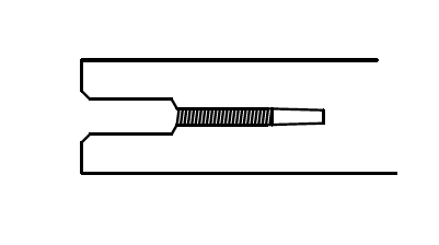

Scale section through the end of the cam -
Camshaft section.jpg (11.37 KiB) Viewed 2065 times
Attempt to shoot down the shaft with a phone.

In lieu of successfully removing the leftovers of this bolt and cleaning up the threads, or finding a reasonably priced replacement camshaft, I suppose a machine shop could drill the hole out to M8, then use an M8 bolt for the tool and the tone ring.
Seems like a question of how much work and how many machining hours we're talking about. My $30 seal replacement is escalating quickly. I don't see how a machine shop could beat prwood's $40 camshaft, even with shipping. The little stuff I've taken there cost me a bundle.

I'd go with abscate suggestion at this point.
A larger bit, then a bolt extractor.
It should come out.
Jobber drill bit set is good enough, once you have a hole you don't need carbide bits....
It will enlarge easily, that hole doesn't look so far off center, I've extracted similar looking set ups.
