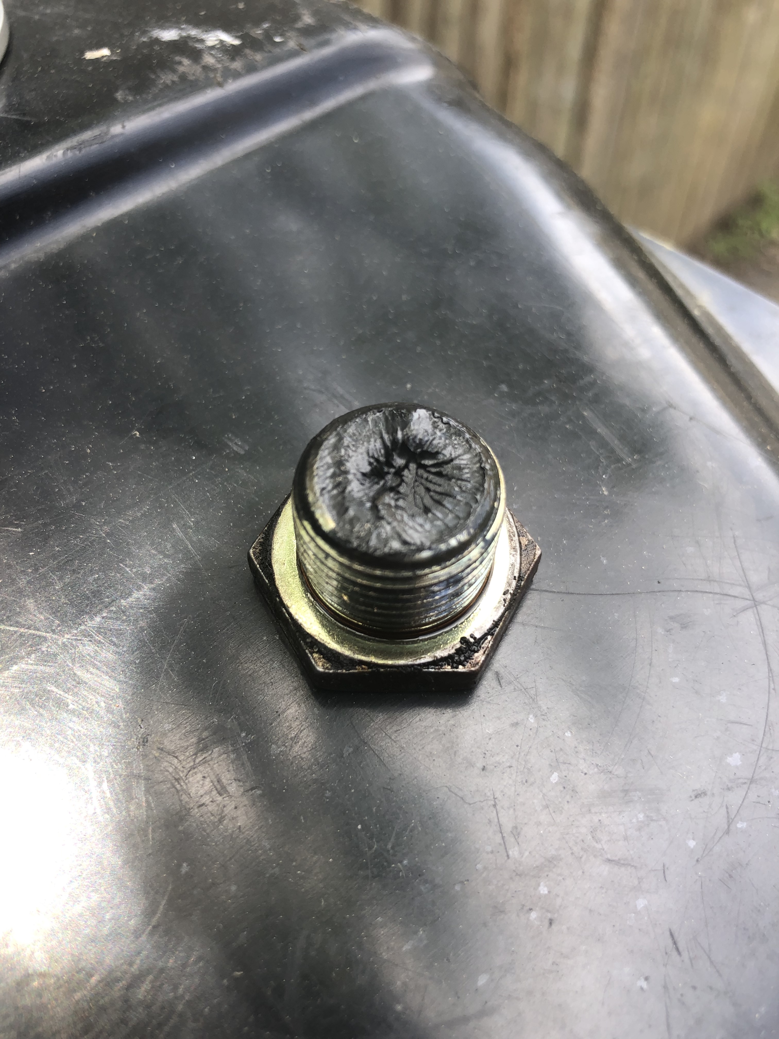

Alright, so over the weekend I did my first transmission drain and fill. My 10yo helped with adding the new fluid - the 'transmission funnel' I bought wouldn't fit into the dipstick tube, so I had her hold the new container while I used a fluid pump to get the new fluid in (the tube for this pump just barely fit into the dipstick tube).
We drained 4 quarts of old fluid and replaced with 4 quarts of Idemitsu Type TLS ATF, which Advance says "doesn't fit" my 2001 Volvo V70, but I'm fairly certain I have read it is acceptable: https://shop.advanceautoparts.com/p/ide ... 11872369-P
The old fluid was smooth and dark brown/black. No chunks as far as I could tell. The magnetic drain plug had accumulated a layer of crud:
After the change I ran through some city and highway driving, with shifts at various throttle positions. I was able to take a hot reading of the fluid level at this point, and it measured solidly at the top of the hot range.
Shifting and torque conversion seemed good, a bit better than previous, though I did get the "thud" every once in a while. Maybe it still could be an engine mount issue. Although I feel that my mounts are mostly okay, I have noticed that there's a lot of disagreement on this forum as to whether the amount of movement in my top mount is excessive, so I may try out the suggestion from earlier in the thread to stick an extra piece of rubber in it and see if the "thud" is diminished. I'm trying to decide whether it's worth it to chase it down any further, or just live with it.

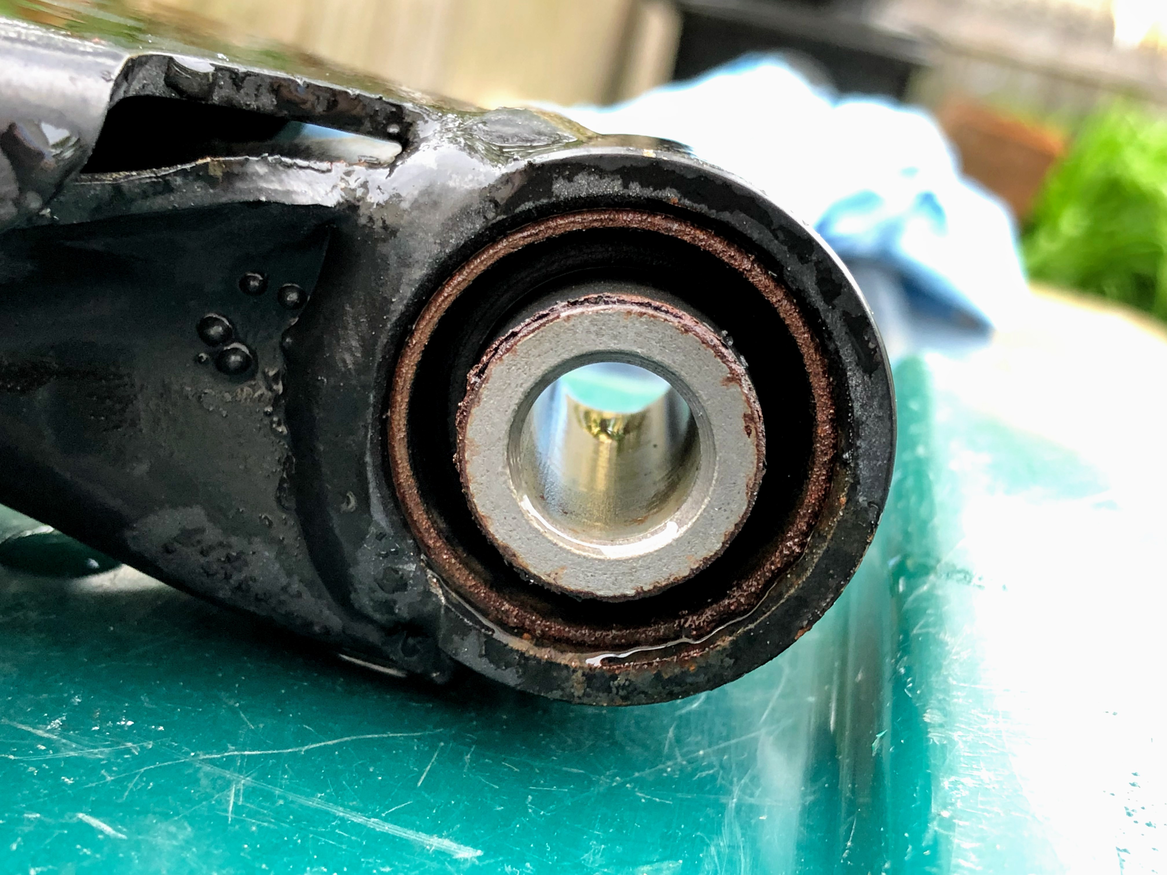

Update: Last night, I did the following:
- Reset the ATF fluid counter using VIDA.
- Removed and disassembled engine stabilizer mount and bushings, cleaned, and reinstalled with all bolts torqued to spec.
- Inserted chunks of rubber hose into gaps around top engine mount bushing. This reduced movement of the bushing significantly.
I took a few test drives, and the thud is still occurring. I suppose the transmission could need more time to adapt after the fluid change and counter reset.

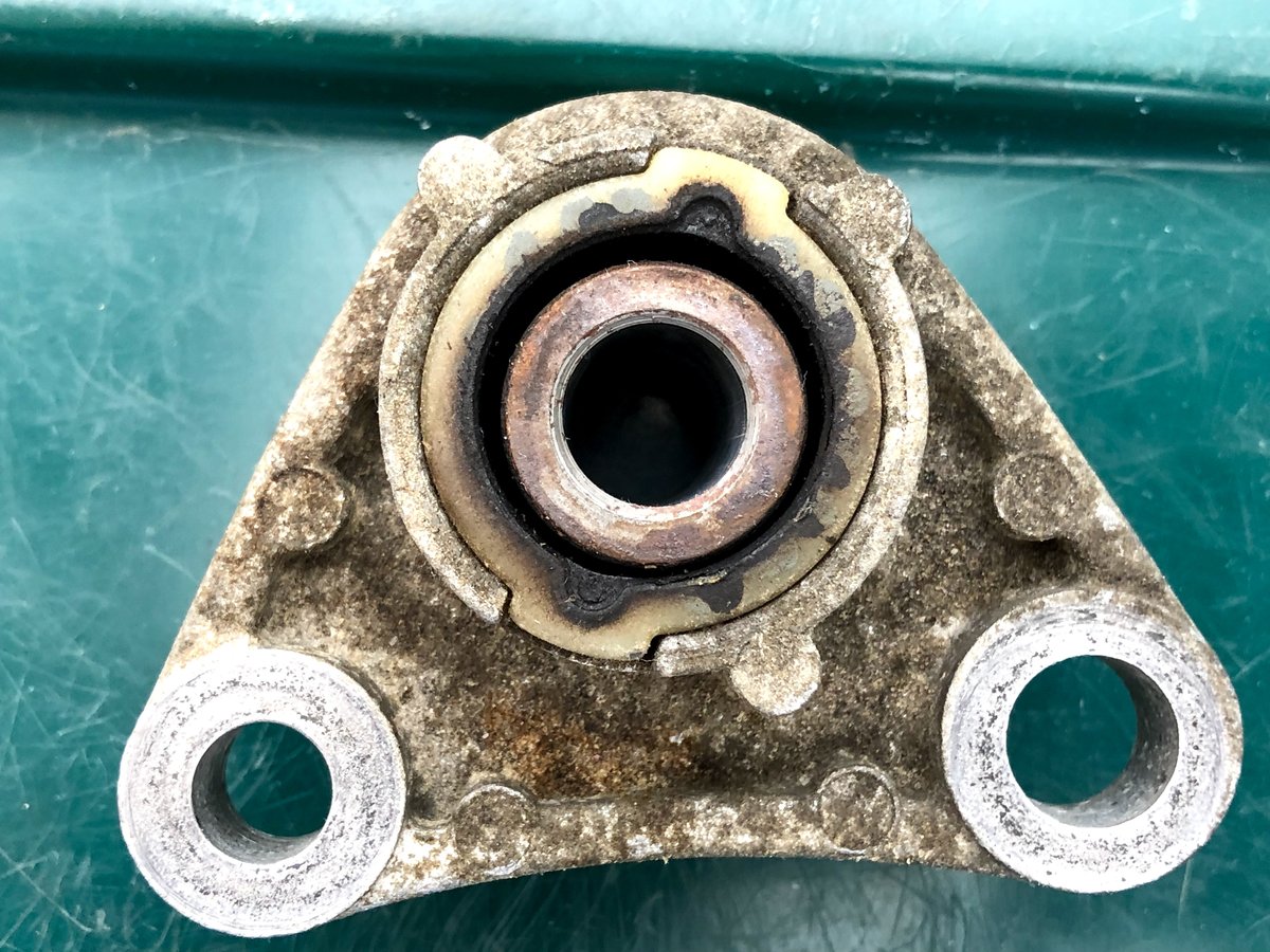

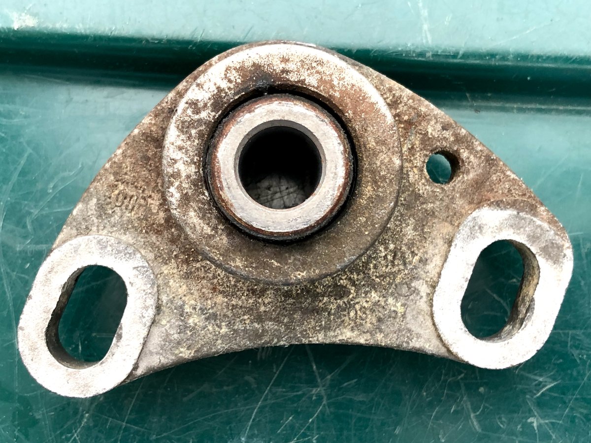

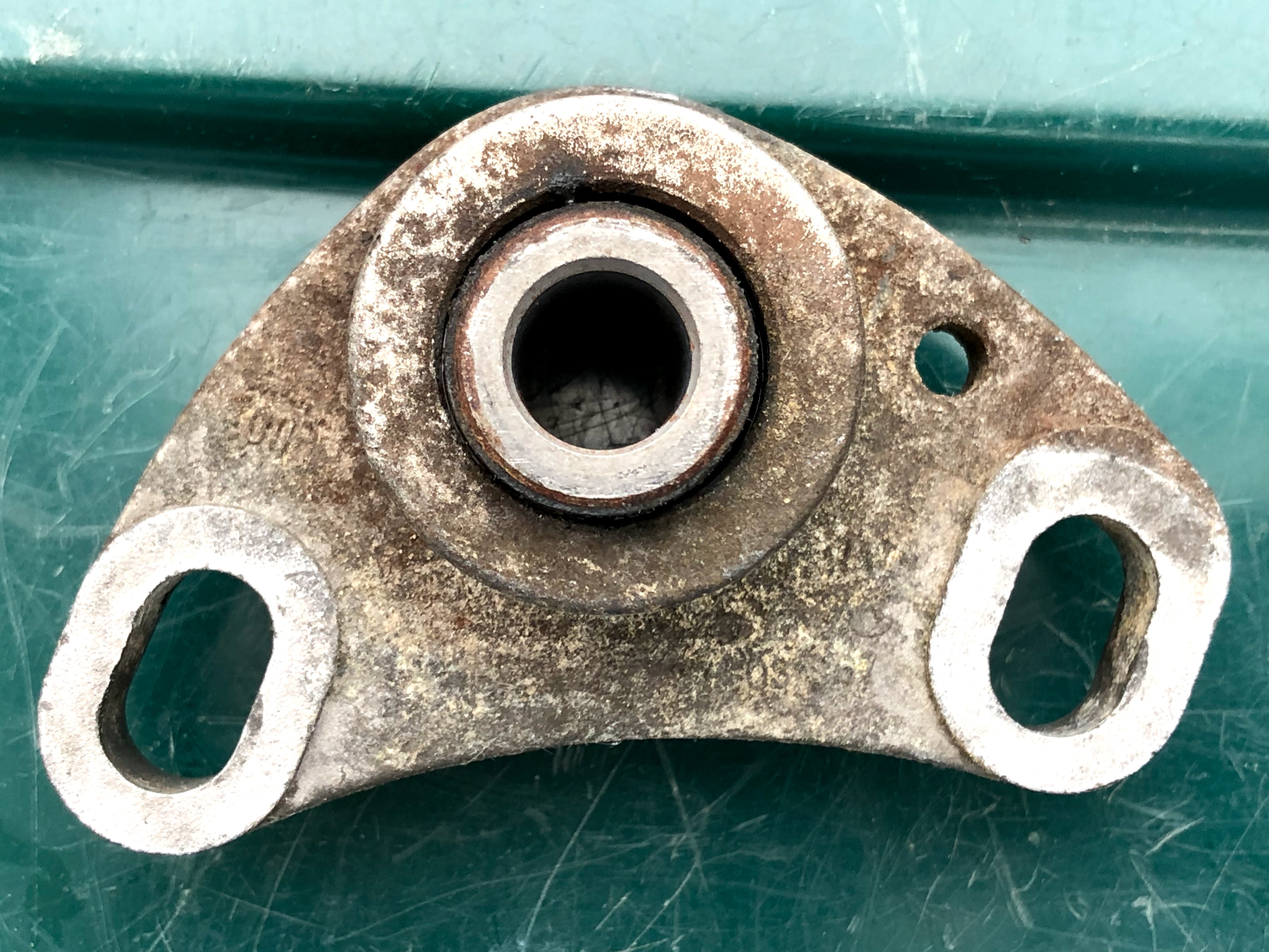

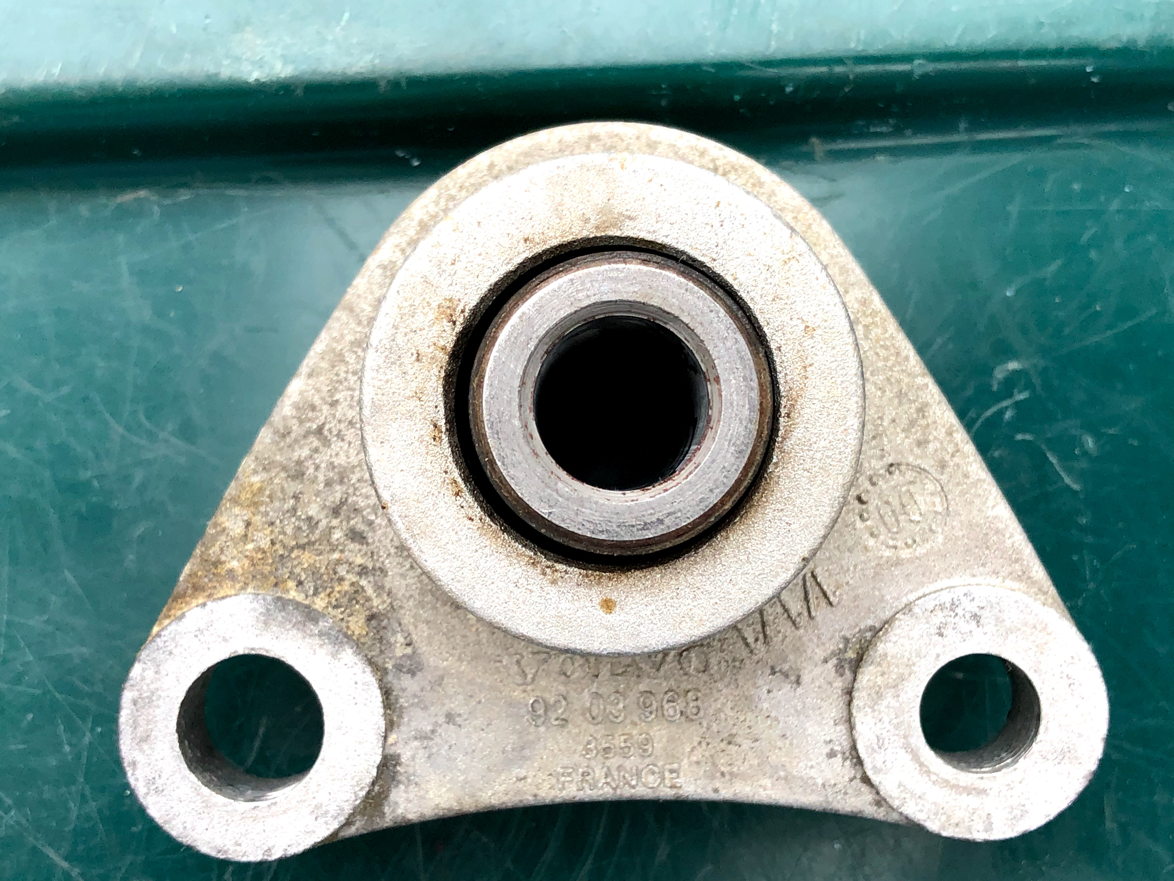

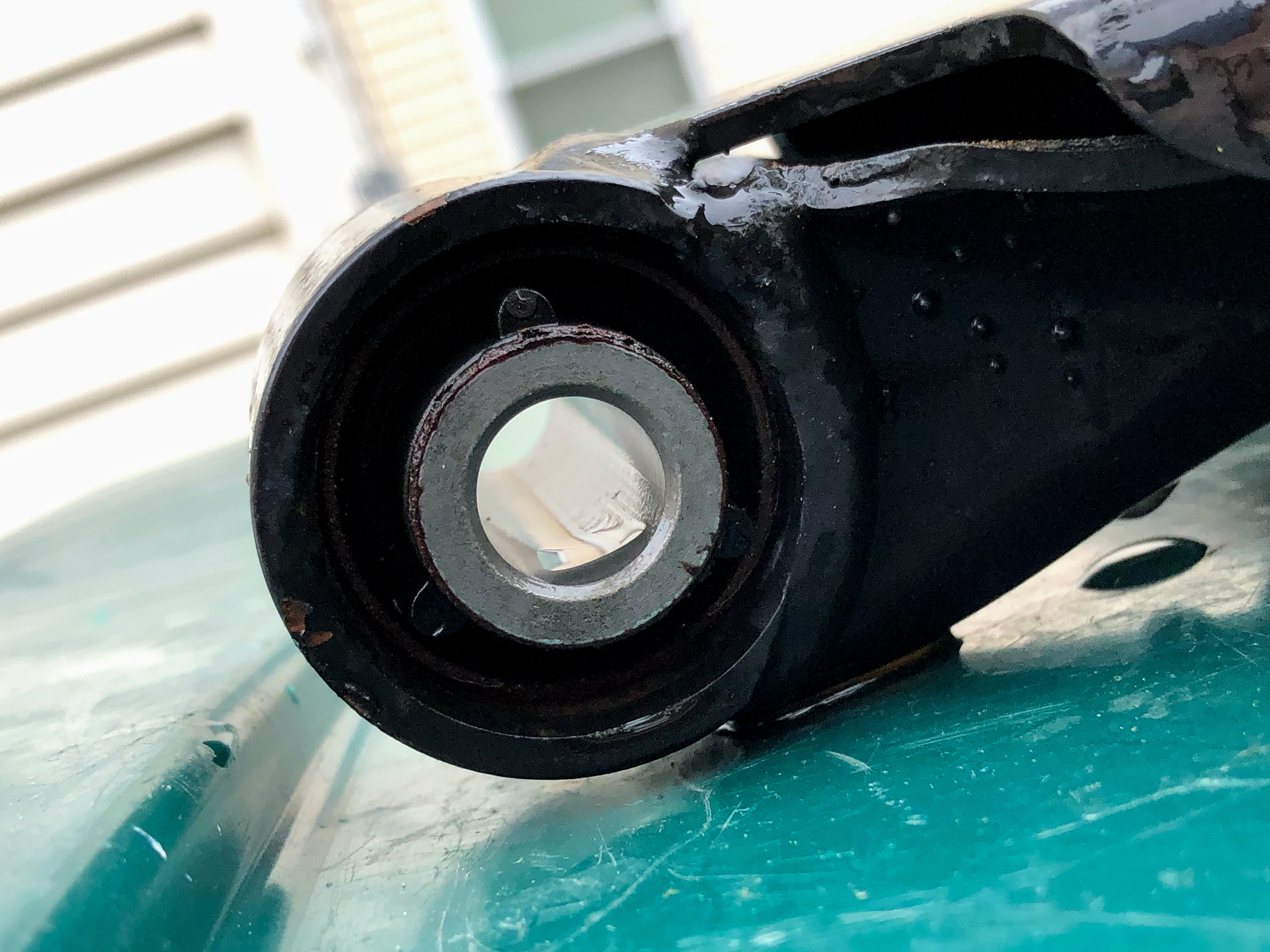

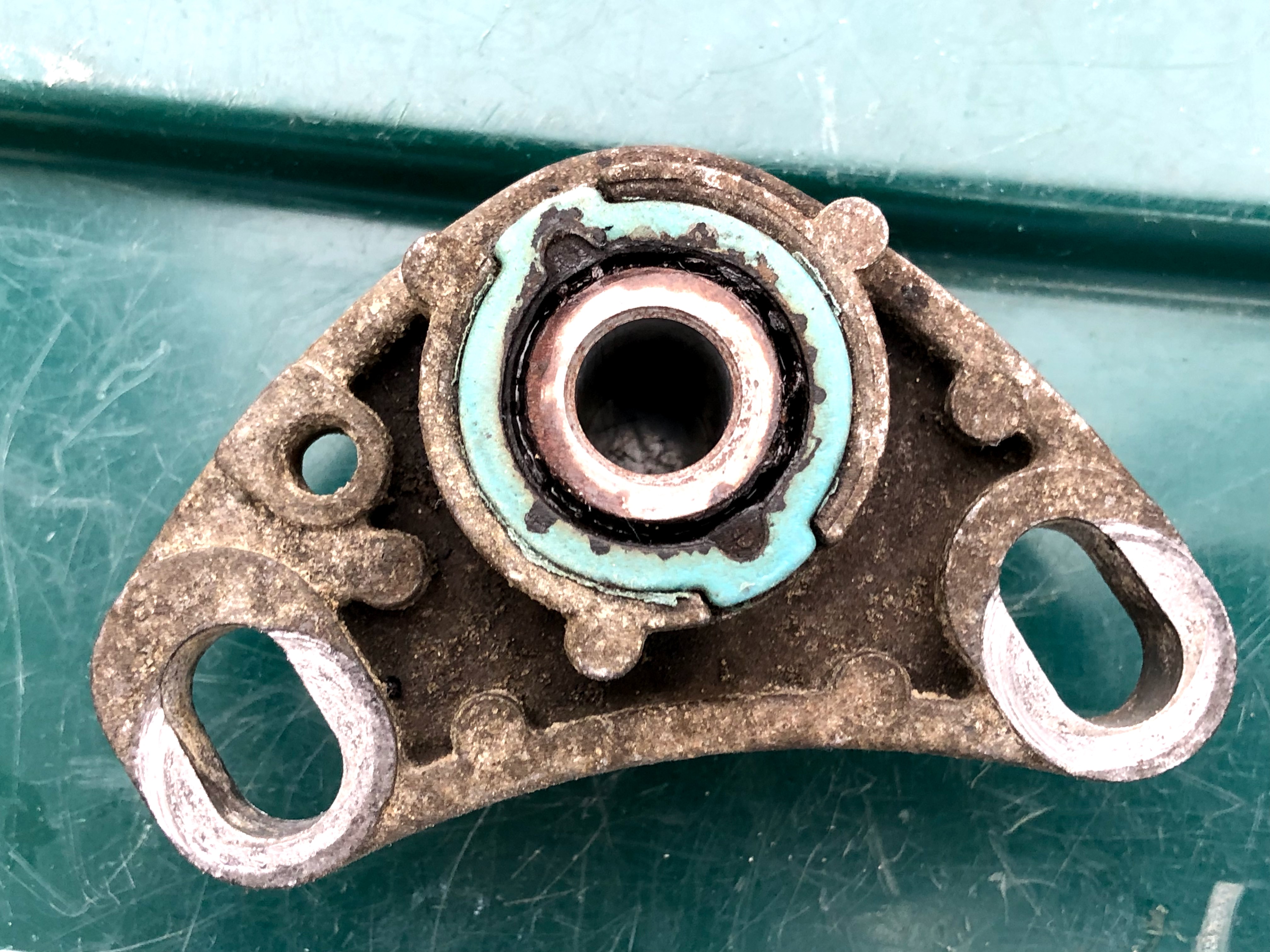

The one thing I haven't done yet, which a couple of people in this thread have mentioned, is replaced the stabilizer bar bushings. Here is how they currently look after being cleaned:
It looks like I could get new OE mounts from FCP for $17 each. iPD has the previously-mentioned polyurethane stabilizer bushing insert kit for $11, an aftermarket set of the complete mounts for $30, or $50 for a solid aluminum set of mounts to make the bar completely rigid.
I'm sort of getting to the point where I may not chase this down any further, because the problem doesn't honestly impact drivability in any way, it's just annoying.
