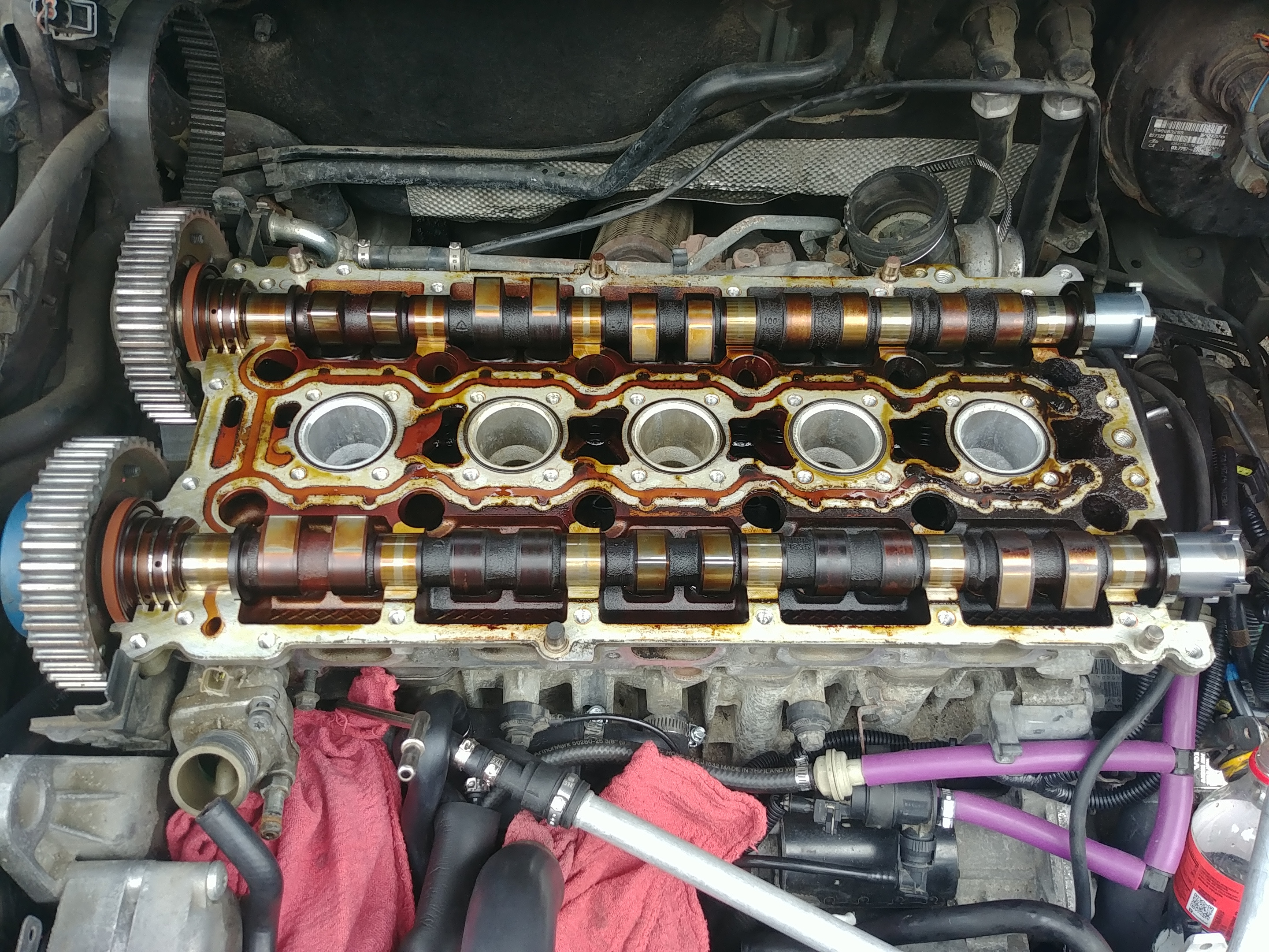

Making progress. A lot of gunk in here. And there's oil puddles up inside there. Is there suppose to be that much oil just chillin?
I believe all I have left are the head bolts.
I used the smallest wrench ever for that bottom bolt on the water line

TyRawr wrote: 30 Jun 2020, 11:32 Making progress. A lot of gunk in here. And there's oil puddles up inside there. Is there suppose to be that much oil just chillin?
It looks like some of those cam lobes don't contact the valve lifters.
cyl's 2 and 4 on the intake cam.

How can you tell?

heavy oil tarnish on 2 and 4 intake cyl cam lobes.
the valve springs keep the lifters in contact with the lobes but some of yours loo like disused railroad tracks, tarnished.

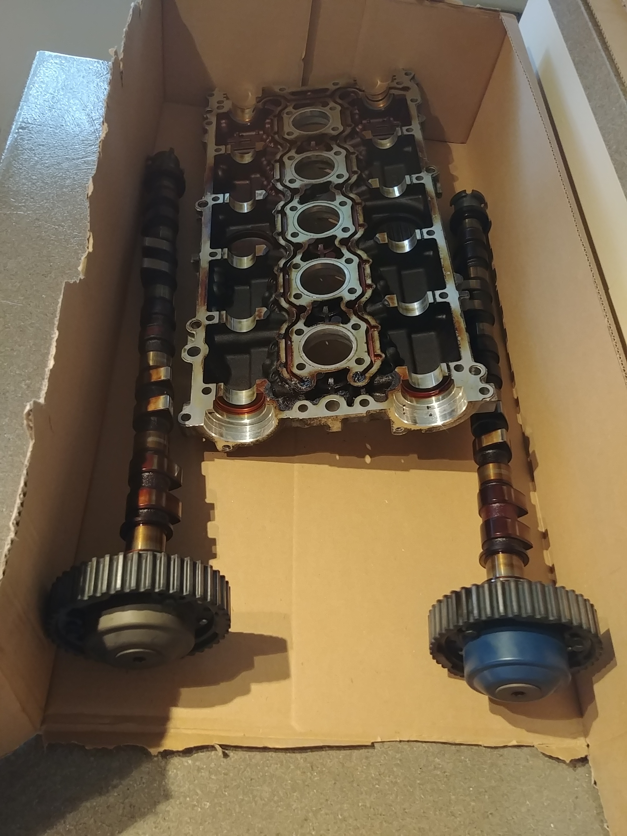

Do you have a plan ? ...like wrap the cams in old towels to protect them?
...and take the head to a machine shop, that would be a decent plan.
Either way, protect the camshafts from banging against the head and each other. Putting all three parts in a big cardboard box is a sure way to damage something if they roll around.
I would not start cleaning parts until a pair of experienced eyes have looked at it, they can tell what is wrong by the evidence.
