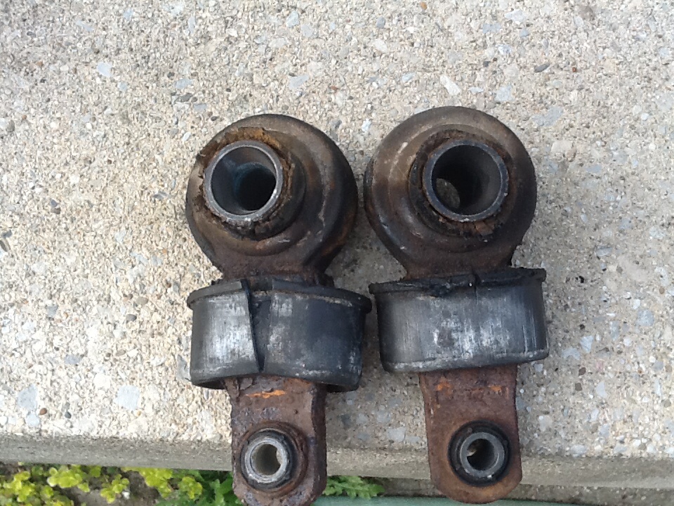

I had discovered problem with the stud where acorn nut threads while working on replacing rear shocks winter 2012, here is a photo...
...more here https://www.matthewsvolvosite.com/forums/viewtopic.php?f=1&t=31410.
Lee/cn90 hinted, there may be complication, stud breaking off the suspension if I undo the acorn nut, so I ask:
Would working at upper mount, inside the trunk an option for "undo the lower shock absorber mounting"?

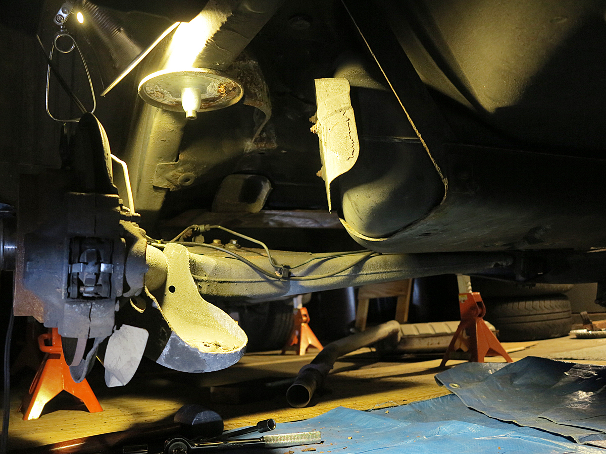

The muffler project is opportune time to get rear suspension overhauled with OE/OEM - spring, delta, transverse arm anchor mount, flexible brake hose, restoration of rusted surfaces. Bilstein was replaced 18 months old.
Here are few photos.

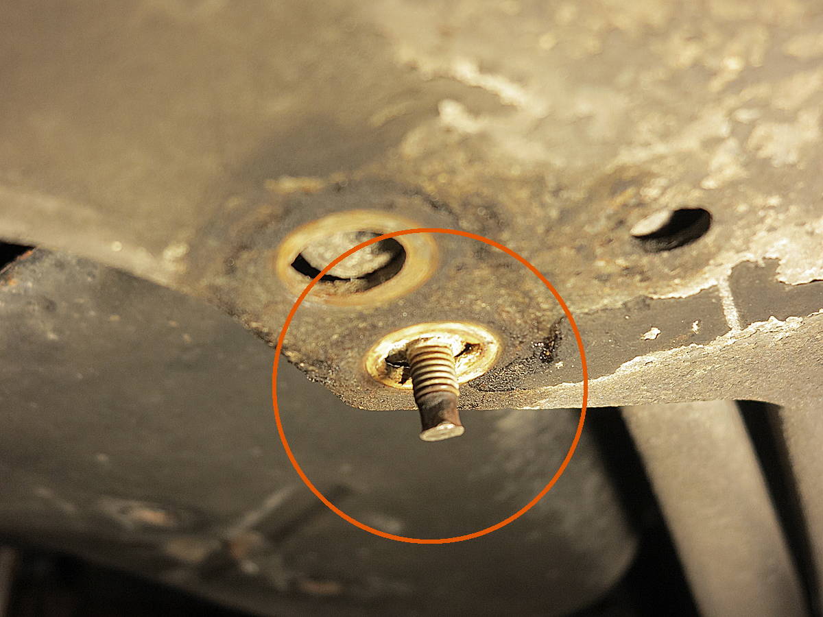

The picture with screw is of driver side transverse arm anchor mount at passenger side delta. The two nuts came off fine, but one screw is coated with white cement like stuff which fills the tube of anchor mount. All efforts has failed in last several hours. Any suggestion?
Picture with arrows: screws and nuts are off but i can't pull or pry out the anti-roll bar.
Driver's side rear - spring and shock removed - broken exhaust lay on ground
stubborn anchor mount screw - surround with white glue
