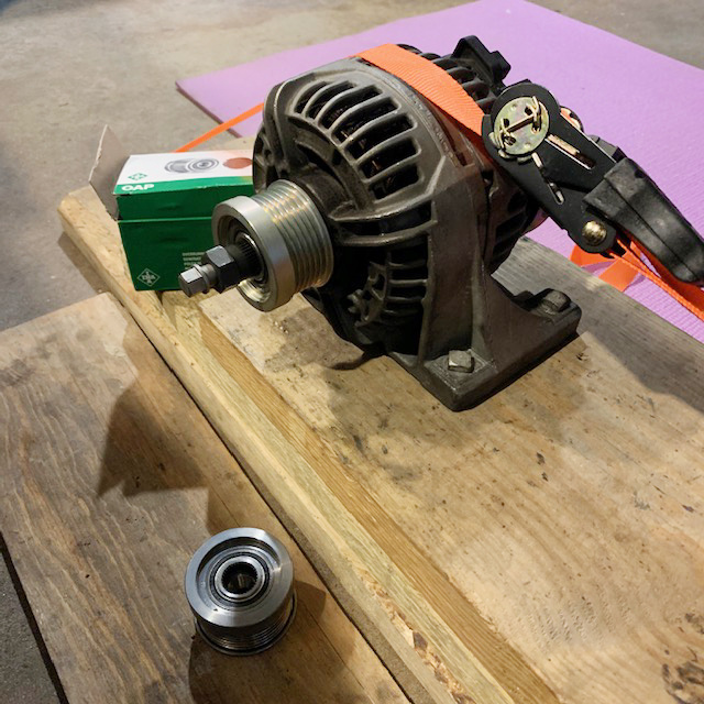

Often drop in engine speed resulted in power generation symptoms including drop in voltage, flickering dash, headlights, engine cut-off etc. So, read through the OAP related discussions, and decided to service the pulley before next step, i.e. ETM.
I installed this Bosch 140 A rebuild generator in 2014. It has 60,000 miles on it, but the pulley doesn't freewheel anymore. Replaced the pulley with a new INA OAP. A drive cycle is coming later today.

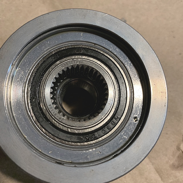

Amazing improvement after the alternator OAP service. Reversing out of the inclined driveway is way more responsive, and lots of power -- awful bearing noise is absent. It use to give up reversing on a pile of ice. Driving this winter with snow on the ground will be way more joyful.
The following OAP (not INA) failed more than two years ago. Be prepare to replace it if your's have 30,000 miles on OAP.

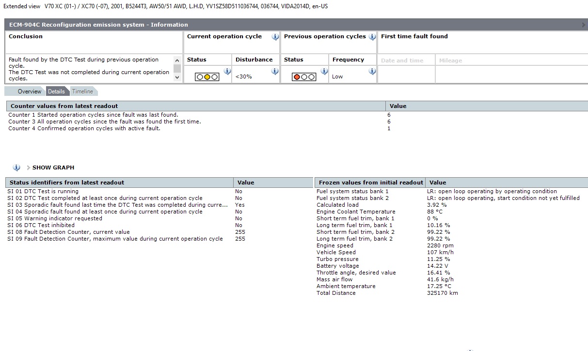

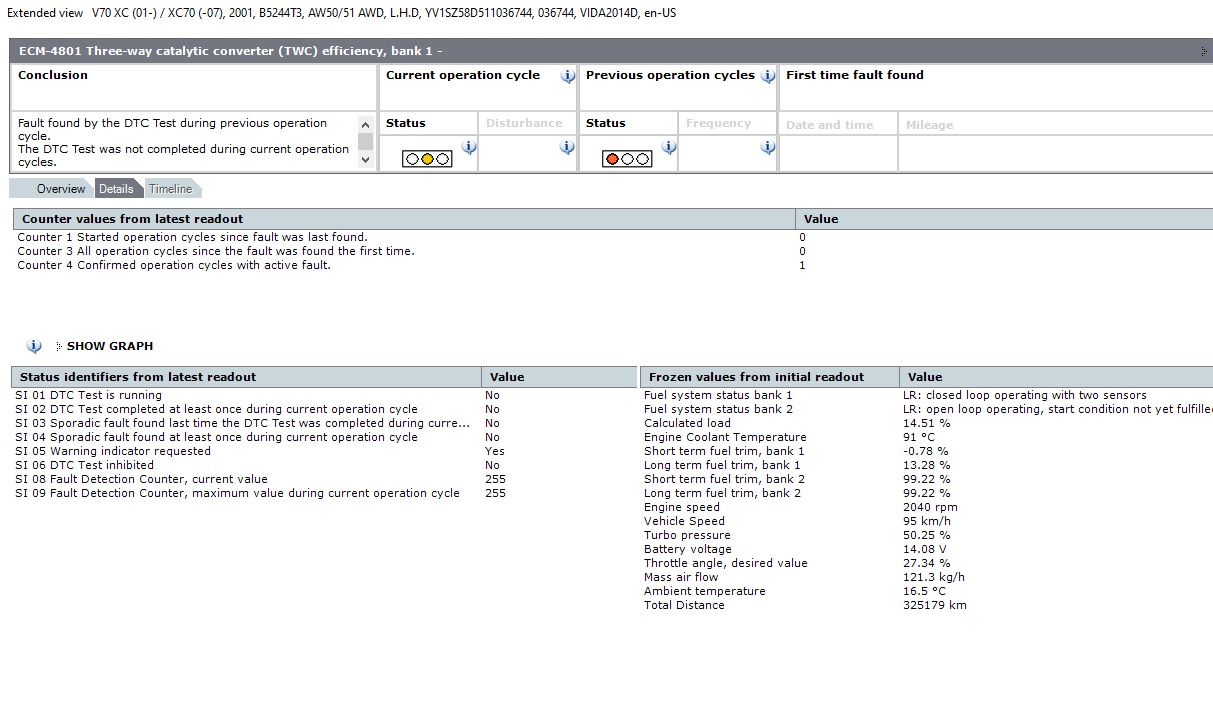

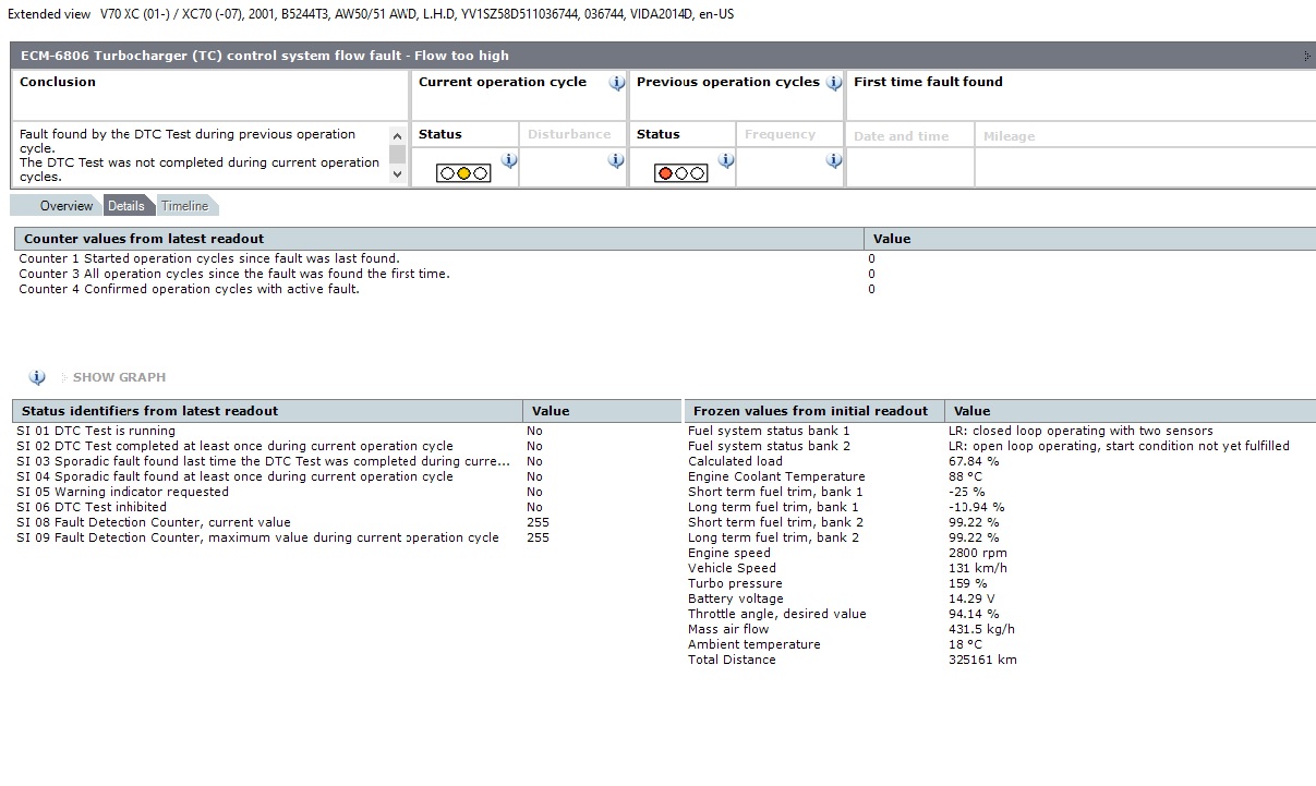

Unless you say otherwise, I am leaning TB is failing.
Three ECM freeze frames in the order of mileage when stored:
ECM-6806
ECM-904C
ECM-4801

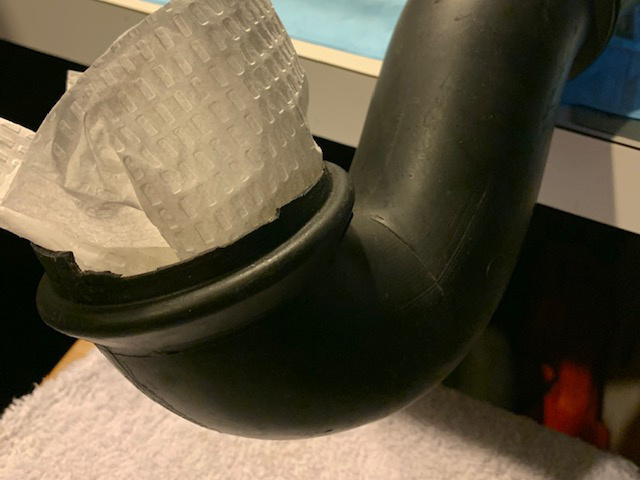

abscate wrote: 08 Sep 2020, 10:29
Intercooler to ETM pipe
Crumbling at the ETM connection. Replacing this pipe will complete this service of end-to-end replacement of intake pipes and hoses. Ending with installing XeMODeX throttle body next.

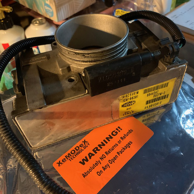

vtl wrote: 24 Oct 2020, 07:39 Hopefully new/improved ETM will do it. There's a reason why Volvo walked away from Magneti Marelli.
Installed the XeMODeX. The air intake is now refreshed from the air inlet to intercooler-ETM pipe.
The MAF is new too, but I may have to clean/replace the MAF, other then that the drive this morning was Ah-ha!
The two departing MM 0-130,000 miles white label, and 130,000-202,110 miles yellow label.
