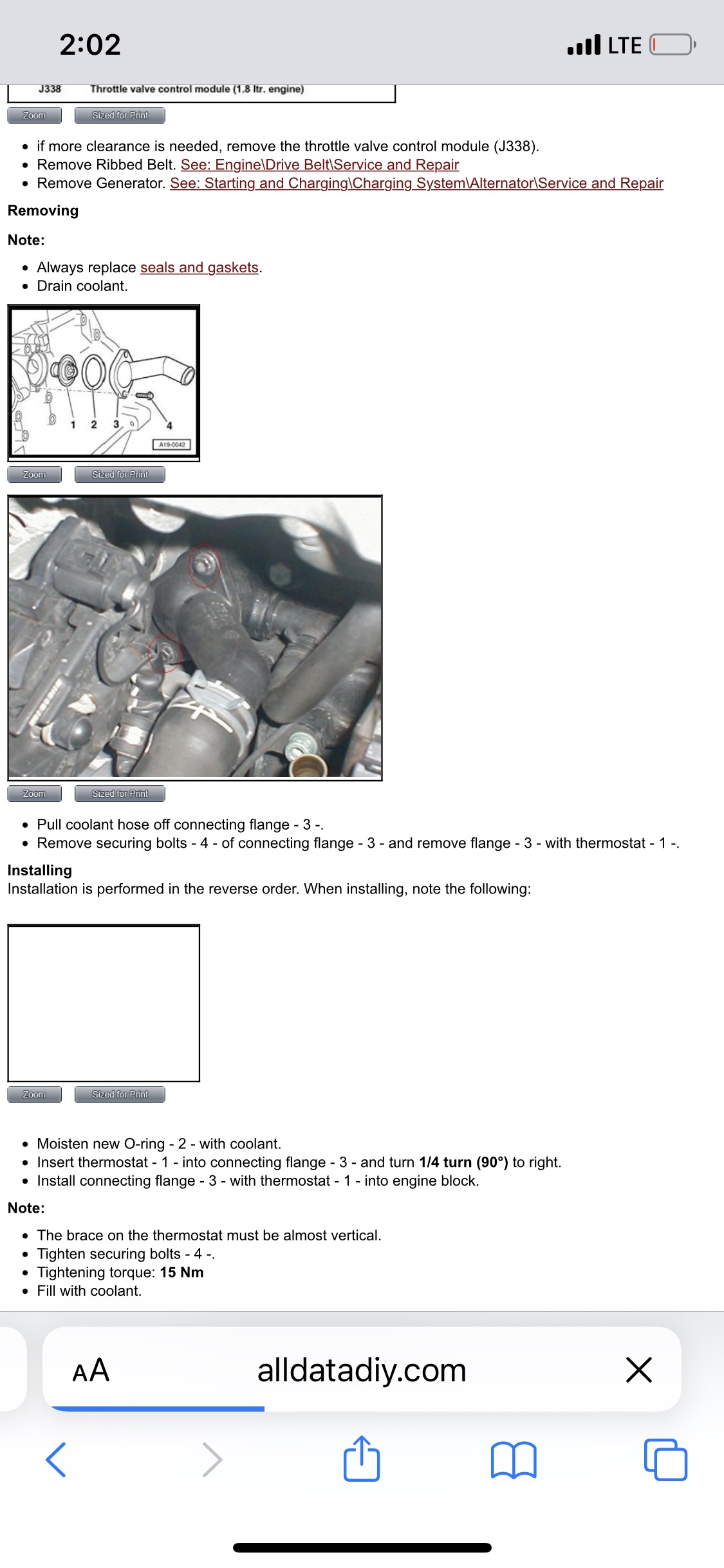

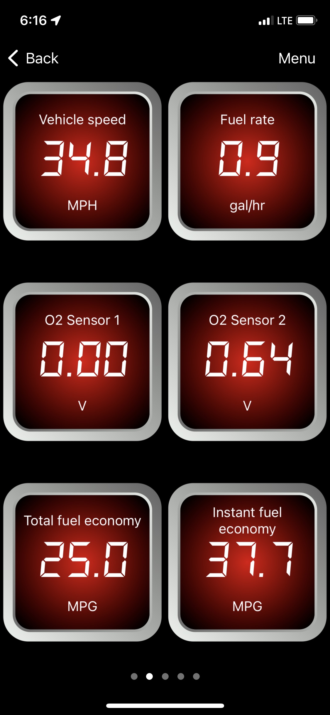

Off Volvo topic. Replaced thermostat on the ManBeetle. Juliette was running cold, about 140F. Mileage was sucky at 25-27 mpg highway. Got parts from FCP dropped coolant.
Thankfully didn’t have to remove alternator, just unbolt it and move it starboard. The Beetle engine room is really tight. Alldata instructions suck on this one, too, lots of wrong stuff
Coolant was horrible rust colour, luckily at had 3 liters of pink at hand.
Loaded her up and no leaks, but no heat. Took her for a spin , temp now 200F and heat poured out. Mileage will be confirmed o a trip to Caitlin tomorrow

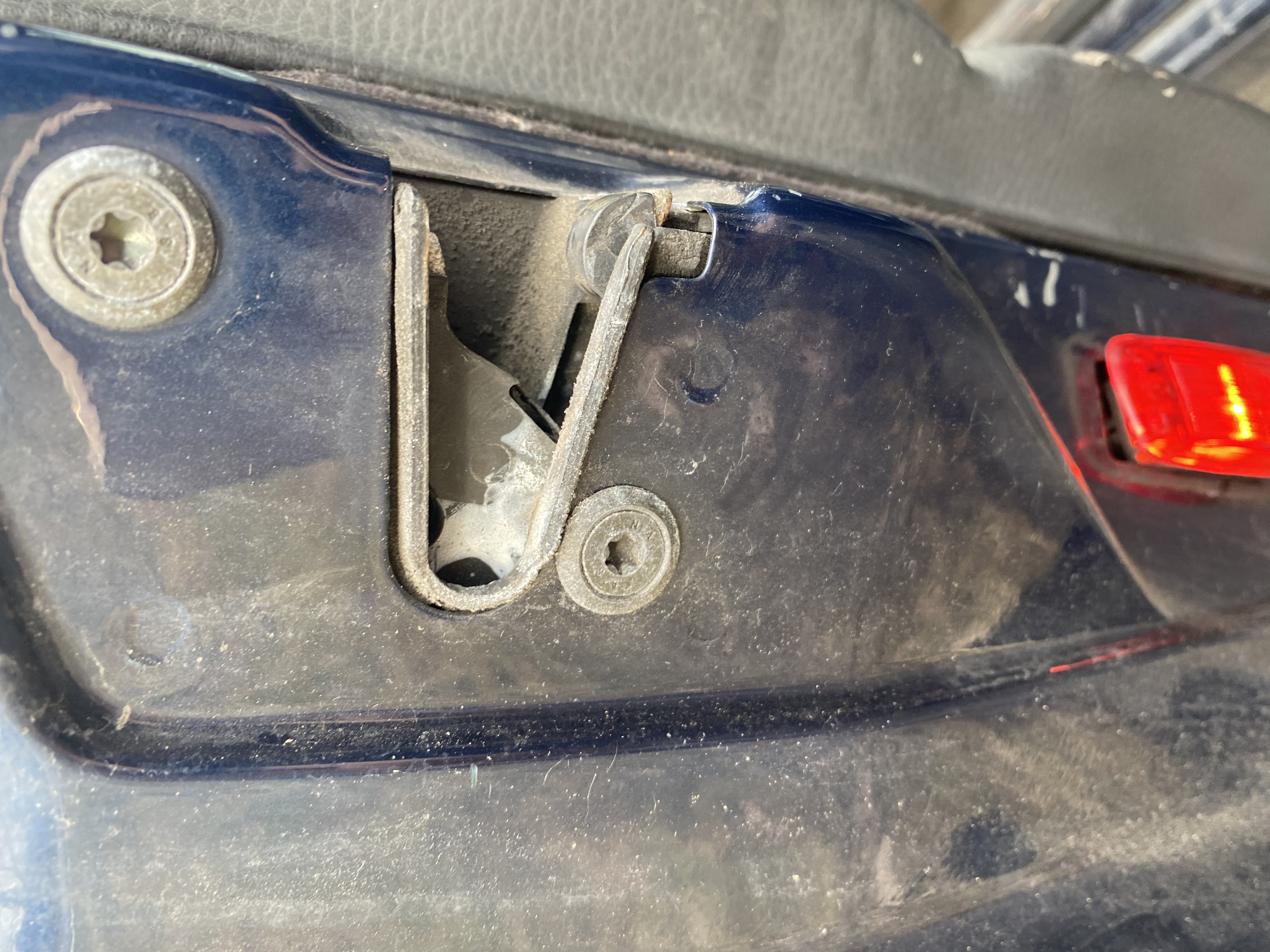

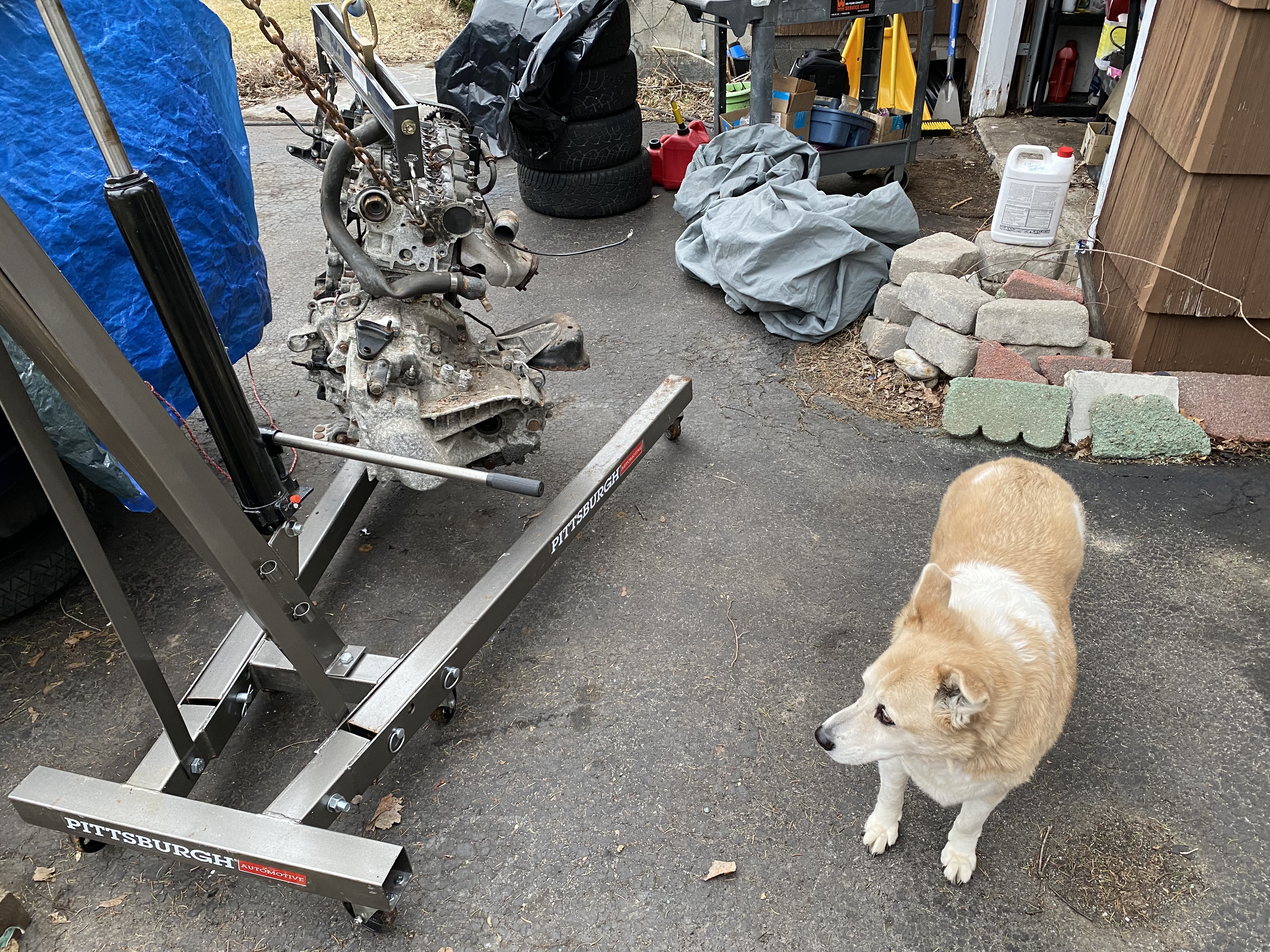

Light Volvo day.
Fixed door marker light.
Fixed w/s washer nozzle
Aligned door rubber dampers
Yanked engine m56
Lubed door latch
Yanked engine m56
Lubed door latch

What are the plans for the engine?abscate wrote: 15 Mar 2022, 21:11 Light Volvo day.
Yanked engine m56
Lubed door latch

Start a new thread about where this engine and transmission (and body carcass) wind up. I'm curious to follow its progress. If you want to sell the M56 and related systems, I'm interested. I'll be in Albany 4/1/22 weekend, coincidentally.
The engine has 215k miles on it. I bought from Erie Vo-Vo around 10/2009. Oil pan could use a reseal, probably got shifted around when crate shipped to my installer. Fouling on one of the spark plugs was a concern. In its last days, it would run for about 20 mins, then sputter to a stop until it cooled for hours. I only drove it 1000 miles or so with no radiator fan, only in the coldest months.
The M56 clutch developed a weird rattle at 160k miles (on the odometer, not engine). The knucklehead who installed the replacement engine also "replaced the clutch" but installed something backward (the throwout bearing?). The dealership had to replace it soon after. Still, when releasing the clutch in neutral, there was a clattering sound. Only way to stop it was to release the clutch gradually. At its current 275k miles, I felt like it was slipping a little, especially hot in stop-and-go Boston traffic.

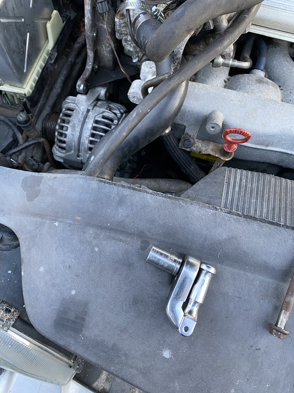

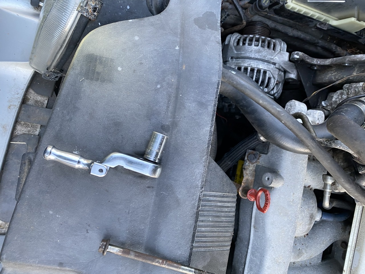

Did an alternator swap on the s70 UBG brand
Fixed power steering seep with oetikers
Discovered radiator seep at joint I think. Nice to be Spring where I don’t have to worry about freeze up
My little folding Tekton ratchet was perfect for the RN motor alternator bolts

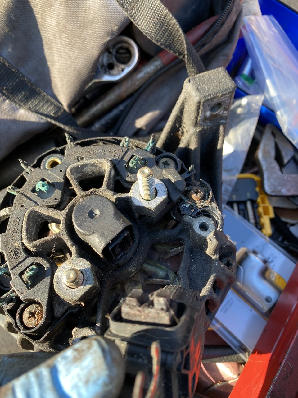

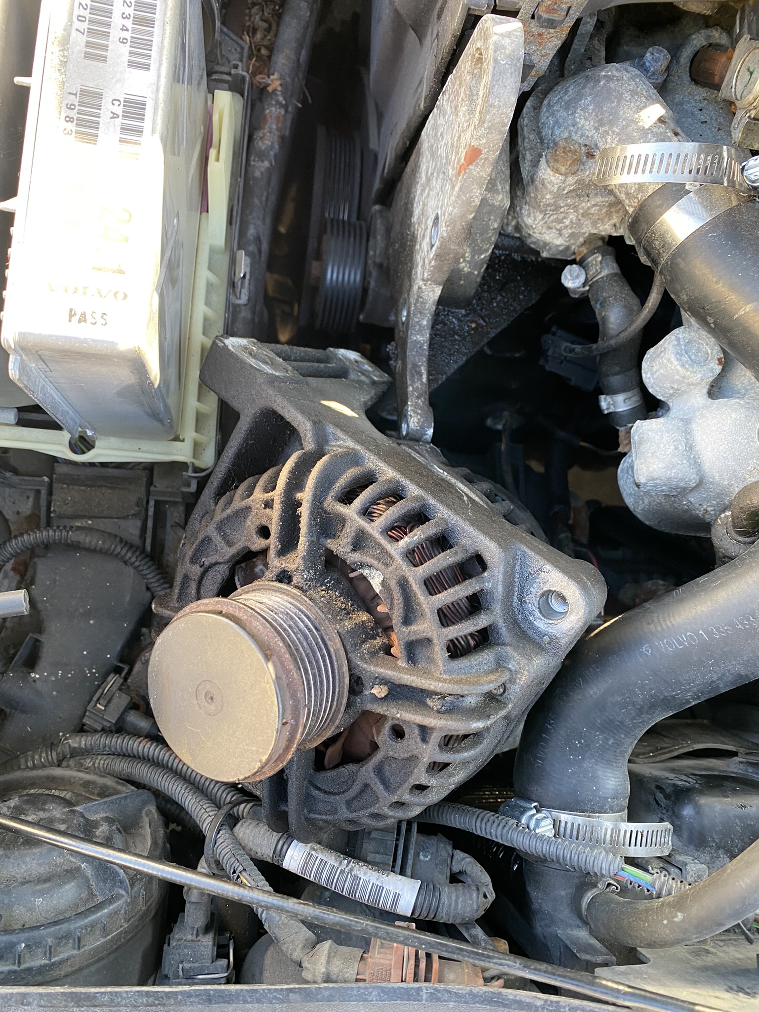

Here is my alternator Tetris picture, not too hard to remove on an RN
Lift alternator out of AC bracket ( lower AC bolts loosened 6 turns) , pivot mount up then slide over to starboard to get to removal position
