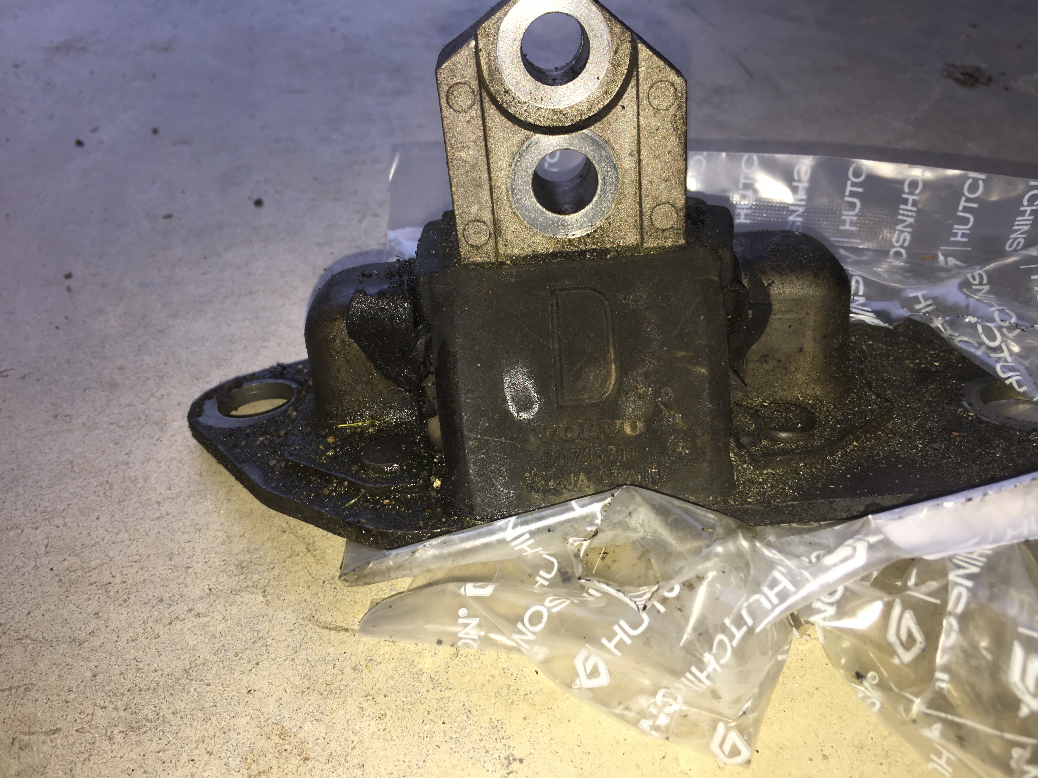

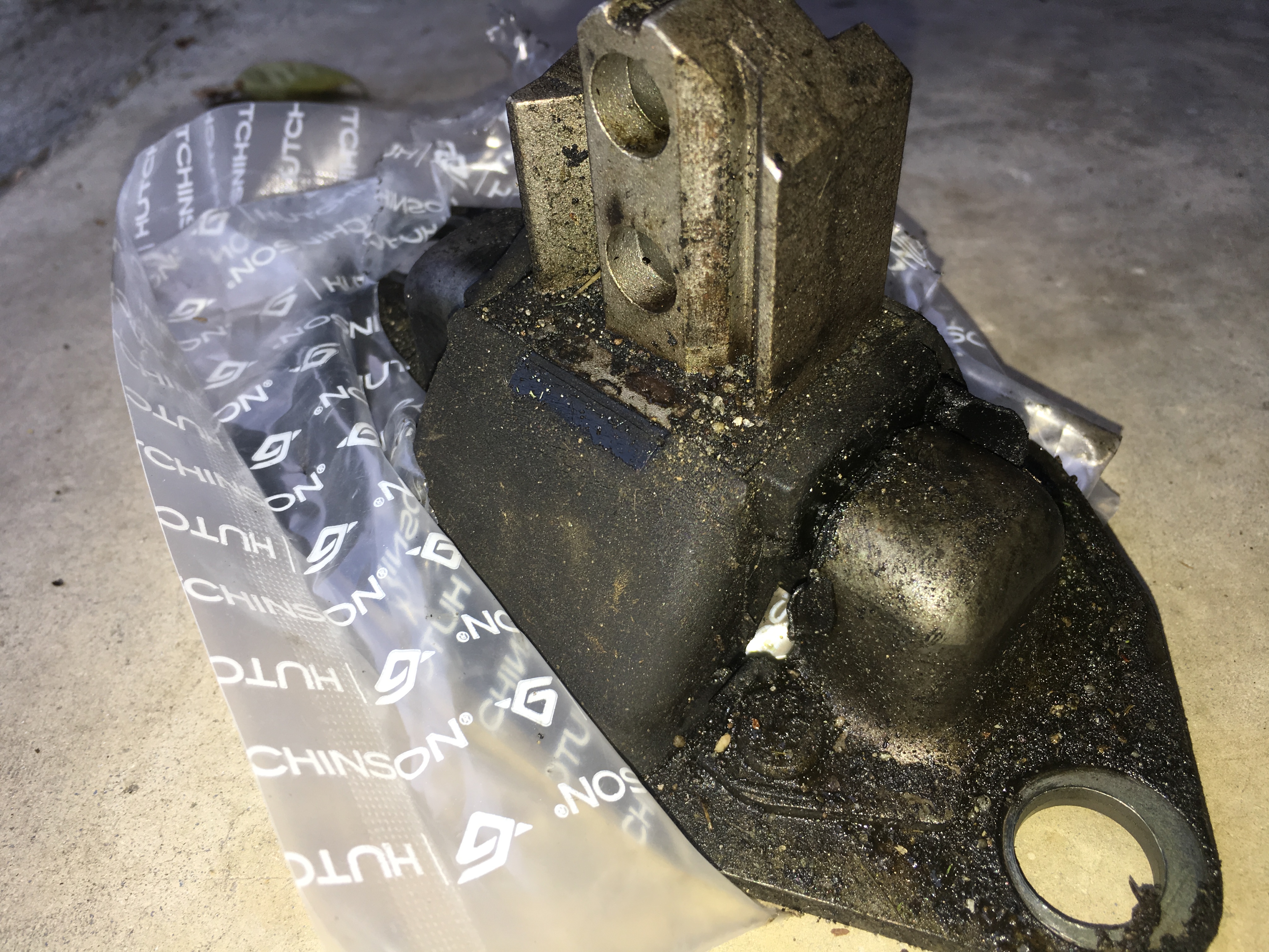

An oil change and replacing the passenger side lower engine mount. It was the longest oil change I have ever had to deal with because the previous oil pan bolt had just barely been in there and proved impossible to reinstall. I had to order a longer one.
The most interesting part was replacing the lower engine mount. It didn’t fail in the usual way, instead the rubber deteriorated on each side which allows the engine to tilt back and forward. It made a popping noise at the passenger (right) front on acceleration and deceleration. Accelerate, “pop”, then let off on the gas and “pop” again. From what I’ve seen online, it’s an unusual failure mode. So I figured I’d share. I’ve attached pictures; note the deterioration of the rubber at the sides of the steel the bolts to the engine. I can tilt the mount back-and-forth with my hand.

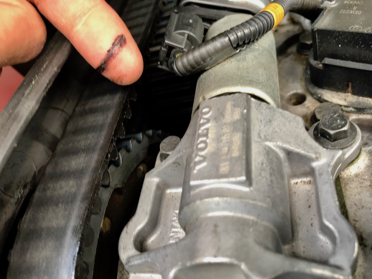

I finally managed to fit the right Banjo bolt for the Pcv system, so this is done for all!
Checked the timing belt to see if there was any leaks behind the cams.
To my surprise there is grease on the belt.
Wait!
it's not oil it's grease!
The bearing of the tensioner is leaking.
Wait!

Antoine240bk wrote: 15 Jun 2019, 13:31 I finally managed to fit the right Banjo bolt for the Pcv system, so this is done for all!
Wait!it's not oil it's grease!
Could it be grease from the nearby CV joint ? Which brand the tensioner ? I put a Dayco kit and boy it didn't last. The belt was almost in pieces after 20000 km, the roller was throwing grease right from the start, the tensioner was running dry too. Also careful if the water pump was replaced with anything but Aisin
