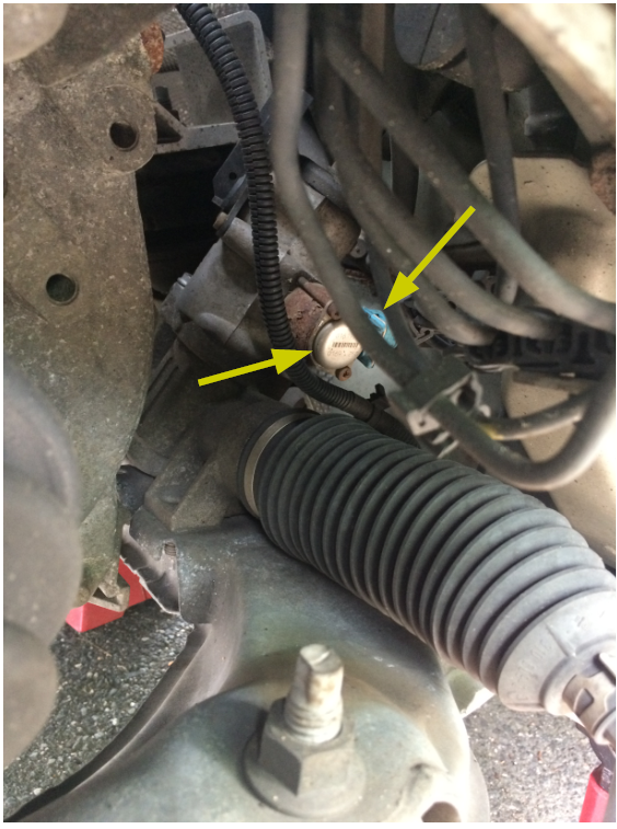

Good News: Replaced 4 of 5 engine mounts in my 2006 V70 (saving the rear for when I install a new steering rack) and installed new brake rotors. Less engine vibration for sure. The front mount didn't give up as easily as it did in the FCP video. Had to remove the bracket it bolts to in order to get it out and spent a good 30 minutes trying to get that bracket back on.
Bad News: It would appear that I have a speed sensitive rack (on a base wagon!) and the non-speed sensitive rack I ordered off eBay showed up today:) Sadly, it's pristine. I'm assuming that what I'm pointing at with the arrows indicates the SS rack.
