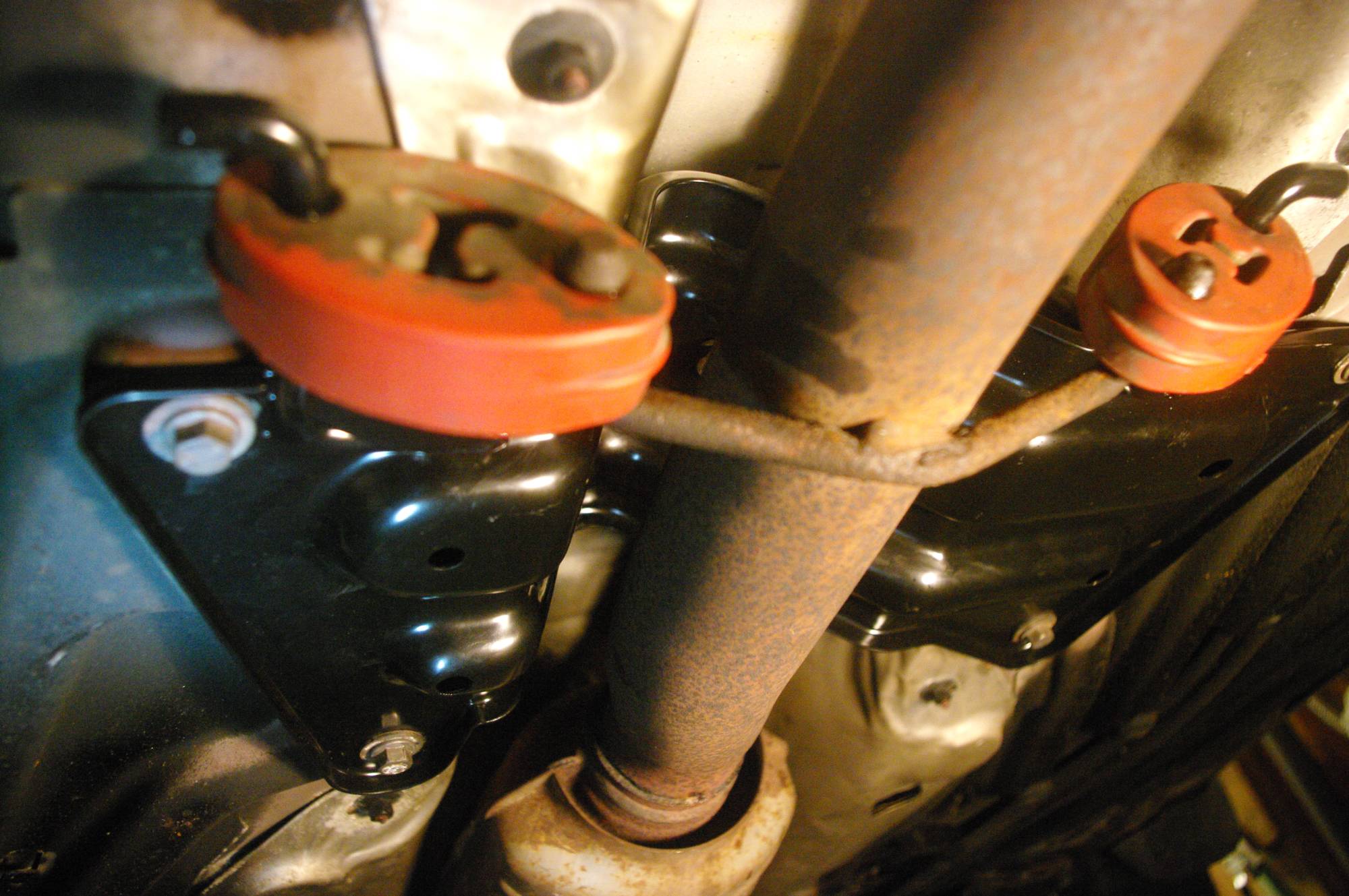

Shiny new 9474483 - they call it a 'floor extension', FCP calls it a cross member support.
Not cheap, but I couldn't have fabricated one out of flat plate for less, especially since bending heavy gauge stock to a precise angle is ...challenging. Couldn't find one used, neither could Robert, and Abscate hasn't dismantled any AWD P80s - except the S70 he's driving, and we shouldn't remind him he had it apart twice.

I've been trying to figure out how to make a C70 SF brace work with that bracket, but I'm too lazy to try to make it work. I think I'm going to wait until I put in a full FWD exhaust system, being that I have no AWD components left on my car.

It's great that the part is still available. I always wonder if some parts are in low demand so there's a supply of them waiting to be used up, but they'll never be made again. And I wonder if some parts which have no supply sit and gather back orders until there's enough demand to justify another production run. But that would be a low volume run requiring setup and tooling. So yeah, obtaining new parts for 20+ year old cars mystifies me. But I kind of want to buy a stockpile...
