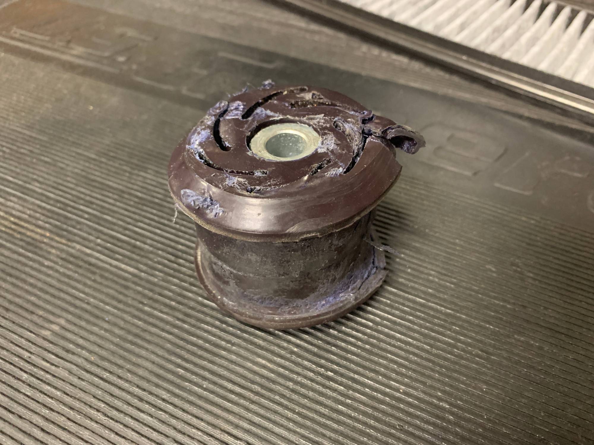

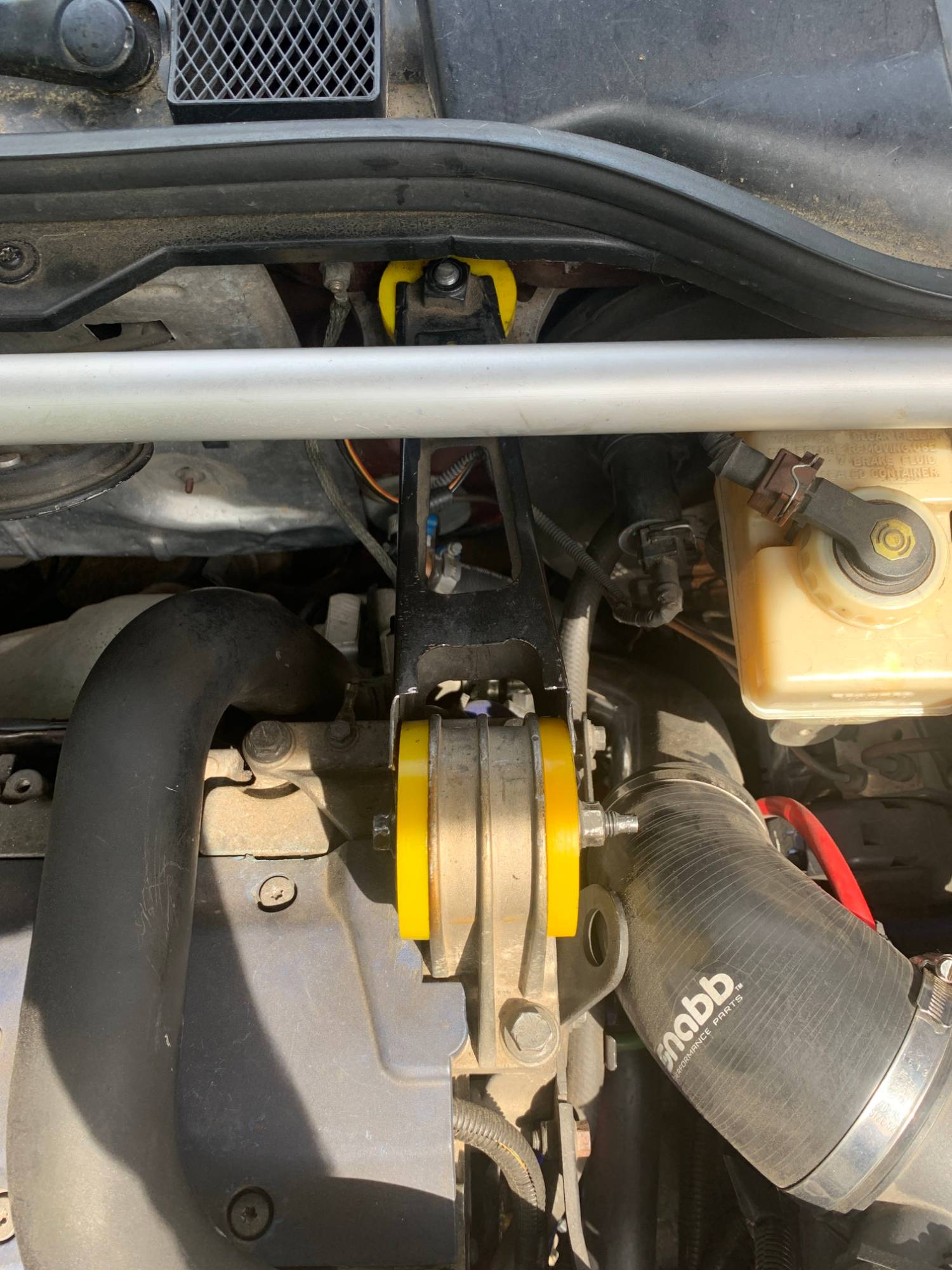

Speaking of mounts... replaced the trashed iPd torque rod bushing with a Powerflex today. Much better!

It's only a year or two old, believe it or not. I'm really disappointed by the quality of the iPd bushing. It was definitely vibrating more than it was before. I felt like it was feeling kinda harsh for a while, then I noticed the chewed up bushing while I was doing other stuff under the hood and it all made sense. I still haven't driven it yet since replacing the bushing, but I'll drive it today and see how much better it is!
They do, but not a whole lot. My car has more NVH than the typical P80 because I have the poly bushings on this torque rod, the lower torque rod, and delrin subframe bushings. I don't mind it, but some may not like it. I'm sure with an auto trans, it would be a little annoying sitting in gear on the brakes.kallekula wrote: 01 Jul 2022, 12:32 Im vary of those never-ever-breaking powerflex or whatever the material/brand. Doesn’t it cause engine vibrations?
After putting poly transmission mounts on my E46, nothing like this will phase me. Those genuinely made me think I had a severely unbalanced flywheel or something else horribly wrong. The vibrations were unbearable. Put some stock rubber ones back, the car feels great now. I would never recommend those poly trans mounts on a BMW!
