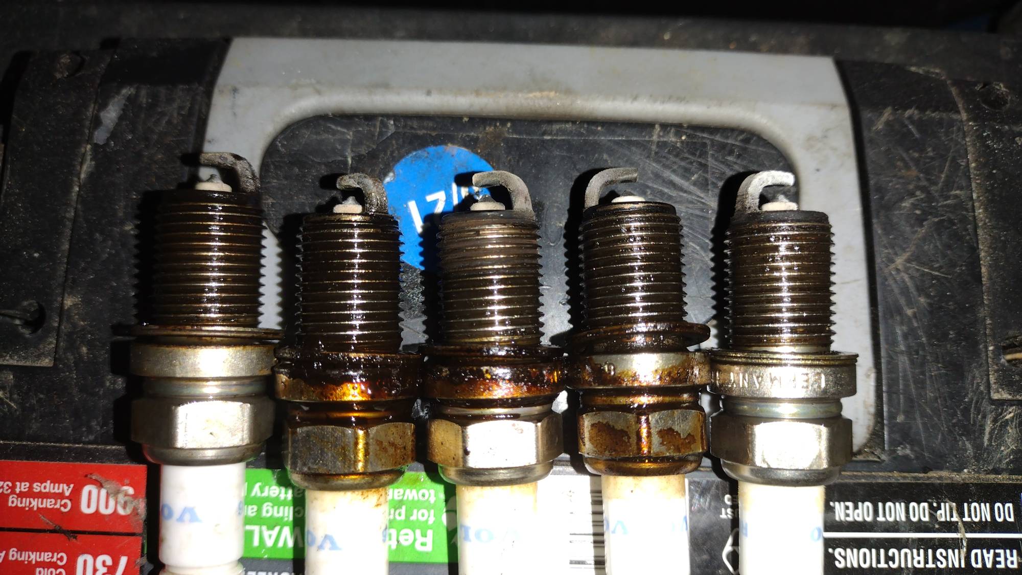

So far only have one regular code P0410 for the air pump. Wanted to get rid of that crap anyway. Pretty sure it has an evap leak, but that code only appeared once and cleared itself. Still getting very random misfires.
I'll be passing by the S70 this week. So I can grab the new-ish wires, cap, and rotor. Pretty sure there are 5 new Bosch copper plugs in the glove box too. It stumbles off idle and misses when I really get into the throttle, but only sometimes. Kinda feels more like a fuel issue than ignition. Pretty sure there's a virgin fuel pump relay in the S70 too.

Pulled the sparkplugs to examine. Volvo plugs and they don't look bad. They are definitely well used. Gap was .040! They could probably be regapped, but I have 5 new copper plugs on hand. Will likely replace in the morning.
Conducted a glove test since the oil change. Glove isn't getting blown up, but the suction at idle seems a little lack luster. Under revs it sucks pretty good.

Replaced the well used Volvo plugs with a set of Bosch coppers I had on hand. Went for a long spirited drive to get the Odo to roll over 325k miles. No more stumbling off idle and under boost. Really should've done that weeks ago. Was averaging ~23mpg before, hopefully can get that over 25 now.
