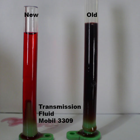

I started changing AFT MOBIL 3309 in both cars. 1st D&F was completed last week. The 2nd D&F coming this Friday 30th.

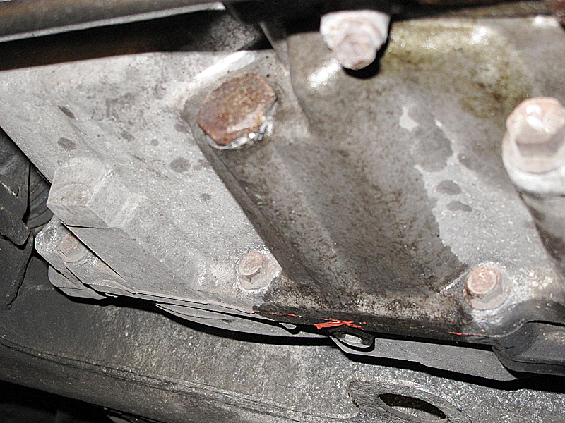

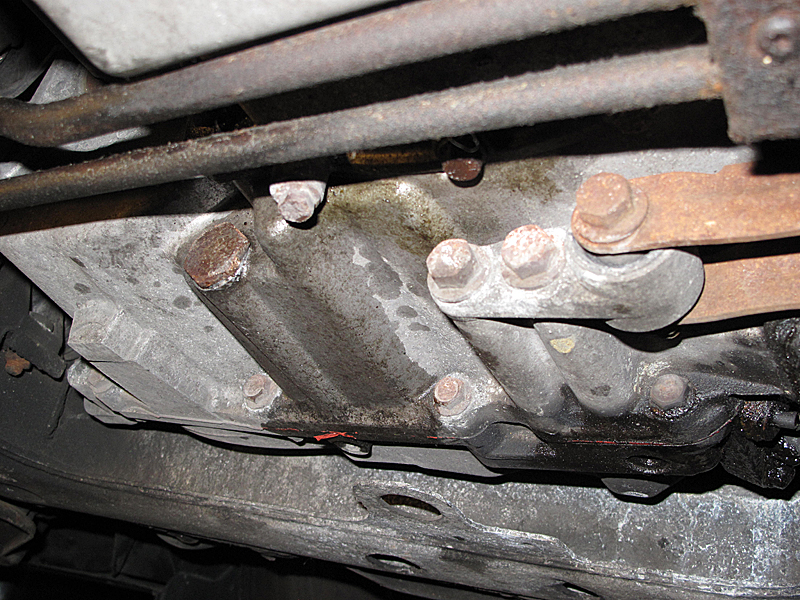

A follow up look underneath 1997 Volvo 850, there is no drip, fluid level is study, but few question with photos. TIA

Pictures after 2nd D&F on 2001 V70XC.
while looking for any leak...
This looks unusual, does it need replacing? what?
Many thanks!
Many thanks!

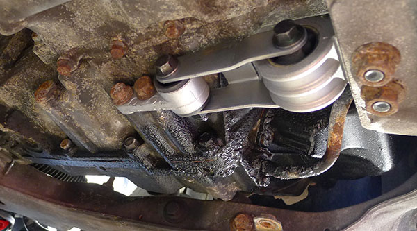

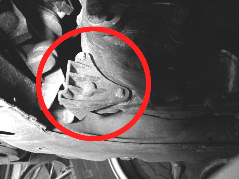

Hi xHeart,
From your "pictures with questions"
I just replaced my transmission mount. I couldn't tell from having it on how loose it was, so if you want you could just remove it and check. It's dead simple, as the mount doesn't actually hold anything up so you don't need to support something while doing it. There is always a pretty good chance when removing it you'll break the last little bit of rubber that was holding it together of course, so approach with caution!
The new mount was also pretty floppy (based on what I imagined), although not remotely as bad as my old one (02 S60 111K miles). Thus I doubt I would have known if the mount was good/bad without having a new one anyway, at which point I would just install it
I'm curious about all that black leaking caked-on oil, as mine looks the same, or maybe a little worse. No fluids are down and the leak seems to be coming from up higher and just collecting there. Does your car have a turbo (mine does)? That was my only guess so far: Although I haven't ever done work under the skid plate until now, so I don't know how long this has been going on for.

coflynn, your above two post are enticing for MVS DIYers. It is assuring. I will take on the transmission mount task next along with transmission cooler connectors and seals.
I use power washer around the house to clean up. Wish there was a power washer to cleanup stuff sticking to leaks, hoses and clamps.
