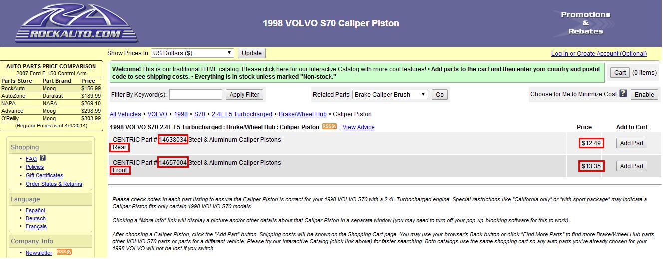

For those who need caliper pistons.
- OEM ATE 38-mm Rear Piston is hard to find. Some UK ebay sellers may carry it.
Or you can salvage a piston from from a used caliper from local junk yard etc.
- I just found out Centric makes caliper pistons (check their website) for our cars.
- Seal/Boot: ATE is the best (about $25-$30), but I guess you can use Centric (? made in USA, to be verified) or Carlson rebuild kit (made in China, I have it in my hands lol) too.
Some people say "why not swap Rear calipers using rebuilt calipers from local parts store?" Well, in many cases, the rear caliper is seized into the metal line and virtually impossible to remove w/o cutting the metal lines. In that situation, it is better to rebuild the caliper "in-situ" (see 1st page of this thread) using new seal/boot and new/used pistons.
So:
- REAR Piston (qty = 2/caliper) CENTRIC Part # 14638034.
- FRONT Piston (qty = 1/caliper) CENTRIC Part # 14657004.
So:
