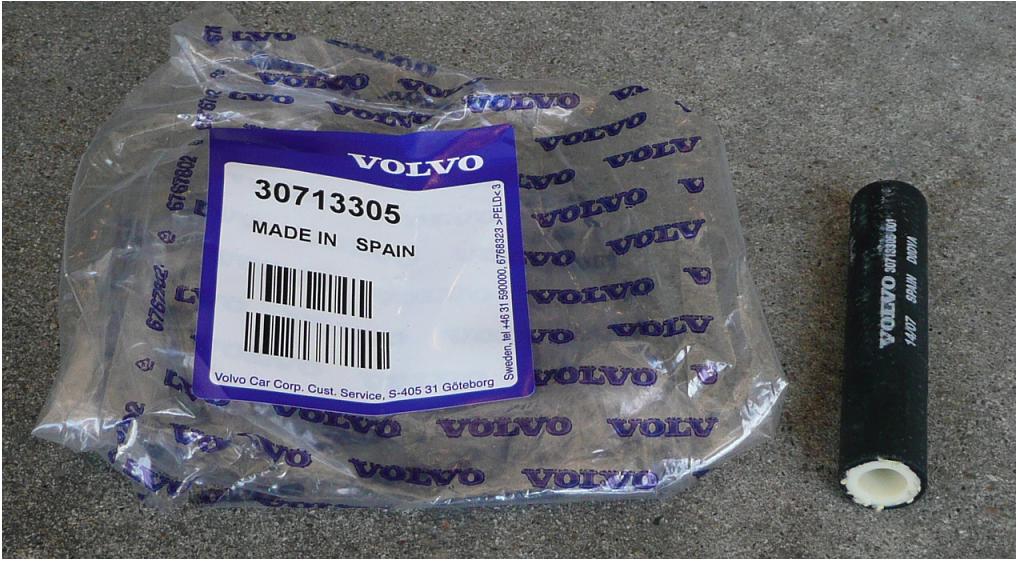

Just replaced the Short Coolant Hose PN 30713305.
About $9 at dealer, made in Spain, it has an inner sleeve which is white. My guess is that the white material is silicone.
Anyway, this hose should last some 100K+.

Just replaced the Turbo outlet hose on my 2004 V70.cn90 wrote: Update re SHORT hose PN 30713305 (right behind cylinder head area)...
Per FCPEuro, PN 31439471 is interchangeable with 30713305. 30713305a, 30713305, 31104675.
Photo showed "Silicone Insert" as in the photo below, but when I received it, the plastic bag clearly says Volvo Genuine part.
But, I ordered the one on the LEFT, but received the one on the RIGHT (in the photo):
1. It is no longer made in Spain, it is now made in Turkey.
2. The Silicone insert is no longer there, it is just straight rubber hose as far as my eyes can tell.
Looks like good quality but the question is, has anyone noticed that Volvo switched from "Silicone Insert" (Spain) to "no Silicone Insert" (Turkey)?

Mine was the one from Turkey as well that I received from FCP a few months ago. I can't say I even looked at the picture though and my car didn't have an OEM hose from the PO.cn90 wrote: 13 May 2019, 06:44Just replaced the Turbo outlet hose on my 2004 V70.cn90 wrote: Update re SHORT hose PN 30713305 (right behind cylinder head area)...
