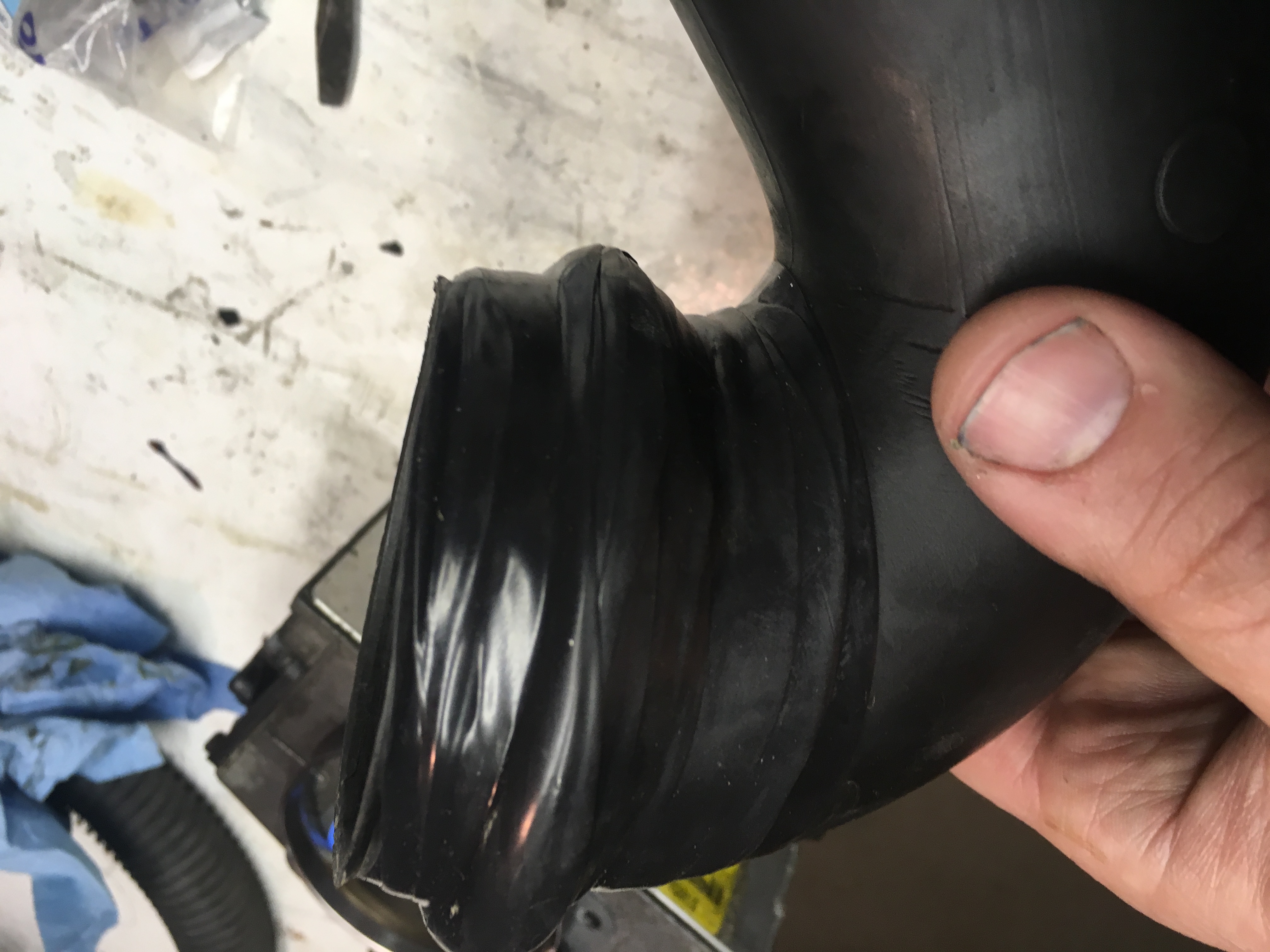

I visited the parts department at Volvo Village Danvers. They do keep one of the intercooler pipes in stock and their price is $91.34. If there’s a shipping charge for the $75 online part, it might be worth it to go local.
As far as I can tell there is no part dedicated to supporting this pipe - it’s hose clamped to the throttle at one end and the intercooler at the other, and there are two electrical connectors and a vacuum hose attached to it.
My plan is to tightly wrap black silicone tape around the end of the pipe (starting below the hose-clamp area and winding around upwards) to create an exterior airtight layer that will cover up the cracked area. If this seems to solve the problems I’m seeing, then I’ll look at getting a replacement pipe.

The tape will get you out of trouble and I've used that method on a customer's car about a year ago. He had lower than normal metered air readings of around 9kg/hr at idle and when I plugged up the pipe in that same spot the reading shot up to around 12.5kg/hr.

Alright, I’m feeling good about this fix... going to go install and see how it goes.
