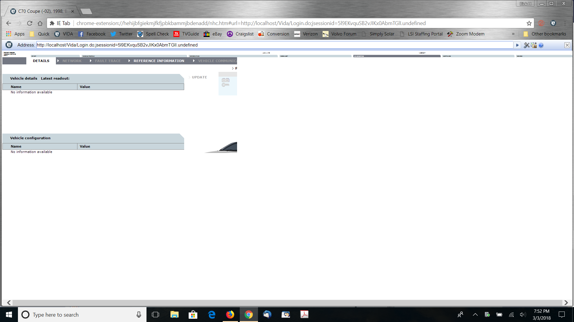

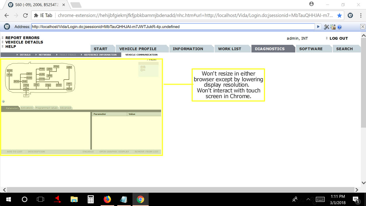

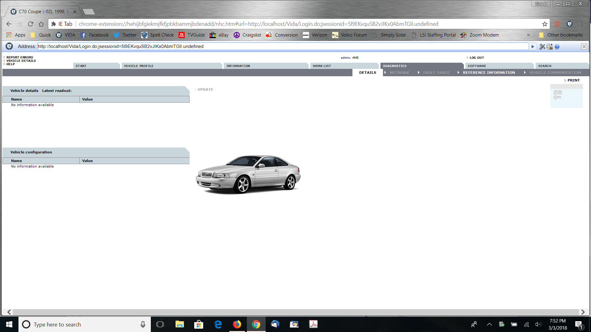

Hey RichHP, a quick note. Chrome doesn't seem to get around needing to lower the display res for me.
Same as in IE, login screen and upper parts will resize but the business portion underneath the tab headers appears to be effectively locked to a specific pixel size. Lowering screen res to 1280x720 fixes it. Also the touch screen doesn't interact properly in chrome, specifically, the frame highlighted in yellow which is the part that doesn't want to resize via browser zoom.
Literally the first time I've ever seen an issue with touch screen. It's always worked flawless. Some of this might be hardware dependent where behavior might vary from one machine to the next. I suspect hybrid/switchable gfx drivers on this particular laptop (Radeon + Intel 4000 on the CPU die) might be playing a role. On this machine IE appears to work fine with VIDA, so I'll stick with it. I'm not real crazy about Google-Chrome's eula/data collection policies anyway. Yes I actually mull through these things before installing new software, especially "free" software. So it really doesn't bother me to continue using IE just for VIDA and probably uninstall Chrome.

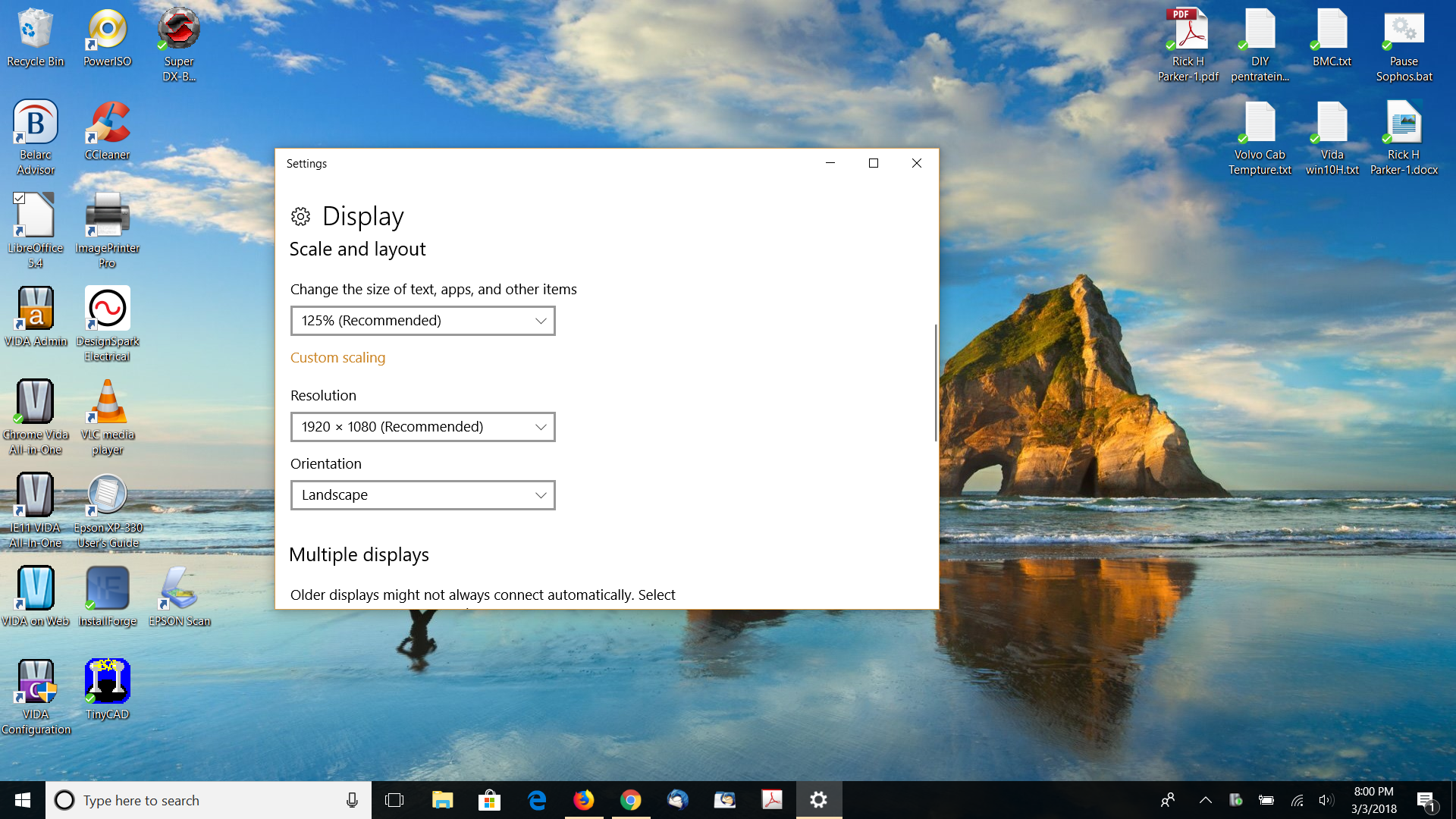

In Chrome I can get that to resize with [Ctrl] + ([-] or [+]) at a screen resolution of 1920 X 1080.
If I see that on my screen, [Ctrl] + [+] would fix it.
[Ctrl] + [+] Two finger salute, hold down the [Ctrl] key and then tap the key with the + sign on it.
