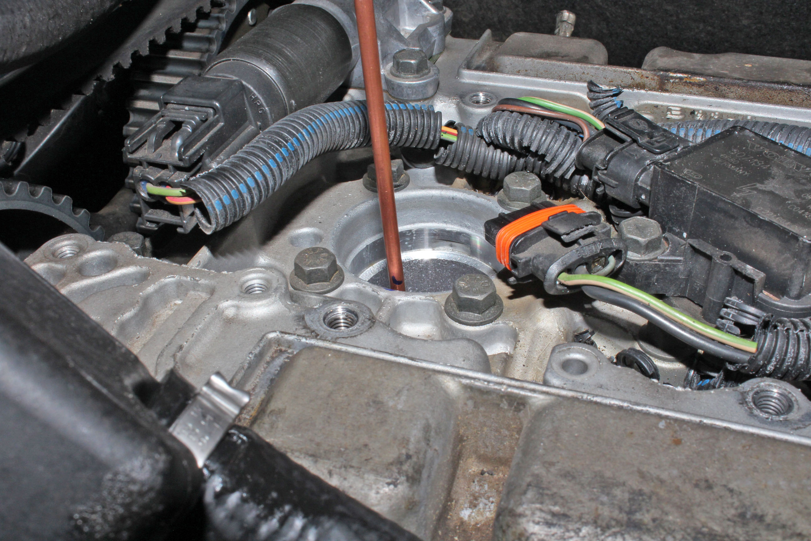

Update and question. Went out to the garage this morning to tackle this issue again. After thinking it through over and over again...I thought, if anything I'm only slightly out of time. Like a tooth or two or three. I took the CPS's off the back of the cam shafts and I could see that the slot on the intake cam was straight up and down. but my exhaust cam was not. it was angled a little forward or turned a few degrees in the clockwise direction if you were looking at the engine from the passenger side (the front of the engine). I decided to take out the VVT hub cover and try to turn the exhaust cam counter clockwise only slightly using the T55. I did that just enough to line up the slots on the back of the cams so that they were both straight up and down, perpendicular to the head junction. I put my timing belt back on and tensioned it up right. Then I started to turn the crankshaft clockwise and it turned over!!! not locked up anymore. I turned it over eight times and the marks are line up. Now, the marks are not perfect to when I made them before I took everything apart. but the engine is turning over smoothly by hand. And I'm thinking when I made the marks before the exhaust cam was slightly out of line anyway....I had to use the cam locking tool to turn it slightly to line up to get the cam locking tool on. They may be what cause my later problems.

You've left out the most important piece of information... when the timing marks on the crank and hubs are aligned what do the slots on the rear of the cams look like? Are they horizontal with the correct offset when the timings marks in front are lined up? It's good that you're able to turn the engine over now so you can check the cam rear slot alignment when the timing marks are aligned in front. I'm assuming with the rear cam slots perpendicular as you mentioned this is not when the crank and hub timings marks are aligned in front. When aligning the timing marks in front only turn the crank CW just until the marks are aligned, this will give a better look at how the CVVT hubs are setup. Before putting things back together you need to check the rear cam slot positions with the alignment marks in front set.Goldchemist wrote: 10 Mar 2019, 11:11 Update and question. Went out to the garage this morning to tackle this issue again. After thinking it through over and over again...I thought, if anything I'm only slightly out of time. Like a tooth or two or three. I took the CPS's off the back of the cam shafts and I could see that the slot on the intake cam was straight up and down. but my exhaust cam was not. it was angled a little forward or turned a few degrees in the clockwise direction if you were looking at the engine from the passenger side (the front of the engine). I decided to take out the VVT hub cover and try to turn the exhaust cam counter clockwise only slightly using the T55. I did that just enough to line up the slots on the back of the cams so that they were both straight up and down, perpendicular to the head junction. I put my timing belt back on and tensioned it up right. Then I started to turn the crankshaft clockwise and it turned over!!! not locked up anymore. I turned it over eight times and the marks are line up. Now, the marks are not perfect to when I made them before I took everything apart. but the engine is turning over smoothly by hand. And I'm thinking when I made the marks before the exhaust cam was slightly out of line anyway....I had to use the cam locking tool to turn it slightly to line up to get the cam locking tool on. They may be what cause my later problems.
You're right. The slots on the rear of the cams are horizontal with the correct offset now. You assumed correctly. When the slots were perpendicular, all my marks were about 1/4 turn clockwise from their marks on the front of the engine. I had turned my crankshaft 1/4 turn CW from the marks and the engine would not turn any more. Thats when I looked at the rear of the cams and the slots were perpendicular. But one of them was not perfectly perpendicular, the exhaust cam. I turned that one back CCW just a hair to line it up. The way I turned it back was using the cam shaft bolt (T55) on the front of the engine. It did not take much force at all so I doubt the bolt budged. then reinstalled the timing belt. Now its turning over again. My problem now though is the marks I made on my CVVT hubs are about one tooth off. Still better than it was before though.

The cam slots being perpendicular with only 1/4 turn of the crank (from marks aligned in front) doesn't make sense to me. The cams should have only turned 1/8th or 45 degrees from the horizontal position not 90 degrees. Are you certain the crank was only turned about 1/4? What concerns me is if the engine wasn't turning over previously due to a piston contacting a valve your timing is off by more than a tooth or two but, if the rear cam slots are horizontal with the correct offset when the marks are aligned up front you should be good. The only other possibility as Abscate mentioned, which is very low probability, is the lower timing belt pulley splines are sheared and the crank timing mark wouldn't be valid. To check this you would have to pull off the crank harmonic balancer pulley or you might be able to use a reference point I have. I recently measured the distance from the no 1 piston top to the edge of the spark plug opening (see photo) with the crank timing mark aligned, it was 160mm or 6 5/16 inches on my engine; 2001 2.3L T5. The damaged pulley though I would expect this to be a rare problem. Just FYI, the no 1 piston is very near TDC when the crank timing mark is aligned so you can easily see the top of the piston when the spark plug is removed.Goldchemist wrote: 10 Mar 2019, 13:14

I must have turned the crank more than a 1/4. I was only estimating. I guess the cams went a 1/4 and the crank went 1/2. I doubt my lower timing belt fully splines are damaged. I had it off to change the oil pump gasket and it looked great. I've since only driven it about 60 miles. The reasons I am thinking the timing isn't that far off is because I marked everything when I started this job and my car was running perfectly. I only wanted to change the cam seals and CVVT hub o-rings. When I put everything back together the first time, the car started up fine and I drove it about 60 miles. The P0017 code popped up and I noticed my timing belt was not very tight. I took it off and then put it back on too tight. Then during hand cranking to check, it stopped turning. Then all I did was turn my exhaust cam back about an 1/8 of an inch with the timing belt off. Reinstalled the timing belt, tensioned up nicely, and now its turning over by hand. We will see when I start driving her again around Wednesday or Thursday. I am just really glad that it is turning over by hand again. Thanks for the pictures.
