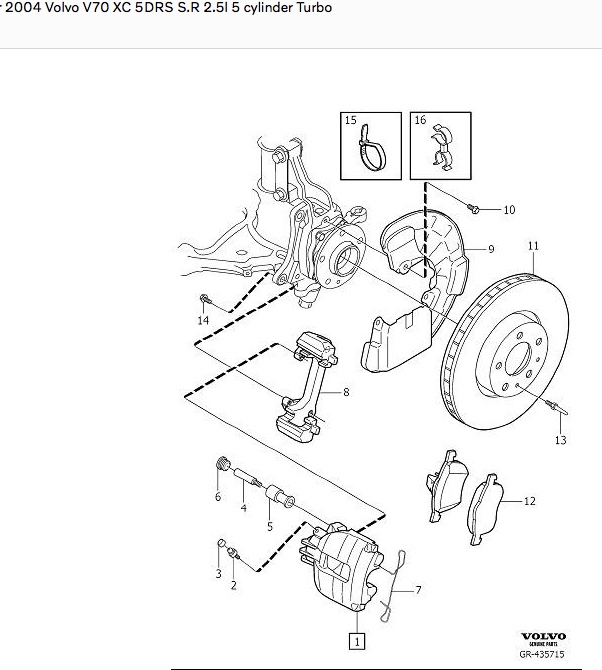

My wife's been driving Betty the Volvo for a couple of weeks. She mentioned a noise from the front end - tie rods or something she says? (I was impressed!) I said, oh, that's probably those front control arms I need to replace, there's a clunk.
Today I took it, and wow...the right front is clunking and clicking like a brake caliper is falling off or the wheel is loose! Checked wheel, all solid. Slowly cruised through some bumps and gutters to differentiate this noise from the deeper control arm bushing clunk. Lifted up and down on the RF fender and there's a loud click there. Guess that's what I'm doing this weekend.
Got to be strut (new) or hub or brake related I think. A CV joint doesn't click when you lift up does it? Steering is very solid, no play.
I'll climb under later.
< EDIT >
It's got to be somewhere in here.....
or here.......
Maybe a sway bar end link?
< EDIT >
or here.......

Sway bar end links can click. I'd go OEM or blue box genuine Volvo only on those. Aftermarkets and you'll be changing again in 15k miles.

FIXED! Cheap!....(free!) - this fits well in the Cheapskate Repair Model.
It was the upper hardware on the RF end link. They looked new, the boots were good, no play......but only when the suspension is hanging down and they're bound up! Put it back down and it's loose as hell. Ready to order new. Cranked down the torx and 17mm nut, and boom, it's gone!
