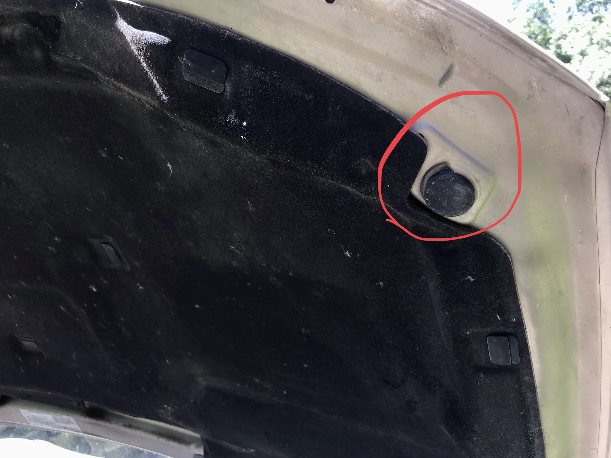

I'm going to have to deal with a non-functioning hood release lever first. . .
I can only pull the internal release lever back halfway before getting resistance. If a helper pushes down on the hood, then I can pull the lever all the way back, the latch releases and the helper can raise the hood to get to the release lever. Any suggested remedies?

Hopefully you don’t have to replace the hood pop cable. It’s only $36 but takes a bit of tinkering and time to replace.
One thing that helps reduce strain on the cable is to turn completely IN the rubber ~1ish inch bump stops on the right & left front corners of the underside of the hood.
Gotta get the hood open to do that though :lol:

Double folded cardboard wedged under the hood while you pull lever
