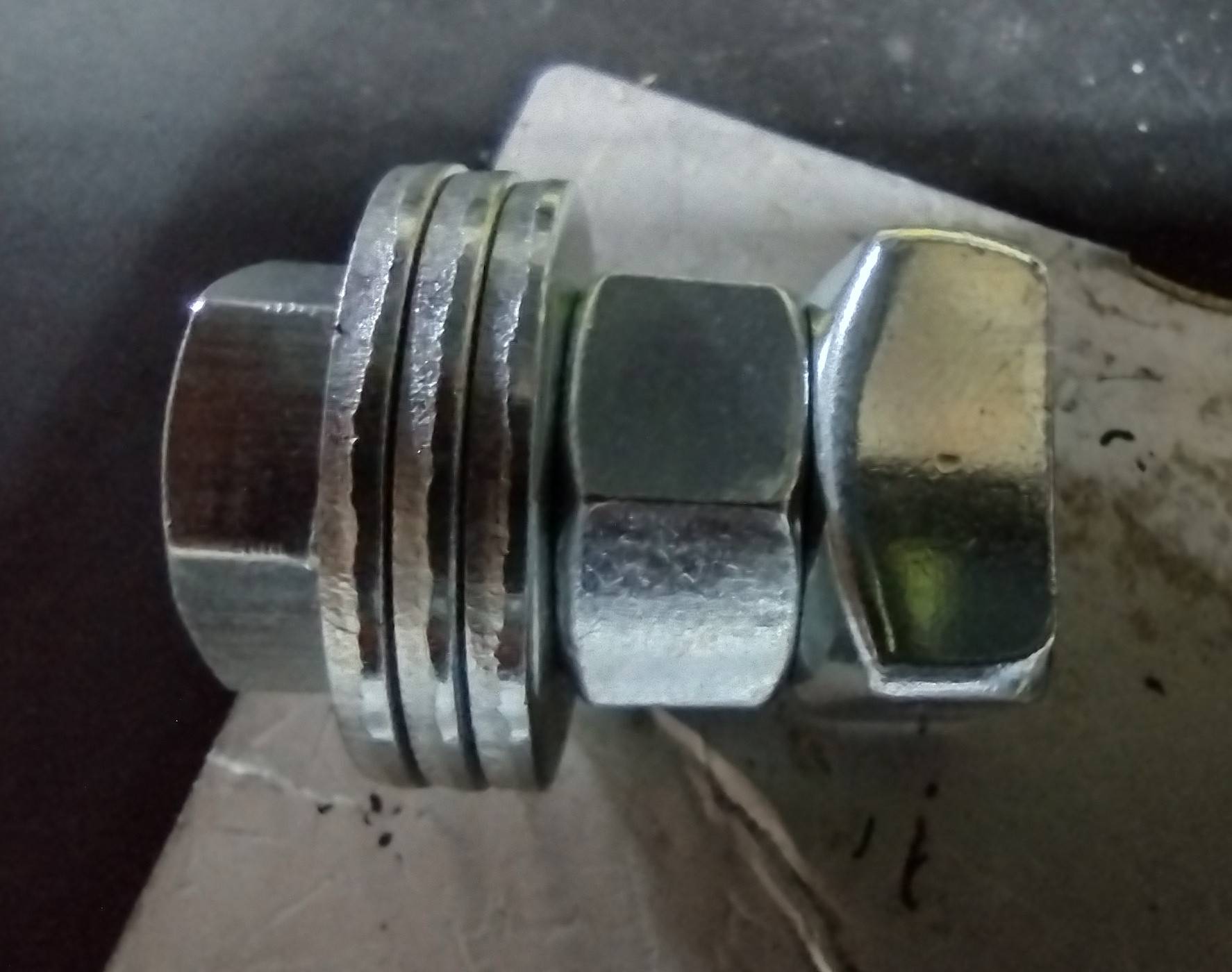

Since I lost my old serpentine belt tensioner tool, went to the farm supply store to make another one. 39 cents out the door. Is that a new record?

Couldn't get a 3/4" bolt and my angle grinder is taking an extended vacation in someone else's toolbox, so had to add washers.

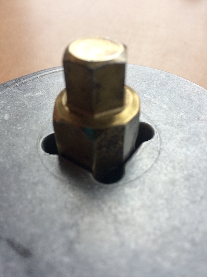

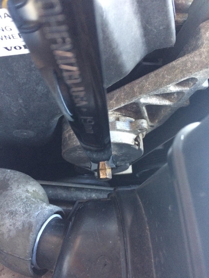

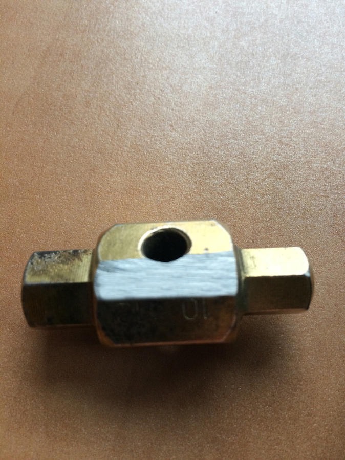

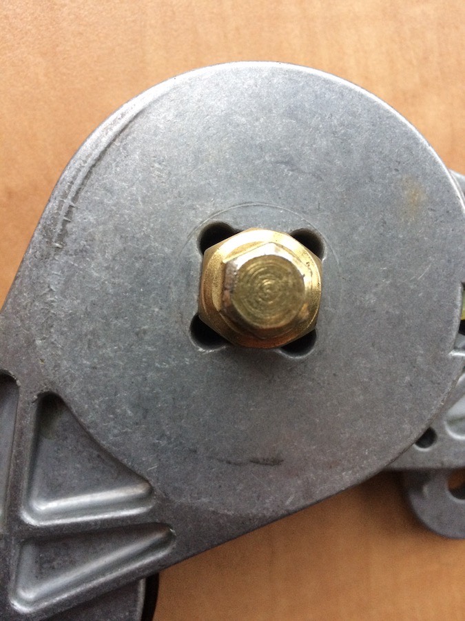

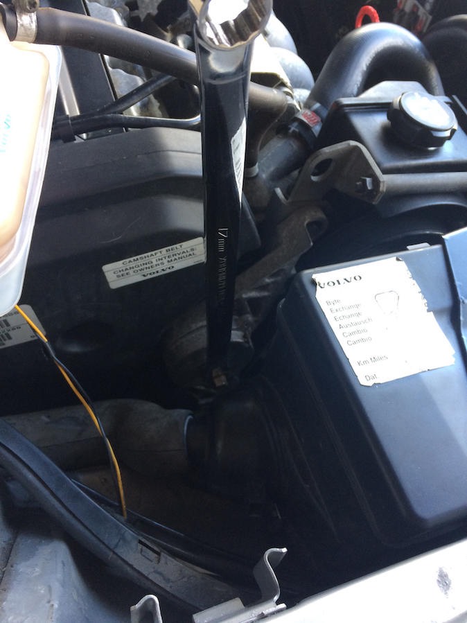

I made mine from a gearbox plug removal tool that has a 19mm spanner (wrench) sizeWhatAmIDoing wrote: ↑29 Jan 2023, 16:19 Since I lost my old serpentine belt tensioner tool, went to the farm supply store to make another one. 39 cents out the door. Is that a new record?
