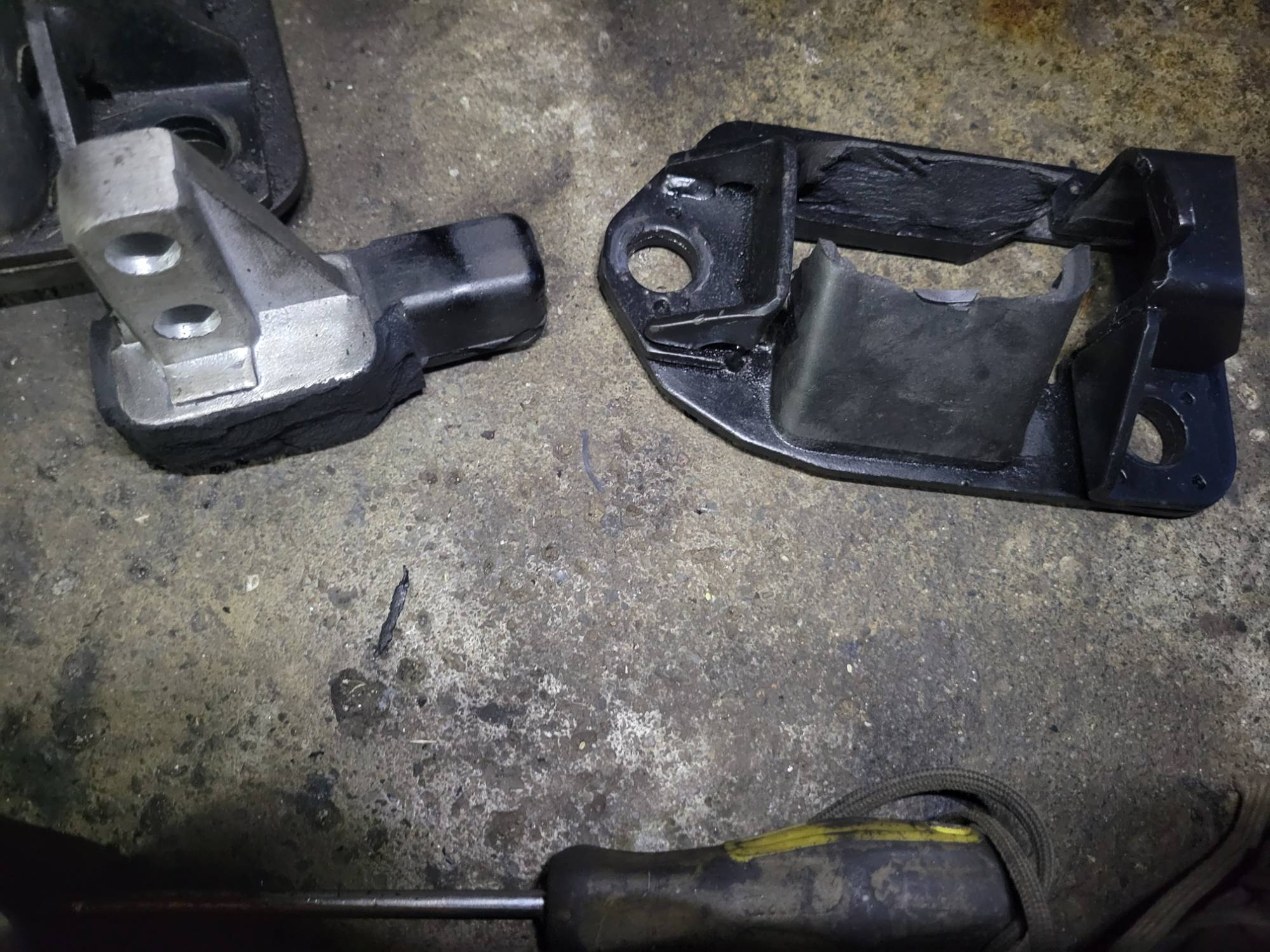

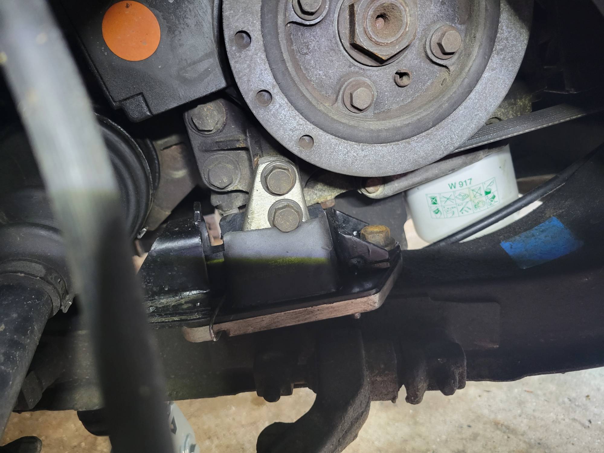

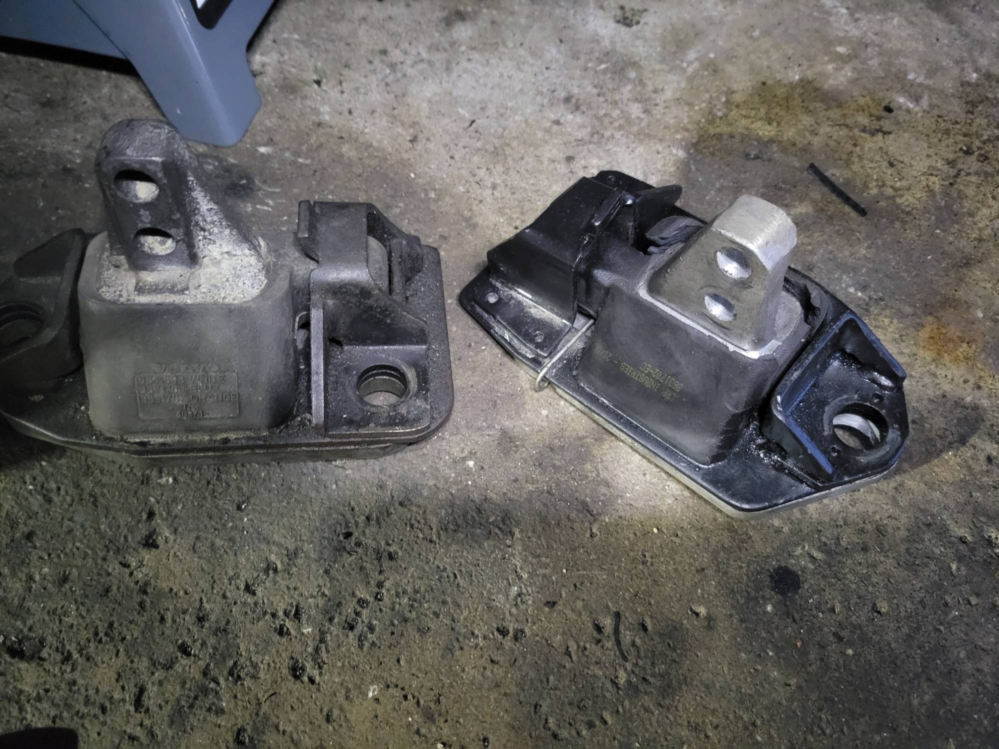

Out with the...new, in with the....old?
Poor showing from a rein engine mount. I noticed it was bad on the second day after install.
Completely broken through. Surprisingly, not as bad as you'd think, but definitely noticable when accelerating, and some extra dull clunking.
Part number CRP-AVE0621. Id avoid like the plague.

.jsrnsis wrote: 20 May 2024, 19:31 Out with the...new, in with the....old?
In the early 2000 I installed a Rein mount just like that in a 98 S70 T5. Lasted about a year so don't buy it or it'll Rein on your parade.
