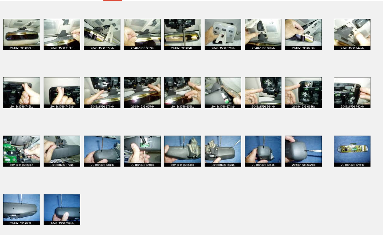

A few minor additions to those changing auto-dim to manual dim. I just bought a manual dim on eBay for $25 with shipping, so they are coming down in price.
Second, I used an IPD bone tool http://www.ipdusa.com/products/4801/110 ... -bone-tool to split the mirror case, it leaves fewer marks around the mirror than the screwdriver and causes less damage. Start at the top of the mirror by the seat-belt light, push down with the bone tool until the clip releases, but keep the bone tool in the groove between the case halves and move to the next clip, push down until it releases, and work your way around until the cover comes off.
Then I used the bone tool to remove the circuit board from the mirror along with some paint stirring sticks. Use the bone tool at one end of the board to get the board up off of the double-back tape just enough to slip the bone tool in by a half inch (1 cm) Then twist the bone tool to raise the board off of the sticky tape. Insert the stick to hold the board up, then move the bone tool to where the board is still stuck to the tape. Repeat, working down the board, until the board comes off. I didn't even need to use any heat.
Also, one thing I did to reduce static damage was to use my wrist ground strap and attach it to the ground of the good wiring board during disassembly/reassembly. I was lucky enough to get a piece of the wire harness along with the replacement mirror that had the connector and about 20 wires. Find the brown wire, strip it, and attach your wrist strap to that wire, plug the connector into the circuit board, and you are then grounded to the wiring board main ground plane.
I had some 3M spray adhesive form another project and used that to bolster the old sticky glue.
The manual mirror mini-printed wiring board for the seat belt LEDs does not have the rear-facing light sensor for the auto-dim circuit; also the manual mirror case does not have the front-or rear-facing slots for their respective light sensors. But the auto-dim circuit boards fit in the manual case just fine and fool the circuitry into thinking it's dark outside, both from the rear and the front, so no voltage is applied to the mirror to dim it.
Seems to be working fine, the interior lights work and the car accepts key fob commands.
Best of luck to all.

was pretty easy to do. put a manual dimming mirror in place of the auto.
from experience:
-dont bother saving the foam separating the board and glass. Use a long sliding knife and just keep cutting around until you separate the two. Replace with two layers of foam mounting tape or however many are needed to keep the pins from scratching the mirror back
-put some lube on the manual flip switch mechanism before reassembly

Well, it's done and it was easy thanks to this thread. The only trouble I had was that I couldn't detach the mirror from the windshield. My V70 is a 2008 and I tried the technique that works for the earlier models but I just couldn't get it lose....so I left it in place and removed the mirror bezel and took out the electronic board. The rest of the repair was just as it has been described above.
I put everything back together, reconnected the battery, worked the door remote 3 times and everything works just like it should.
Thanks again for all the help on this forum.
