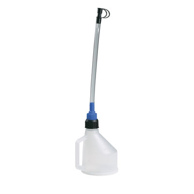

After the overfill incident in V70XC, I discovered the difference between Accuracy and Precision. Hence, wanted a better measurement of drain, and a controlled refill.
Our MVS Fazool had hinted of Hopkins-Measu funnel in another post. For $5, it is worth it. Among many functions include markers for North American residents, i.e., ml, oz, cup, qt, and... clarity!
The 3rd drain of 850 was above 1200ml, thus refilled 1200ml, it came to one notch below Cold/max. The simple D&F task is now complete in both my cars.

That funnel you mention was the one I used - works perfect, fit in but still had some room to let air out & fill up the fluid quickly. If you are in Canada you can get it at either Princess Auto, and I've seen it at some Canadian Tires too (not online though?).

I did my fill and drain this weekend (I do this every 33,333 miles). Went to the local pick and pull and scored the tranny oil return line. Cut it so I had about 6 inches of the hose, and then went to Home Depot and bought 5 feet of hose that was a perfect slip fit. Didn't even need a hose clamp! My fill funnel is CarQuest PN 30067. It is the perfect length with the perfect diameter. You still need to pour in the oil slowly, as it will leak slightly if you rush the job. This was the easiest fill and drain, I've ever done. Pump out 2 quarts into measured 1 gallon container, then back fill 2 quarts.
