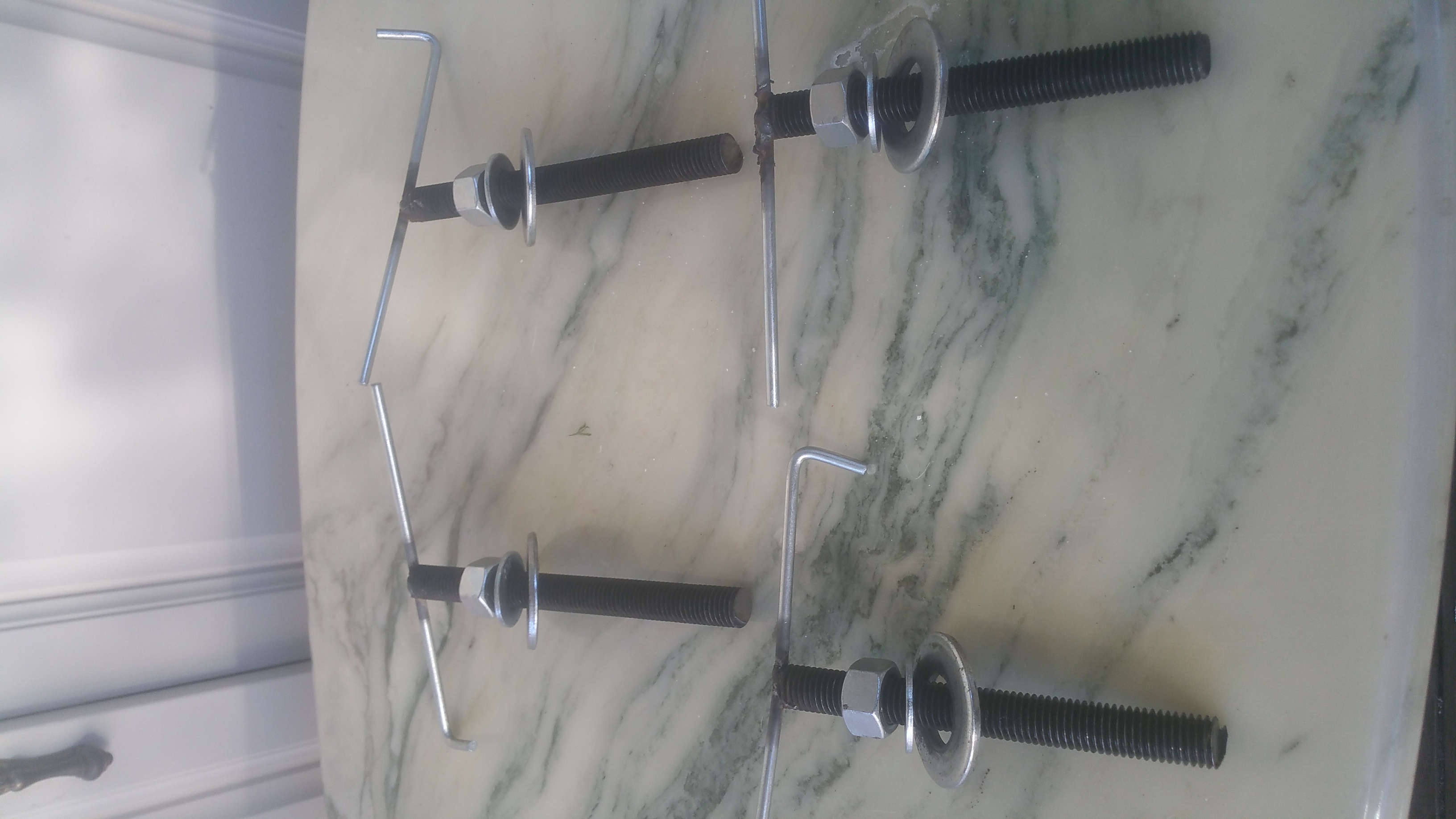

Made a set of subframe dropppers yesterday from M14 high tensile threaded rod so I could replace the booster with a new one. Pedal stays assisted well after 5 minutes for one pump of the pedal after the engine has been turned off and the infernal hissing from the old booster has stopped after engine has been turned off.
Pedal still sinks to below what is comfortable for me. Have to go through Vida this evening for the official bleeding procedure for these P2s. There must be something I've missed.

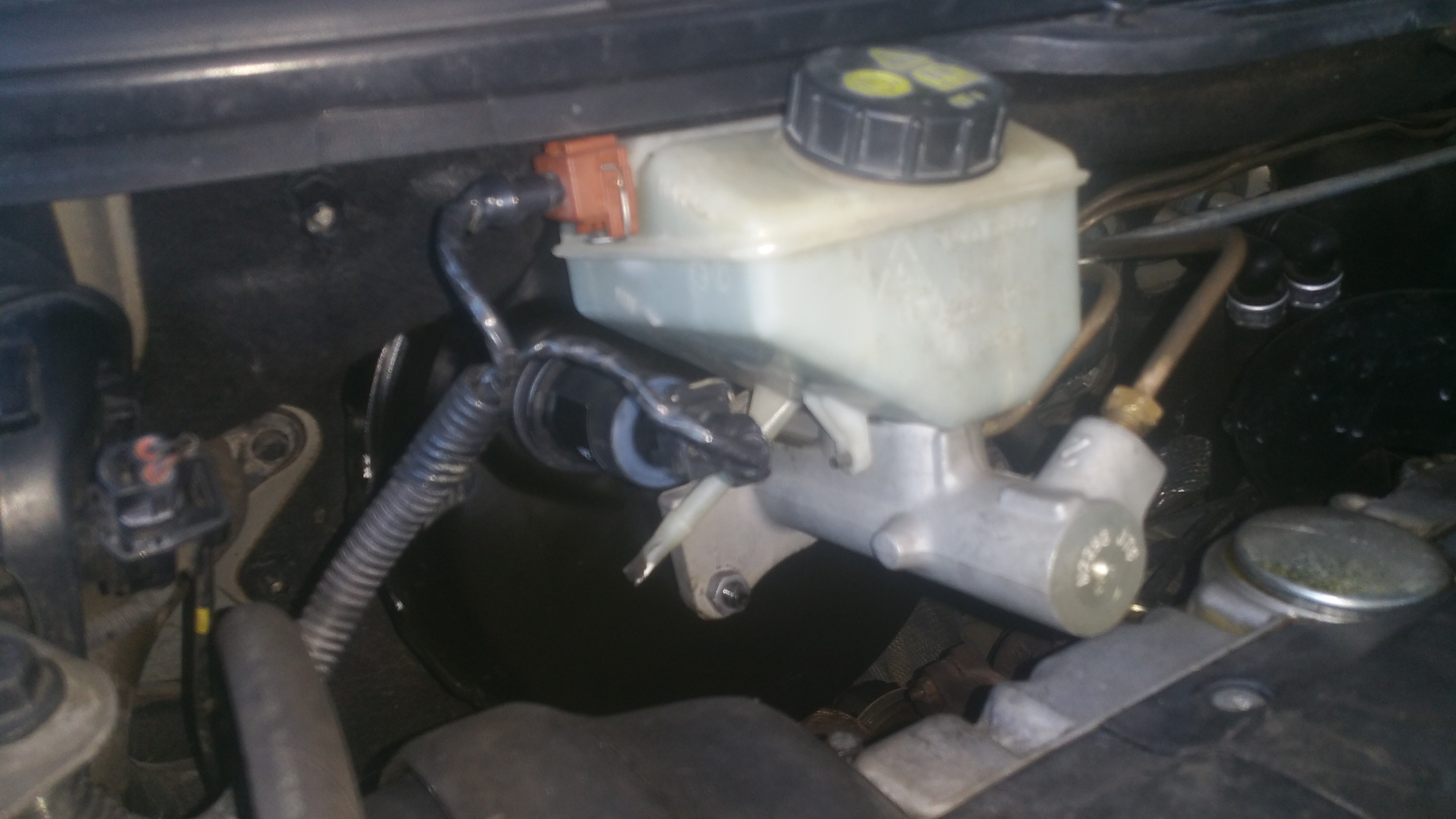

That's an XC90 master cylinder and reservoir in that pic above by the way. I tore one off our 2006 XC90 for testing and still the same result.
Had a look at Vida's bleeding procedure. They suggest pressurising the reservoir with a pump and to have the pedal depressed while draining the bleeder nipples.

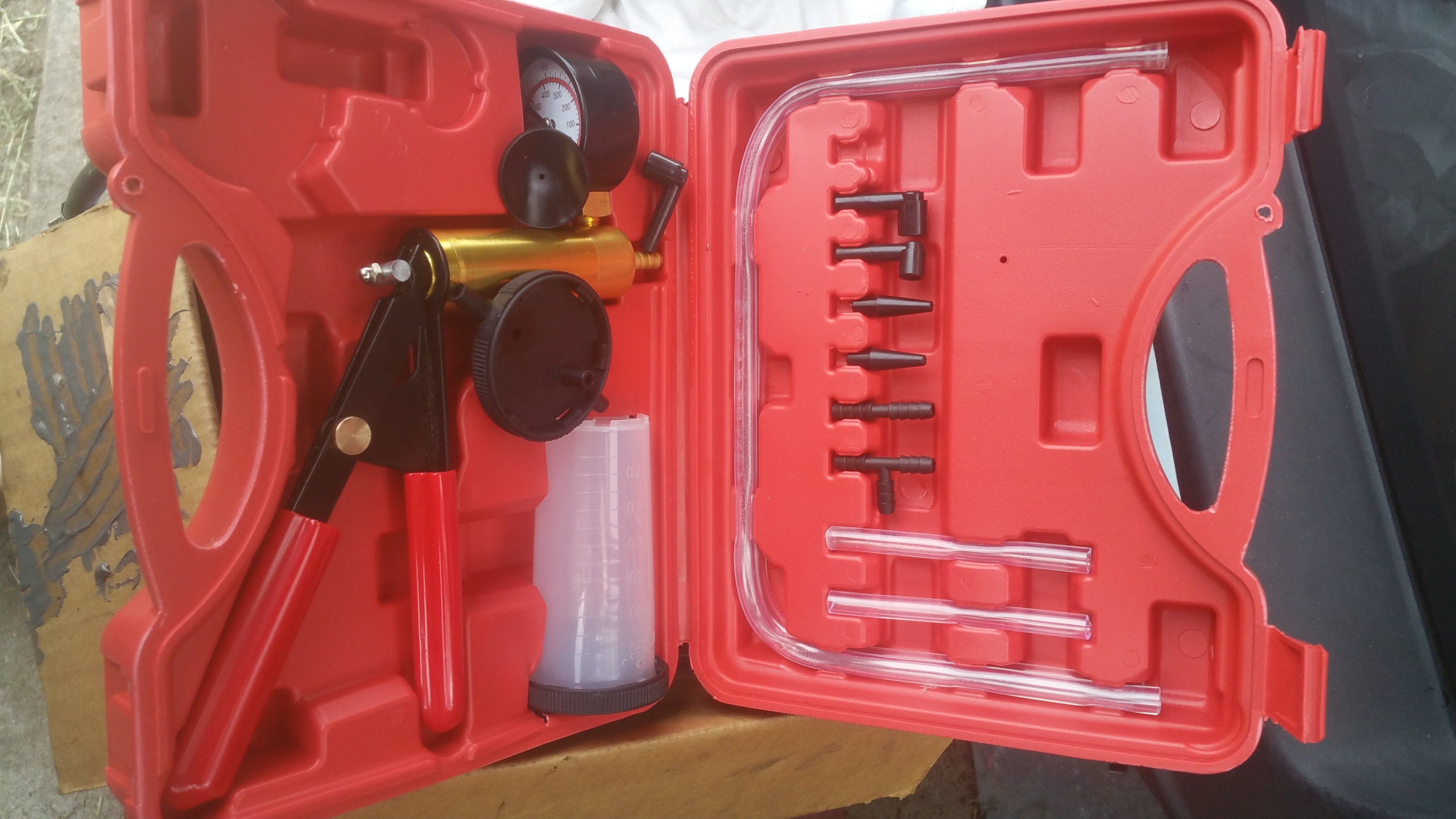

So one of these is on the way: Too bad I get "Error parsing server" when I tried to add a pic

Picked up one of these vacuum hand pumps for $25 inc shipping and after evacuating/bleeding at the wheels 4 times with the brake pedal depressed, performing a rain dance and exercising demons from the car it finally has a good pedal.
