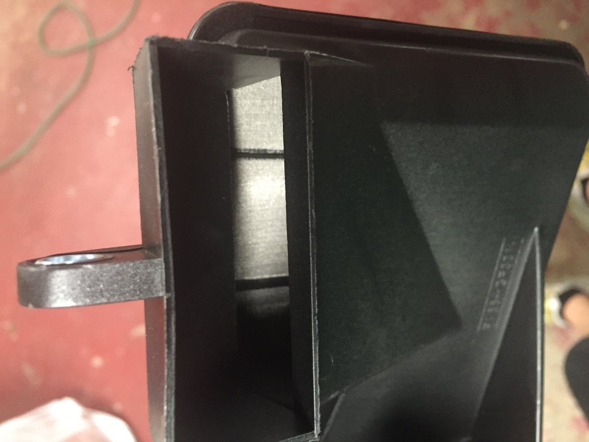

I'm positive that is a nylon mesh. The photo makes it look more reflective than it is. I've touched it and it is not stainless steel.
New filter
New filter

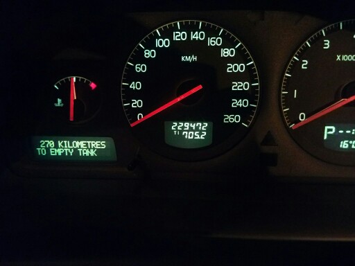

Still chugging along
25kms achieved.
I might start to take it out without a trailing wife.

Have you got the inline filter in Mike?
Looking good. I hope this works out. If thing go well today and business isn't crazy, I hope to have clutch and engine back on the subframe today.
