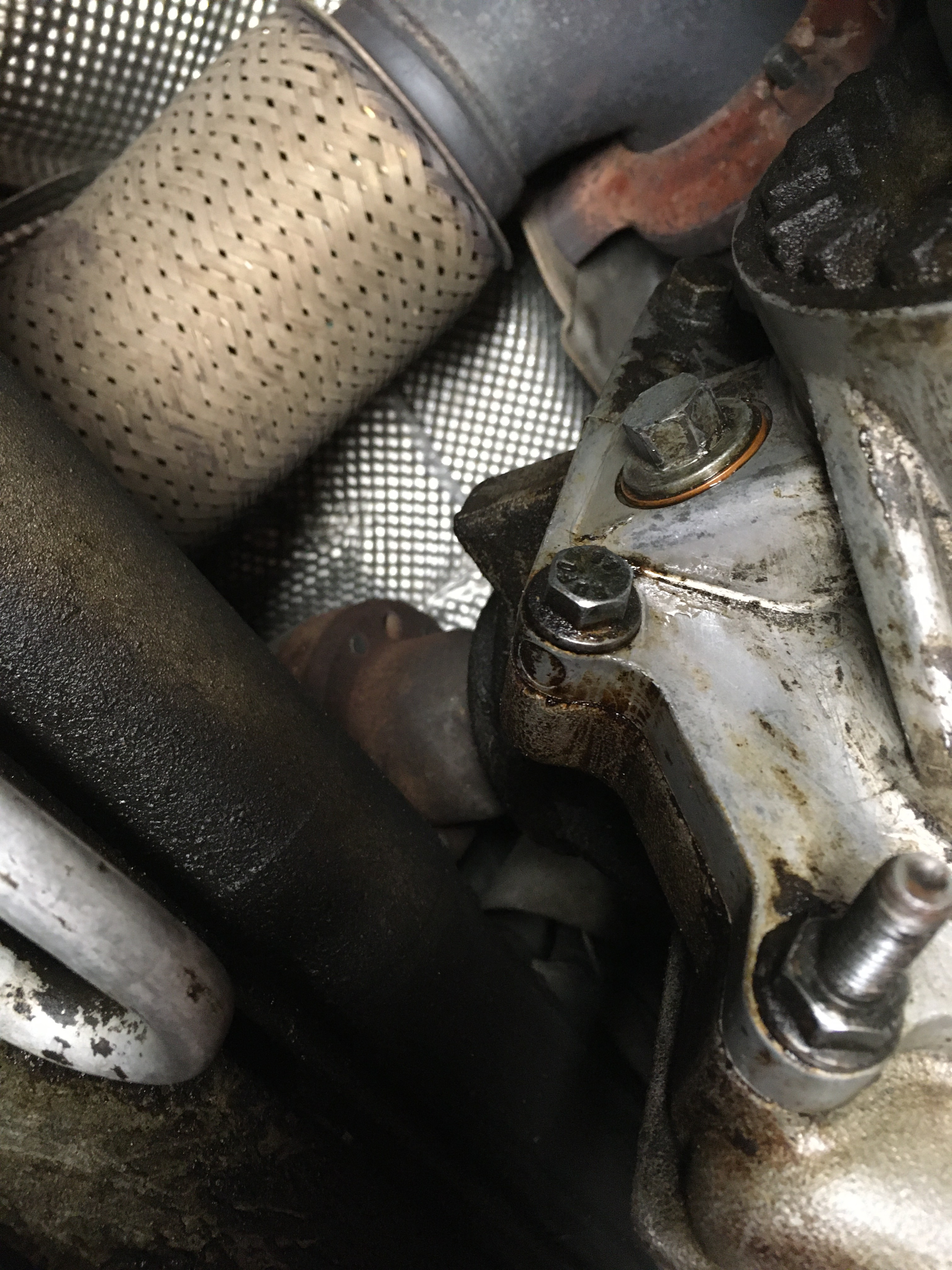

It's on and just snug, thanks. I am the Overtightener it seems. My sons bring this up sometimes.
So this can be done without taking off the intake. Disconnect the vac hoses on the left / drivers end of the intake, pull the plastic intake pipe to the airbox, put a light upside down low, between the cables, hoses, and starter, plus have a little flashlight.
Reach in with your chest on the airbox. Pretty much one hand. I used a tiny 1/4" ratchet to carefully turn the clamp screws. You can also look down through the intake gap between the #2 and #3 runners to see what your fingers are doing. Place the clamps so you can get to the screws to tighten. I used a very very long screwdriver to hold the clamps (from above) where I wanted them while tightening.

No pressure on the pCV so as soon as the clamp squeezes the rubber hoses, you stop torquing

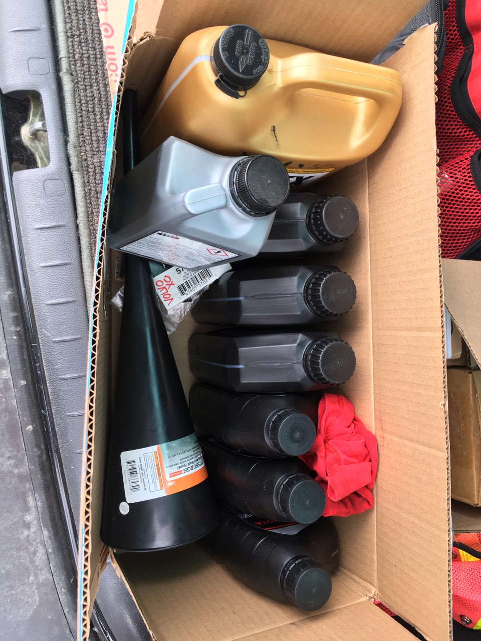

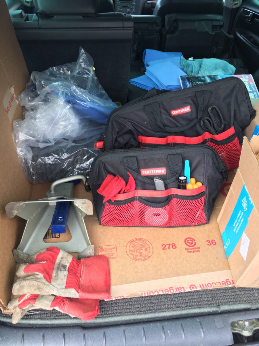

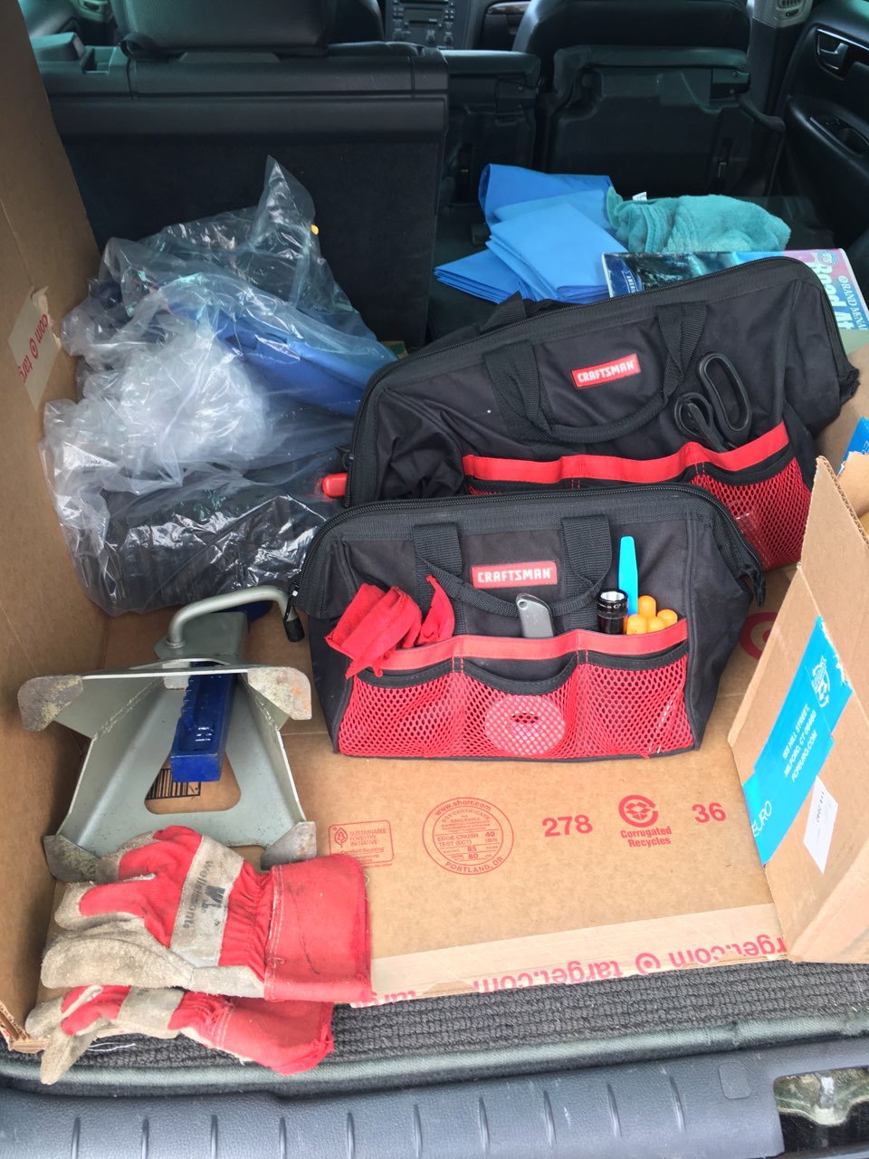

Well, I am back and very pleased with a flawless performance from Betty the Volvo! Only checked the oil the whole trip. Did not touch the 90 lbs of tools, tarps, wheel chocks, jack stand, plywood, greasy old clothes, or spare fluids!

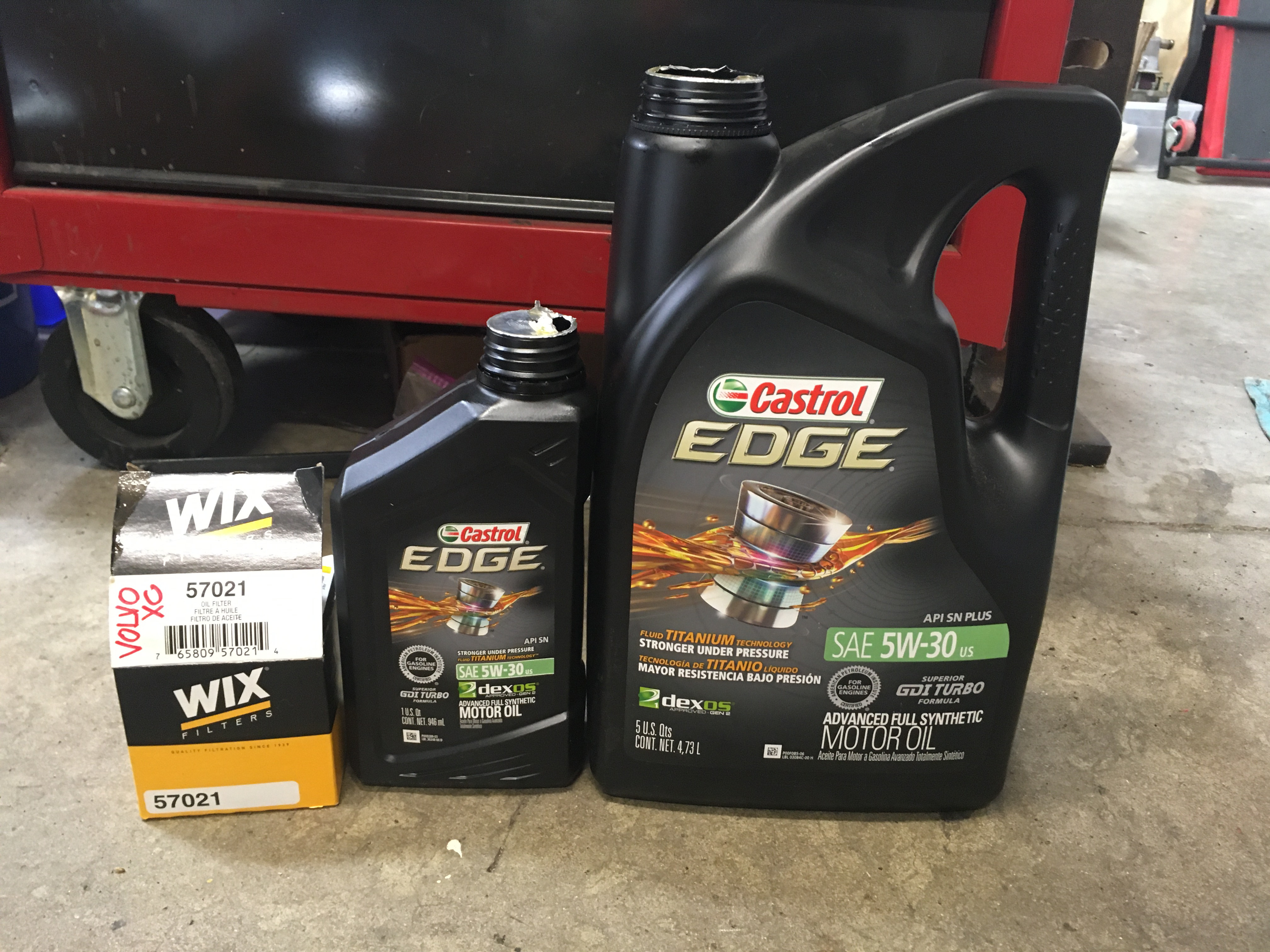

The night before (I know, I know) I added a half liter of ATF after it has settled from a couple of days driving around. Pink on the dipstick. I replaced 7L total, just drain and fill. I checked the angle gear oil and it appeared full. Brownish, but not bad. I pushed a tube down into it and pumped new oil in and let it dribble, maybe mix a little new in for now. And I replaced that lower engine torque mount, which is so easy to do, and the old bushing was completely separated. Thanks for the quick delivery, FCP!

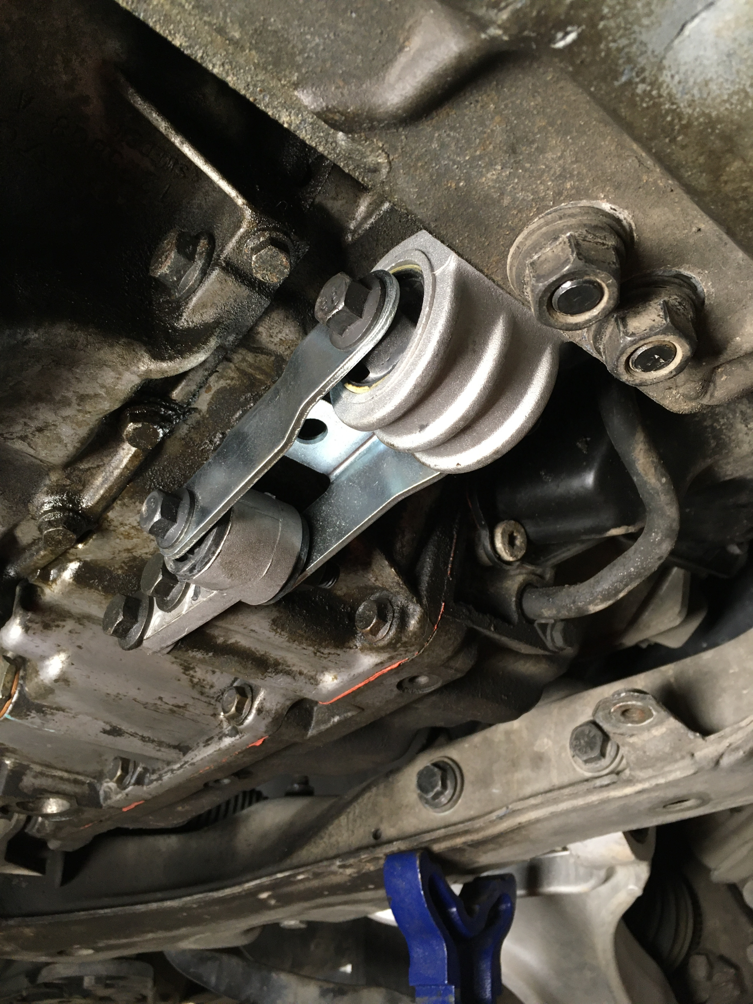

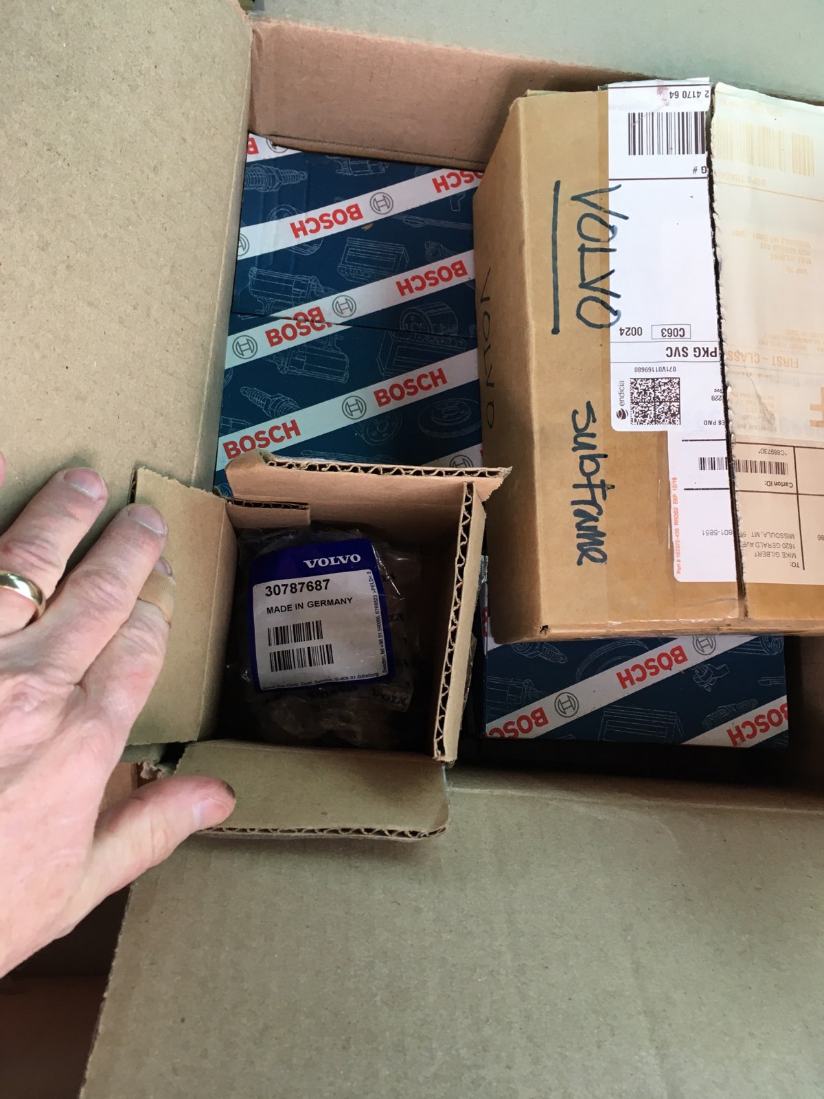

I'm rewarding her with an order from the ipd sale this past weekend - aluminum skid plate, sway bars, subframe bolts, and intercooler hose. I have the subframe inserts here, so I'll do all that at the same time.

Awesome, super glad the car did well. I'd take a close look at the color of the oil on the stick as an attempt to see how much junk broke loose being up at temp for that long.
ATF is properly checked with engine running, car in Park, on level ground & trans hot. There is but a .2 L variance between needing to add ATF and it being filled to the maximum. AW55 are robust, but you don't want to run very long with them overfilled.
