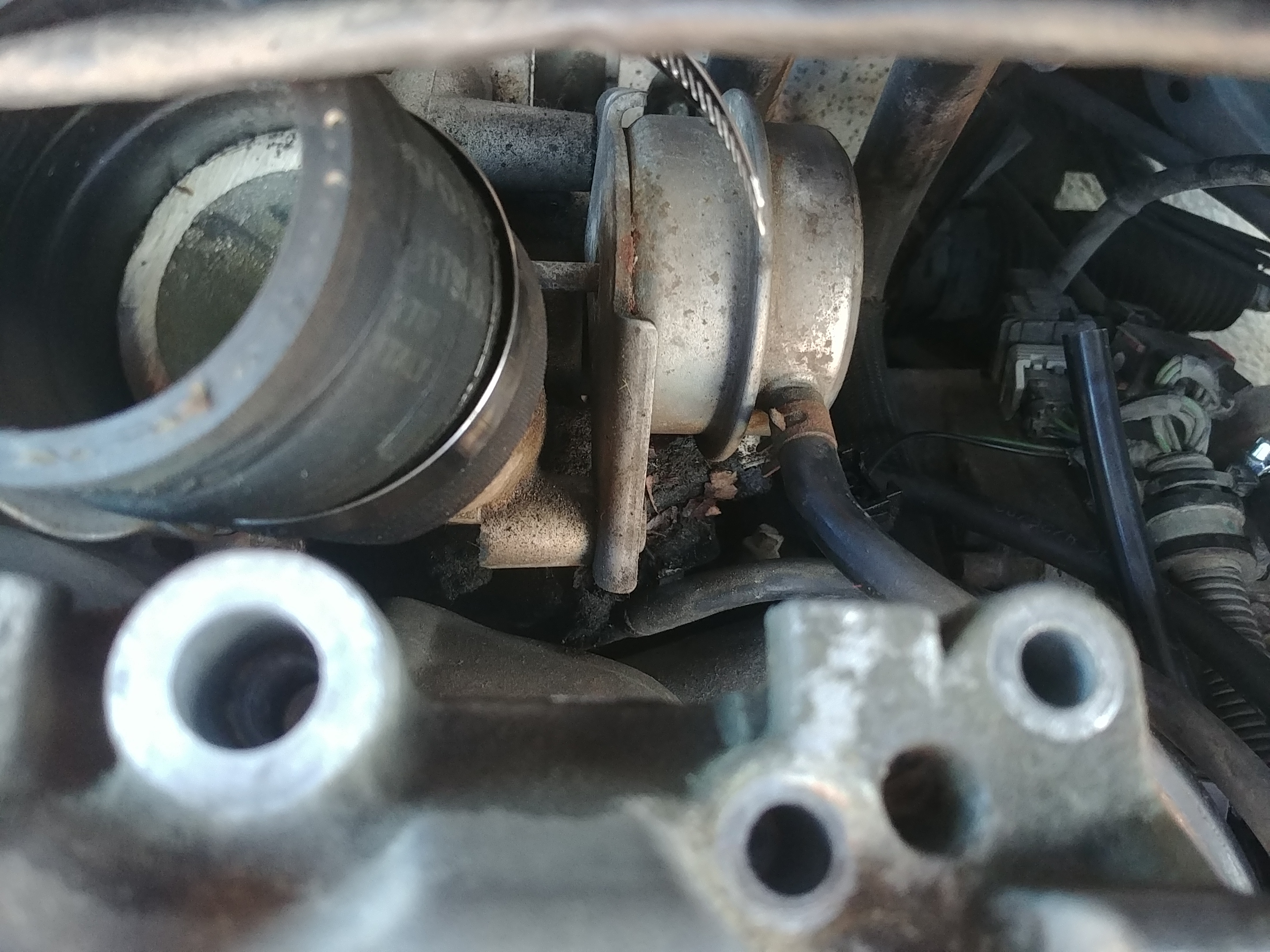

That small hose I can do. I'll check out the other underneath and probably do that too. That whole area underneath the turbo was covered in gunky oil. But why are these upstream oxs sensors so expensive. I feel like I should replace it too because I've replaced everything else. I have no clue if it or anything else besides the obvious spark plug change has ever been done to this car.
Not a great picture but you can see the buildup just up top

Ty , cover up that turbo inlet forthwith before you drop something in there

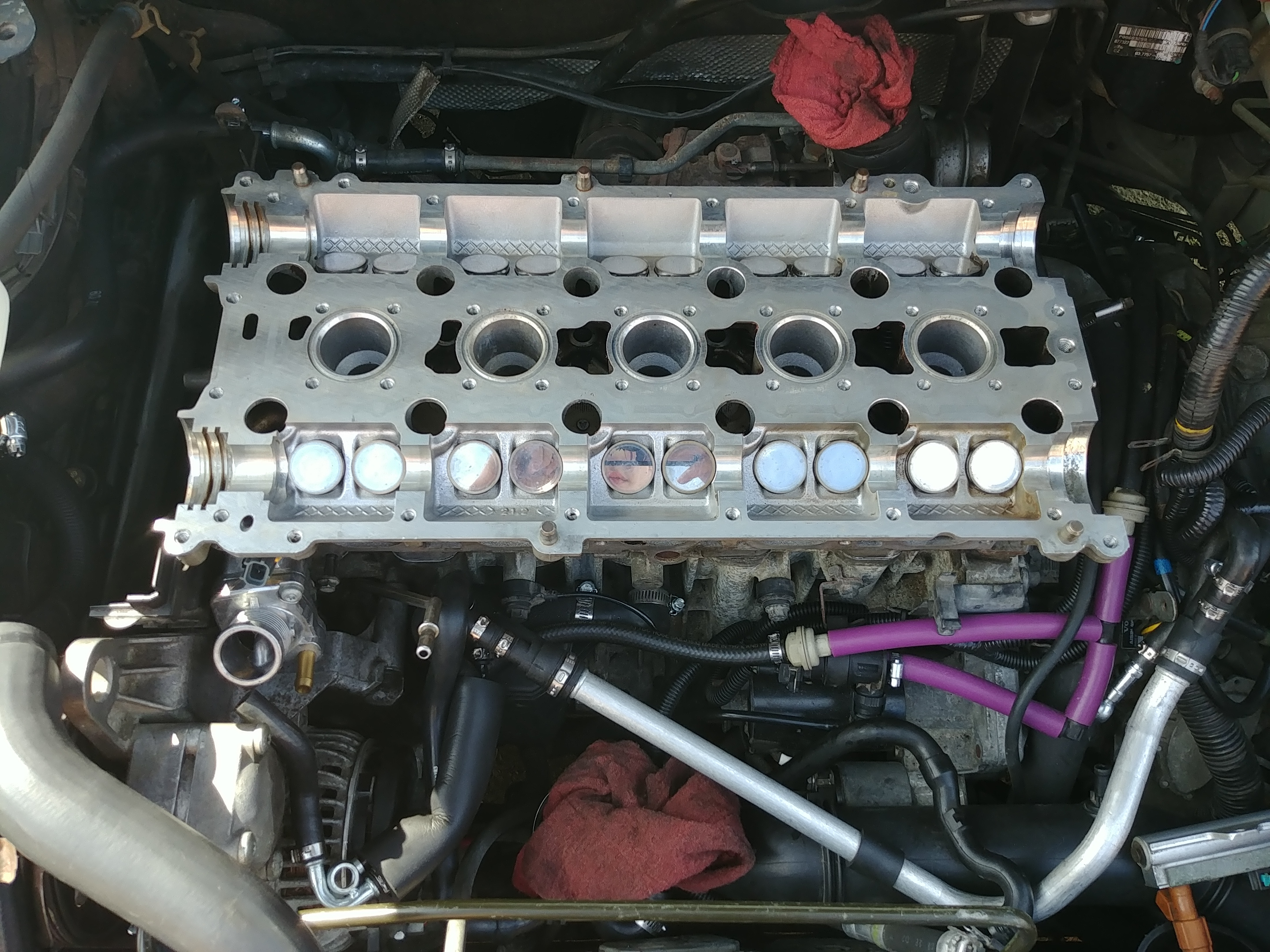

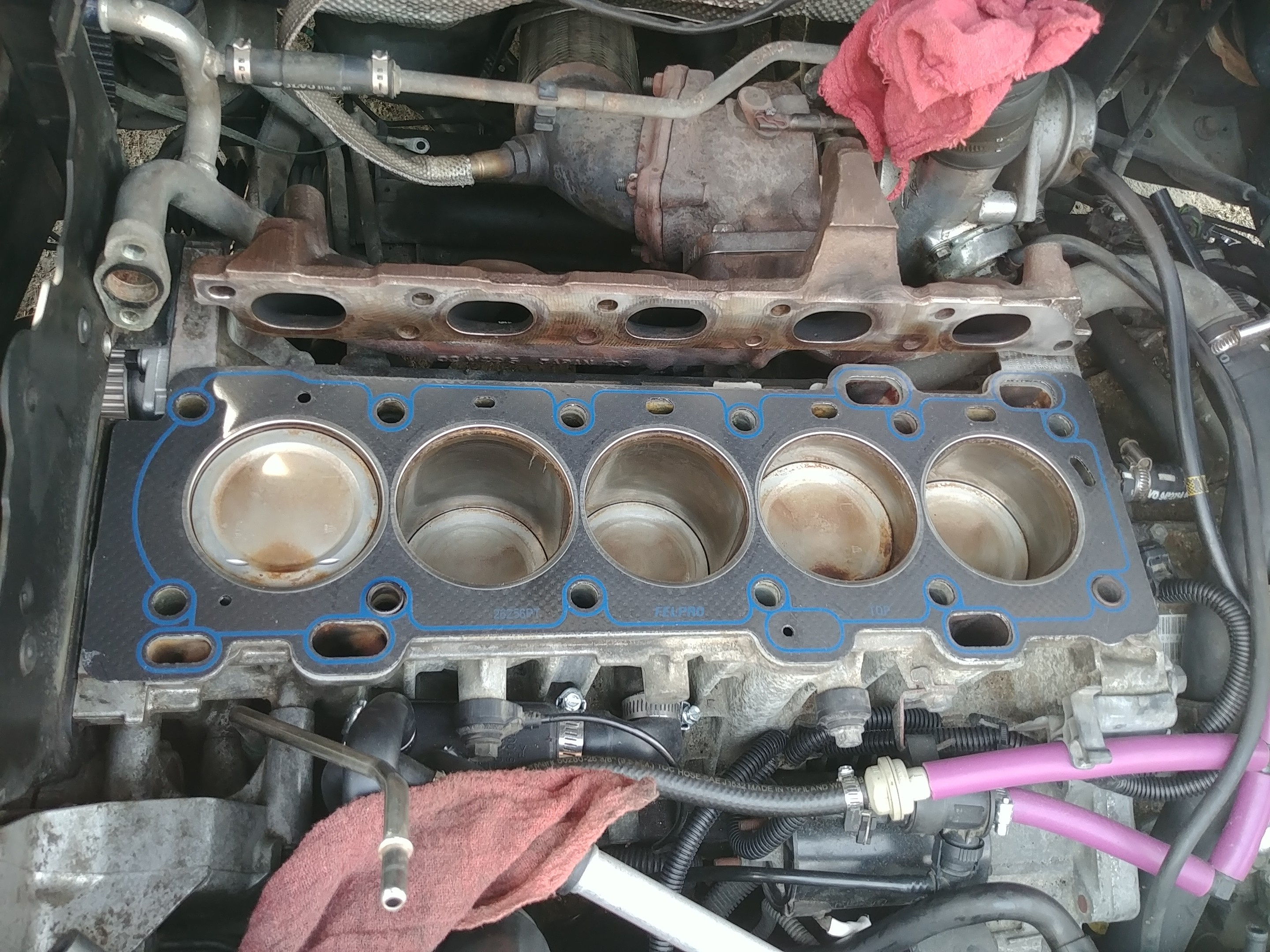

A little more progress.
Got the head all cleaned up,
New head gasket on.
New bolts used to bolt down the head.
Rear coolant line and gasket on
Exhaust manifold with new gaskets both sides
New thermostat, gaskets and housing.
Lookin good

Looking good, Ty! It’s not a race to see who get started first but youre in Second!

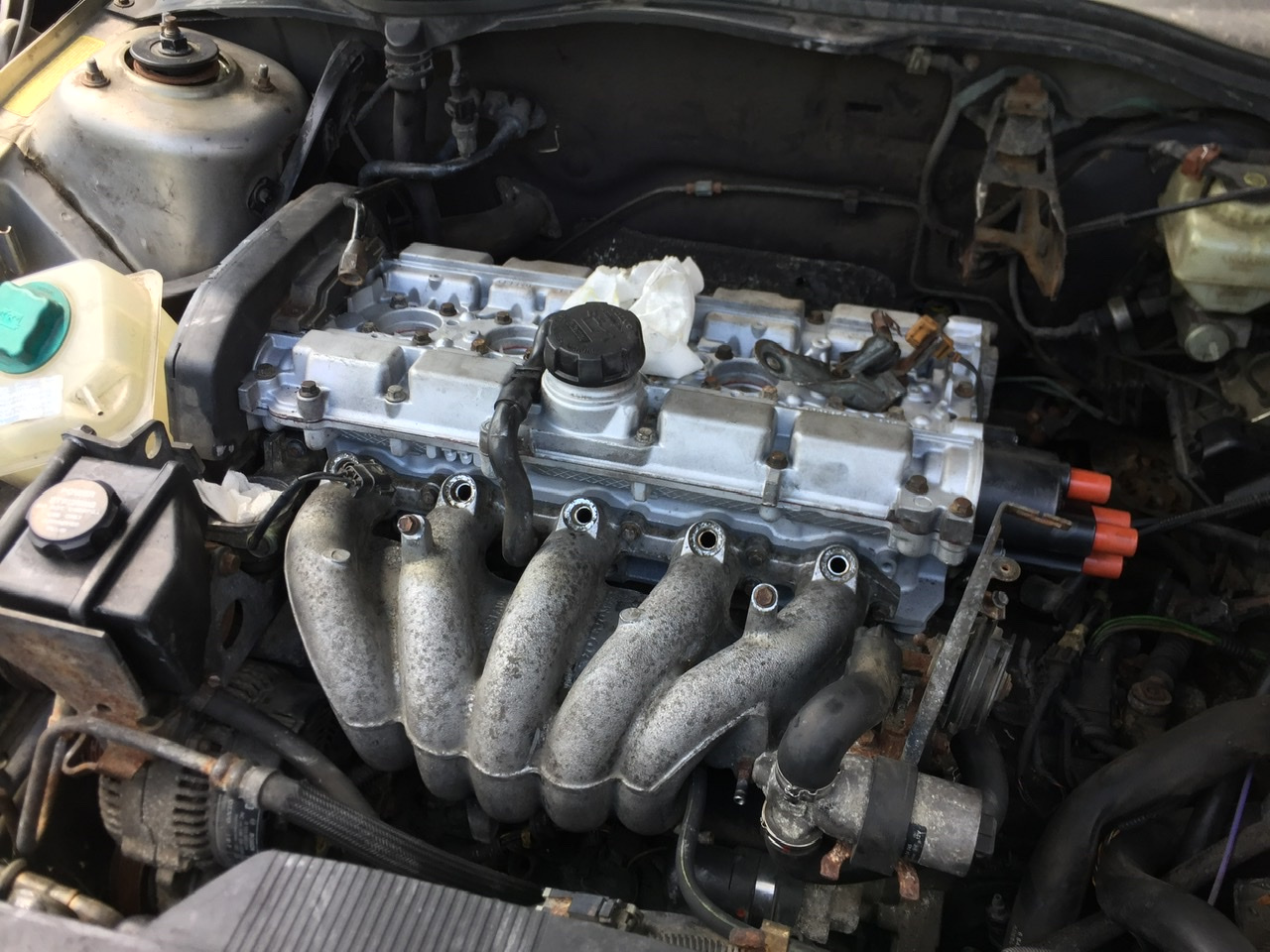

I’m at the tail end of reviving a 1998 NA from an overheat. We had the cylinder head reworked and I’m putting back together.
I’m a pretty strong advocate of,,,
Remove item
Put into clear baggie
Remove fasteners
Measure shank, head size and length
Write on baggie in sharpie
I’ve figured out that the time spent doing that is easily saved not
1 looking for hardware
2 holding hardware I my hand wondering where it goes
