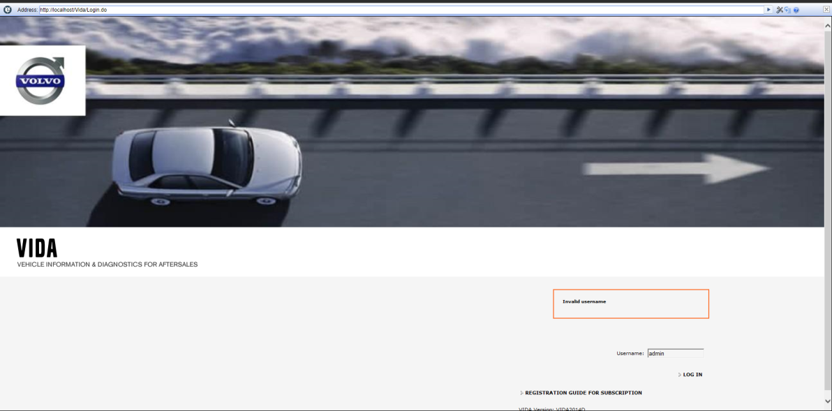

I have a VIDA monitor that runs normally, but when the VIDA login screen appears, I cannot type characters into the "Username" box at all. I can get a blinking cursor in that box by clicking on it, but it does not allow me to type the username.
I can click on the "Registration" button, which then allows me to enter any of "1", "2", "3", or "admin", and then the username box is populated and the screen returns the the VIDA login screen, but the response is "Invalid Username"
Windows 10, have the IE Tab on Edge browser, and I fear that the latest update to Windows 10 may have broken VIDA. I am heartbroken
I then reinstalled, using the instructions in this thread, running the scrips from the mounted ISO image as instructed.

Yes, I had the IE Tab installed before, and what did the trick in fixing the problem was applying the following after following all the steps listed in this thread back in post #1.
"VOLVO VIDA 2014D Patch 213064bit.exe" a license extension claimed to be "good until 2130".
"SetupDiCE.exe", a stand-alone reinstall of the DiCE drivers.
My symptoms were:
(a) No ability to type anything into the "username" box on the first page presented by "http://localhost/Vida/" in IE Tab after a complete remove and reinstall of "VIDA-2014D repack".
(b) Before the reinstall, no recognition of the DiCE device by a previously working copy of VIDA
But all is well with the result - read codes, found out that I either have an intermittently bad O2 sensor, or I have to replace a CAT at 200K. So, time for some VIDA graphs while driving.
My symptoms were:

That is not my patch. No way to tell if it is any good and I am not going to invest any time into it. That would be senseless after putting something together that does work. The 2099 patch is good to 2099. More time then anybody needs and it works.packetfire wrote: 16 May 2022, 05:14 "VOLVO VIDA 2014D Patch 213064bit.exe" a license extension claimed to be "good until 2130".
213064bit.exe is one thing that you are doing that deviates from my instructions.
I suggest you get in contact with the author of 213064bit.exe is you want to use it.
