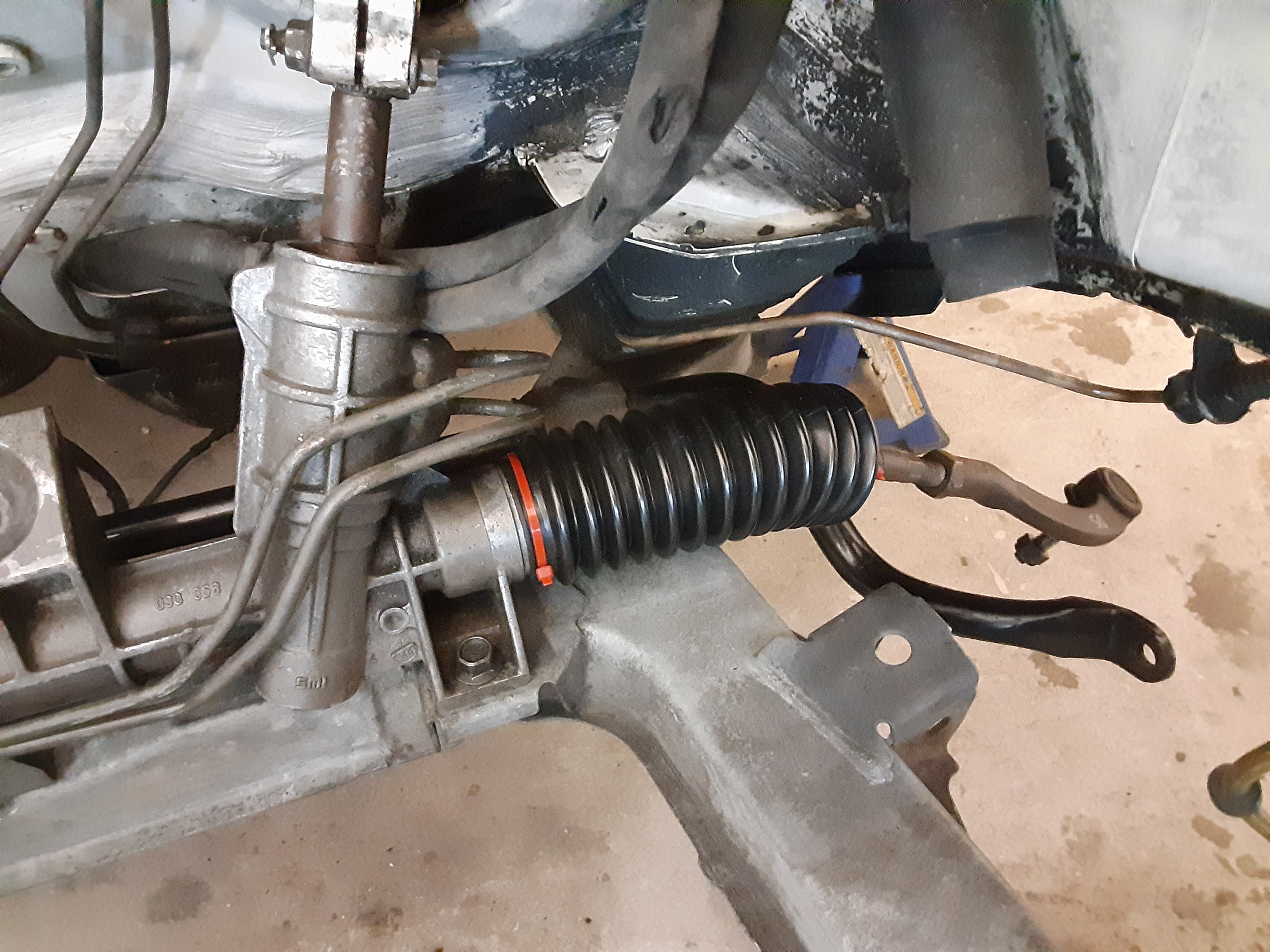

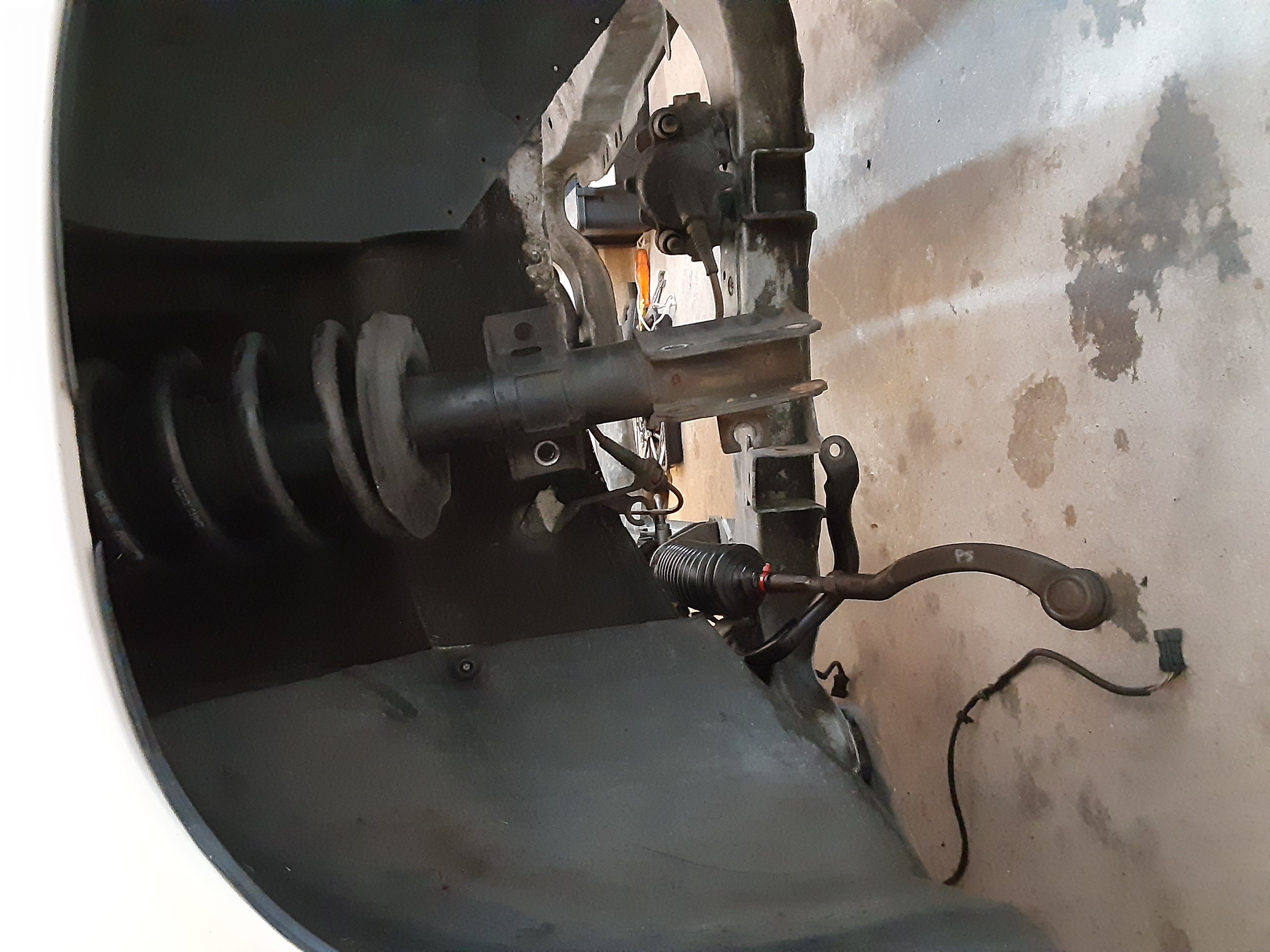

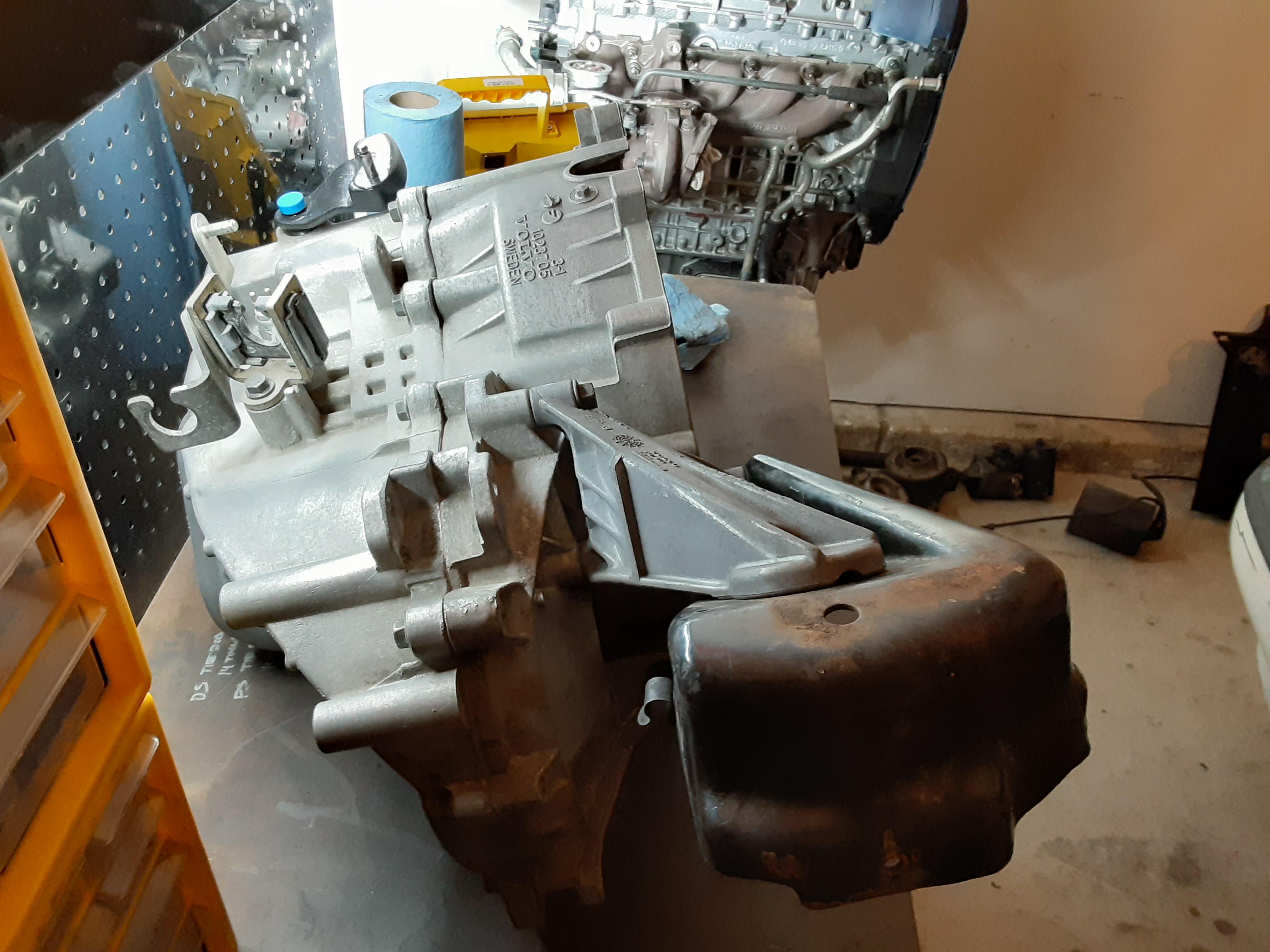

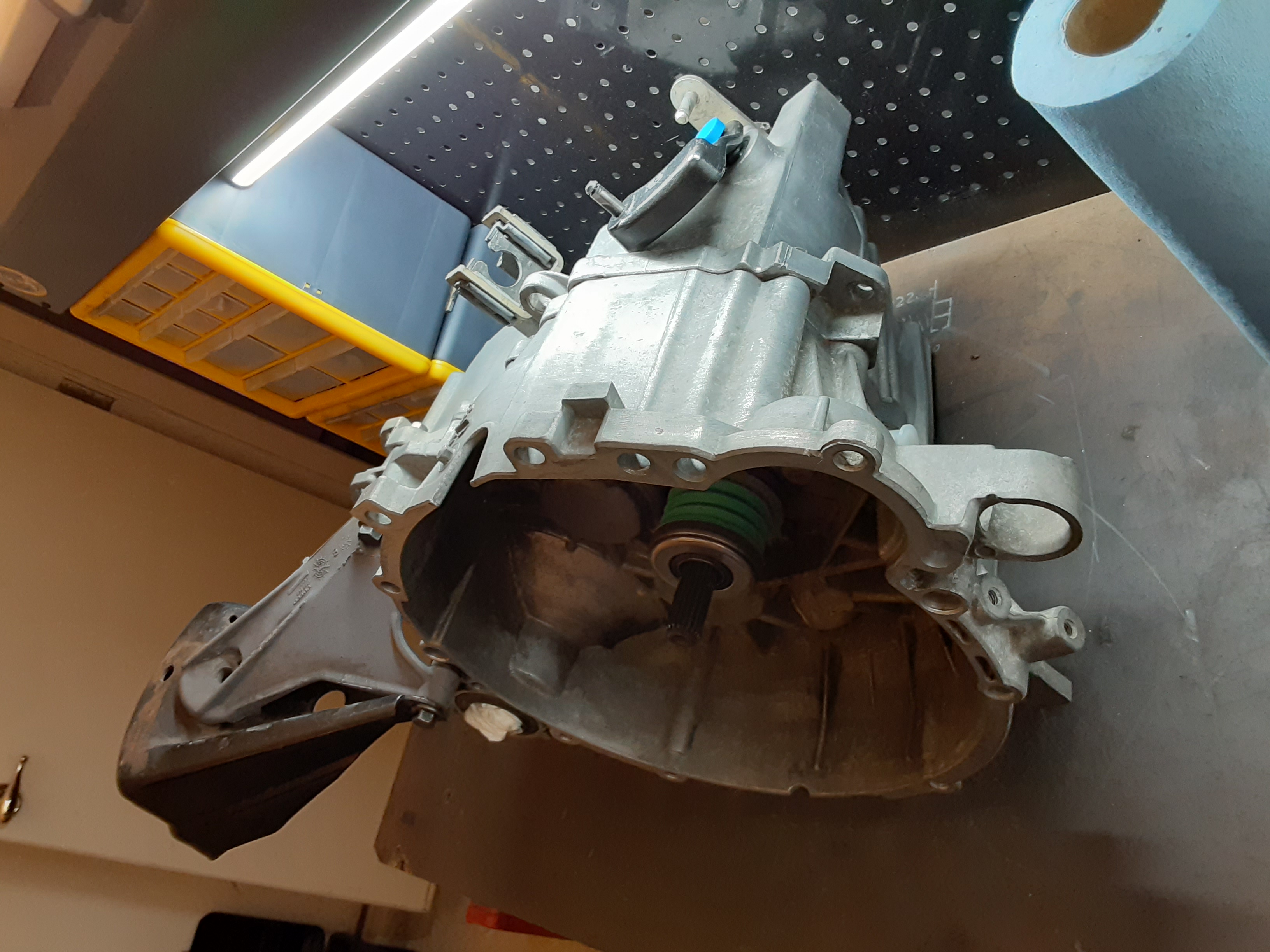

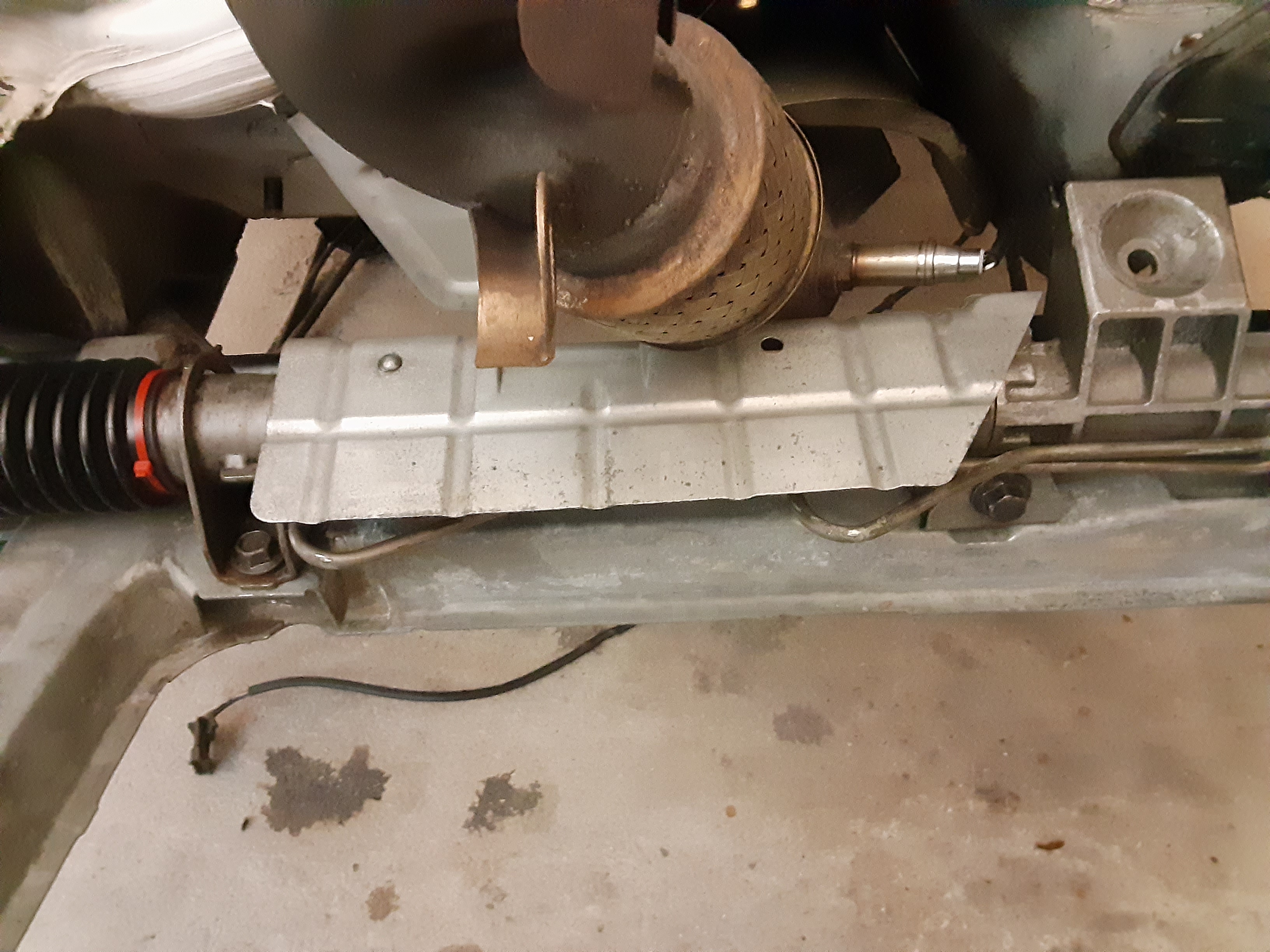

Got some more work done today.

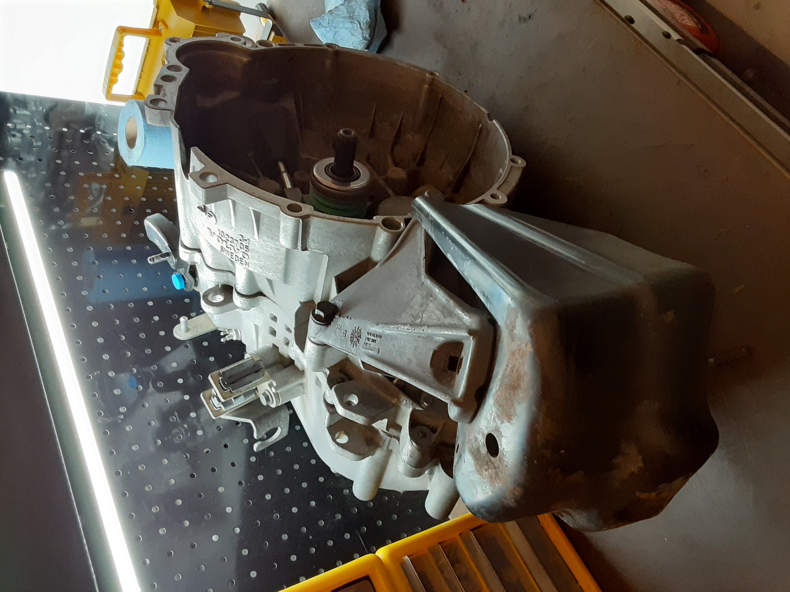

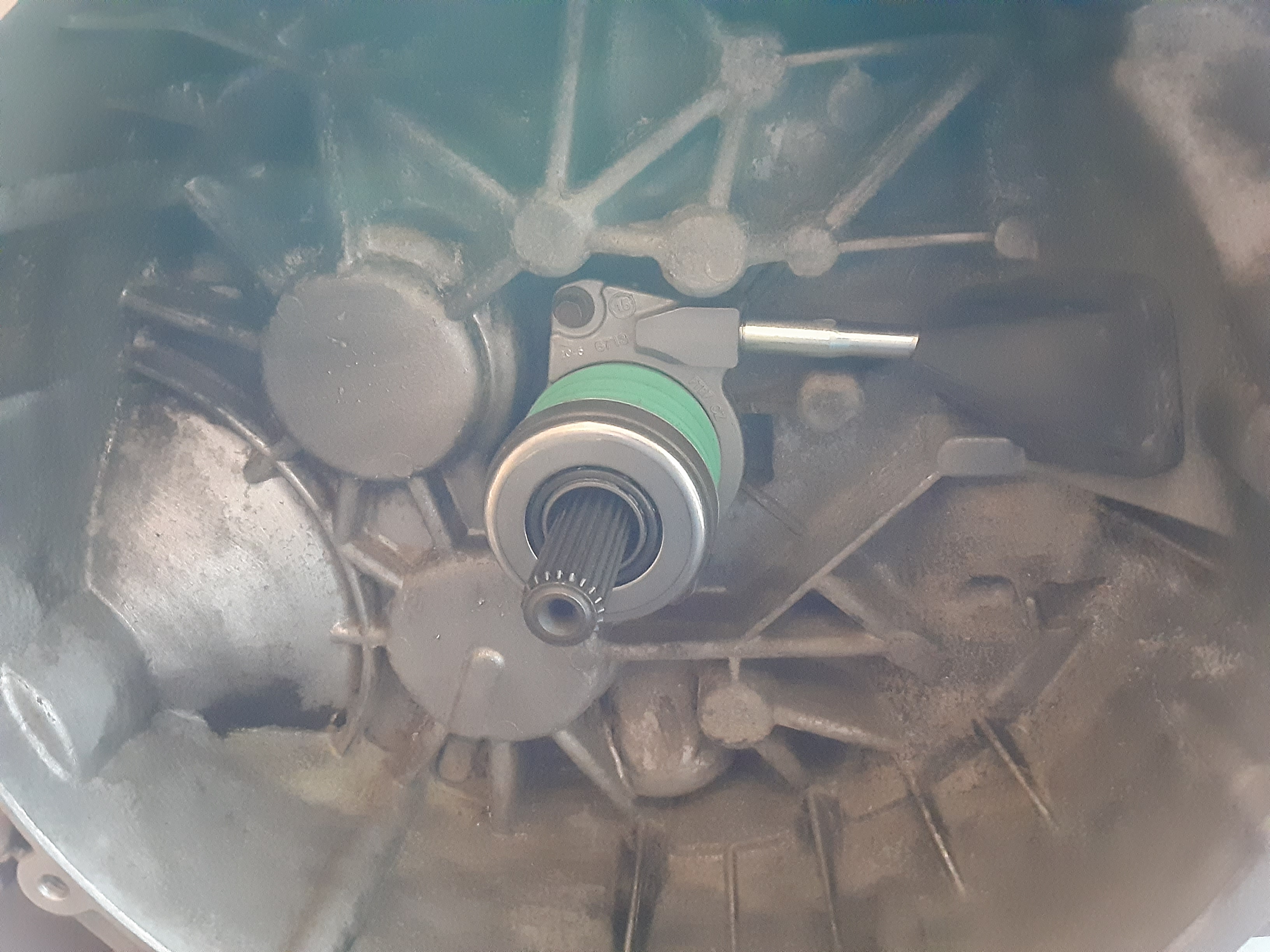

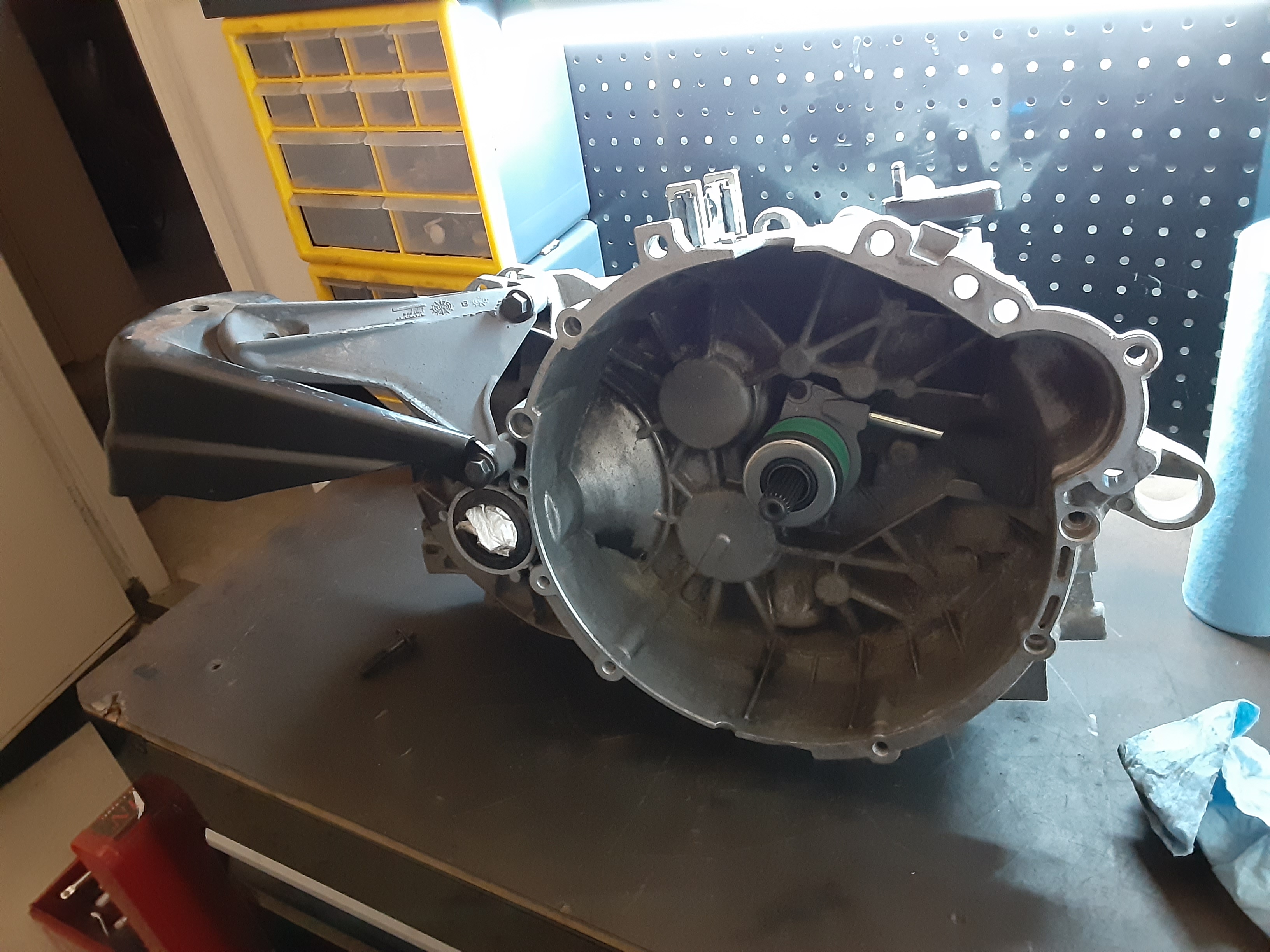

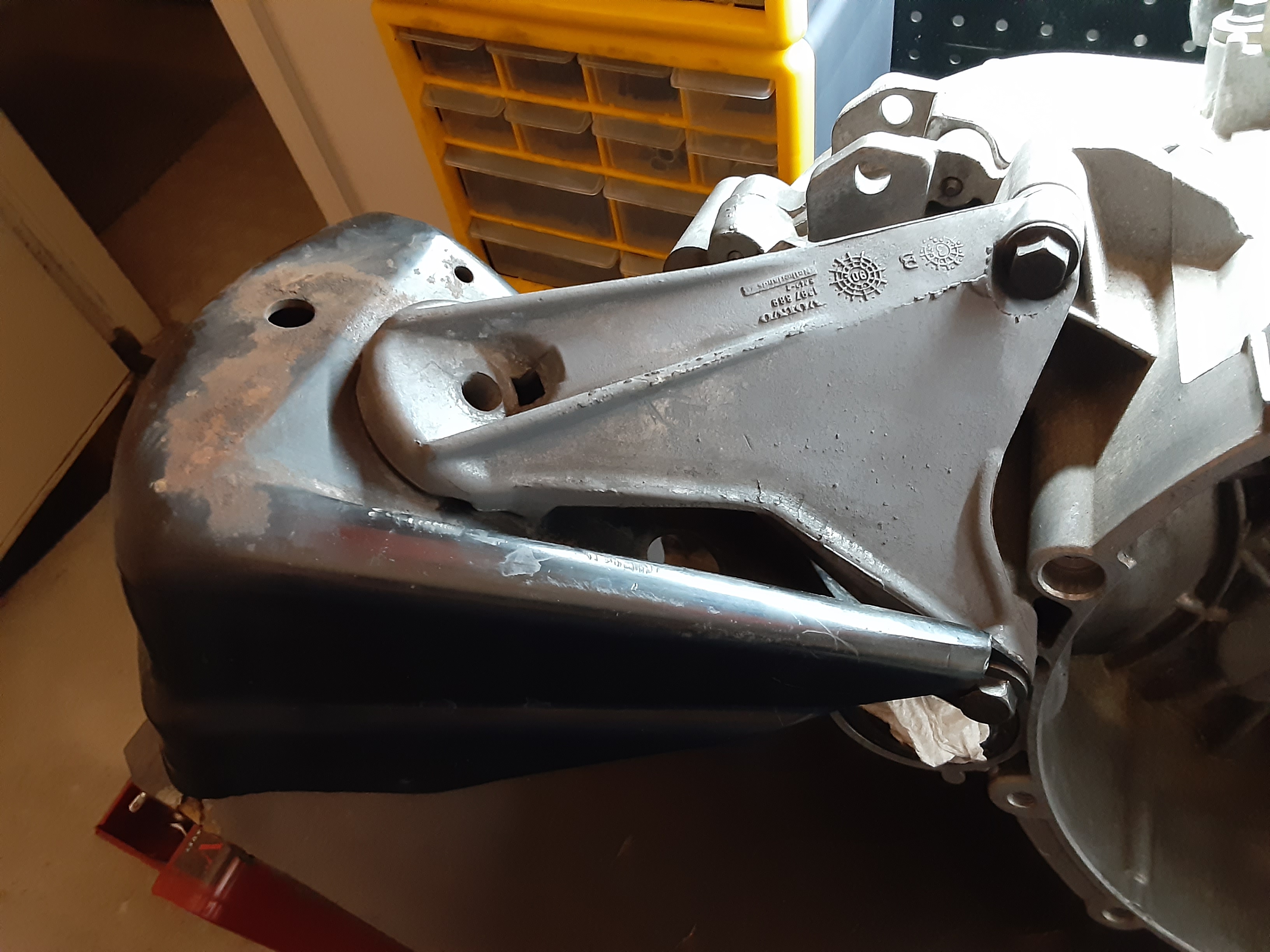

Added the throwout bearing and mount brackets to the transaxle.

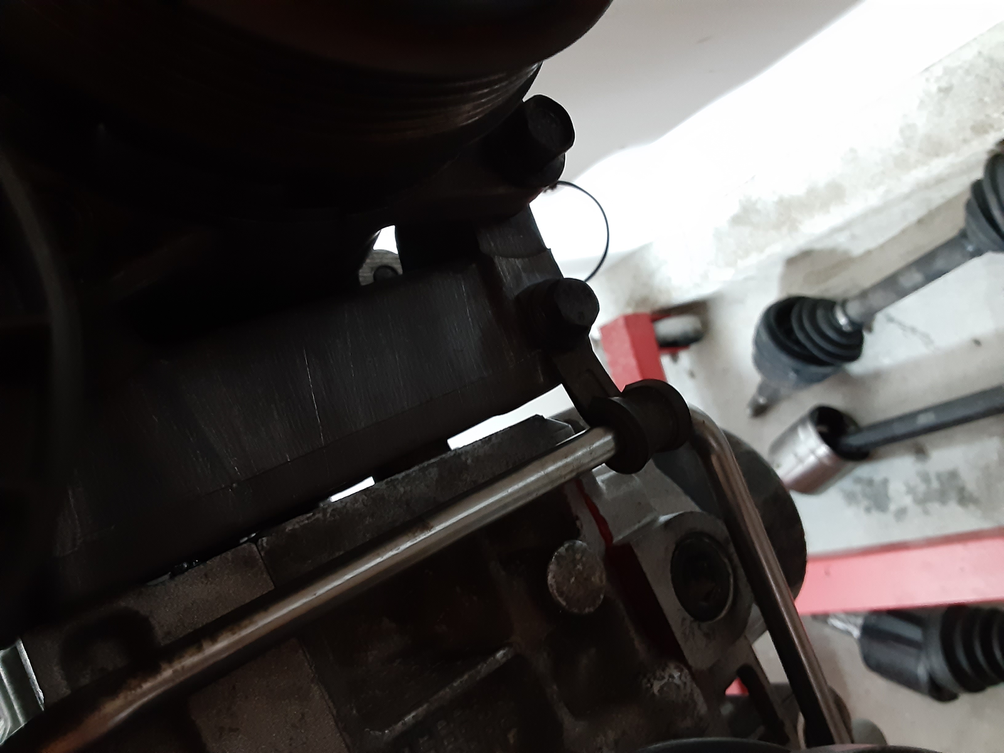

Drilled and tapped a hole for the bolt to secure the fuel line to the accessory bracket:

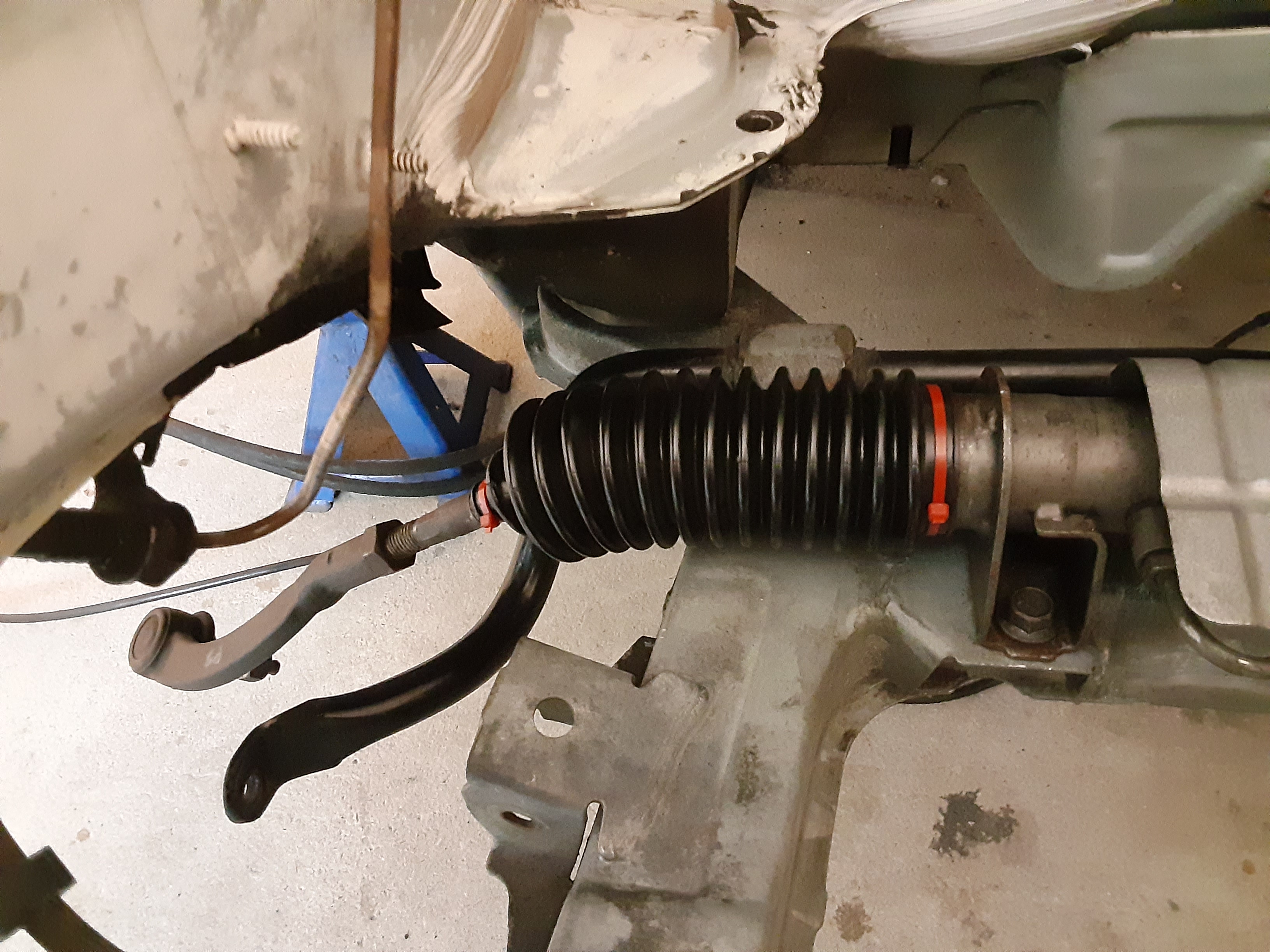

Reinstalled the steering rack boots, rack heat shield, outer tie rods and front struts:
Now that I think about it, I'm gonna need bigger zip ties on the inboard sides of the steering rack boots.

Get those rack lines started now, before you cover them up with engine. Take them to within one flat of tight

abscate wrote: 02 Apr 2022, 18:51 Get those rack lines started now, before you cover them up with engine. Take them to within one flat of tight
That's my next step. They're too difficult to get in and out with the engine in.
