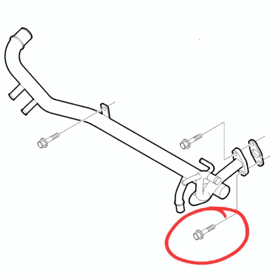

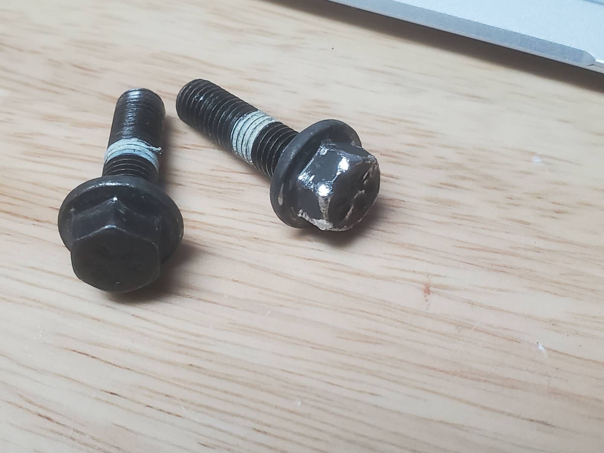

Got all the exhaust manifold bolts removed, all but 1 stud came out with the nuts. Now the coolant lone is giving me a lot of grief. How do I remove this lower bolt? I can get a 10mm box end wrench on but it's touching on both sides so you can't actually turn the wrench. Sockets will fit but the ratchet is too wide. I assume I cannot remove the head with this in place.

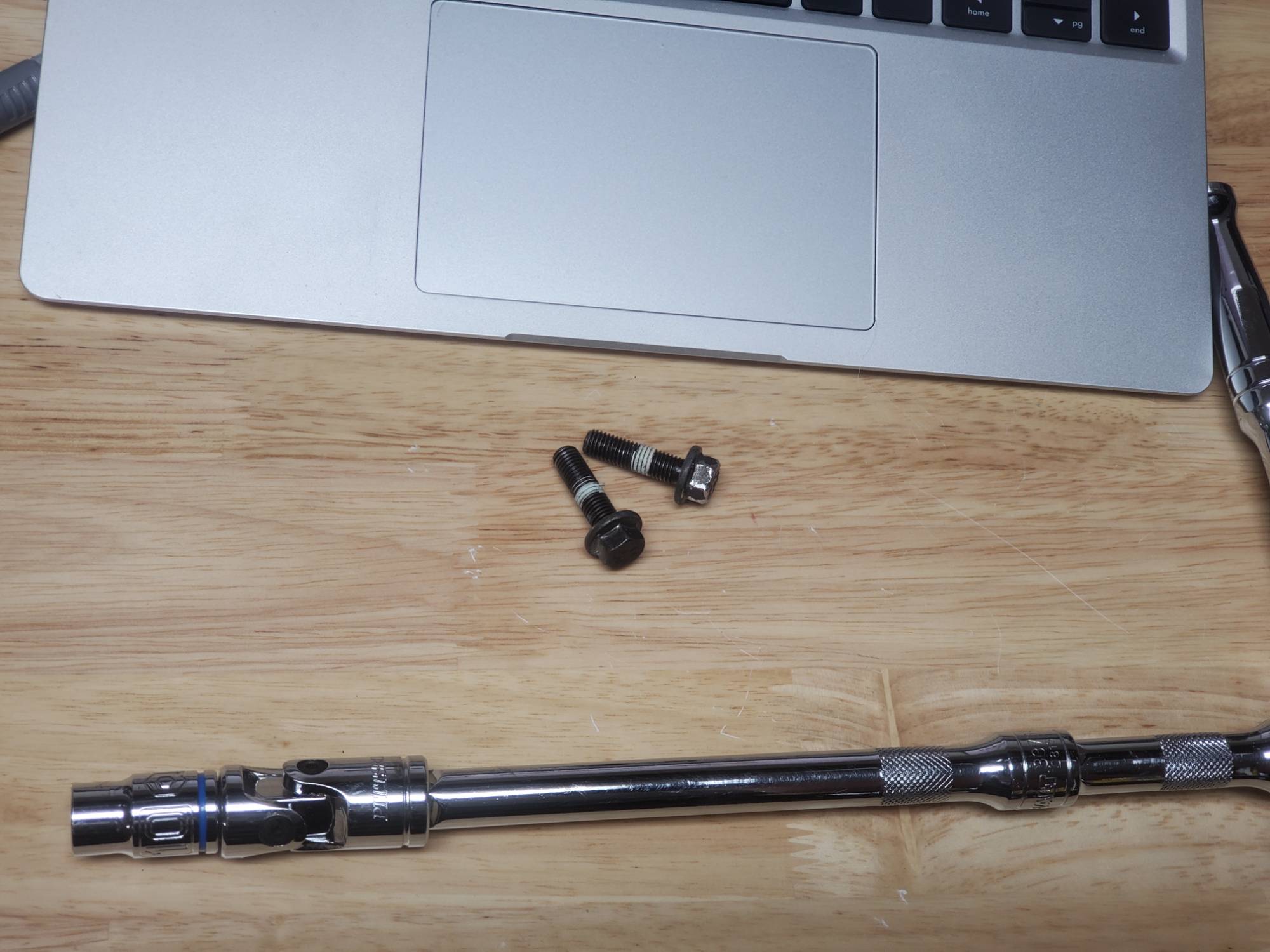

I wised up and tried a u joint adapter. Here's the result....

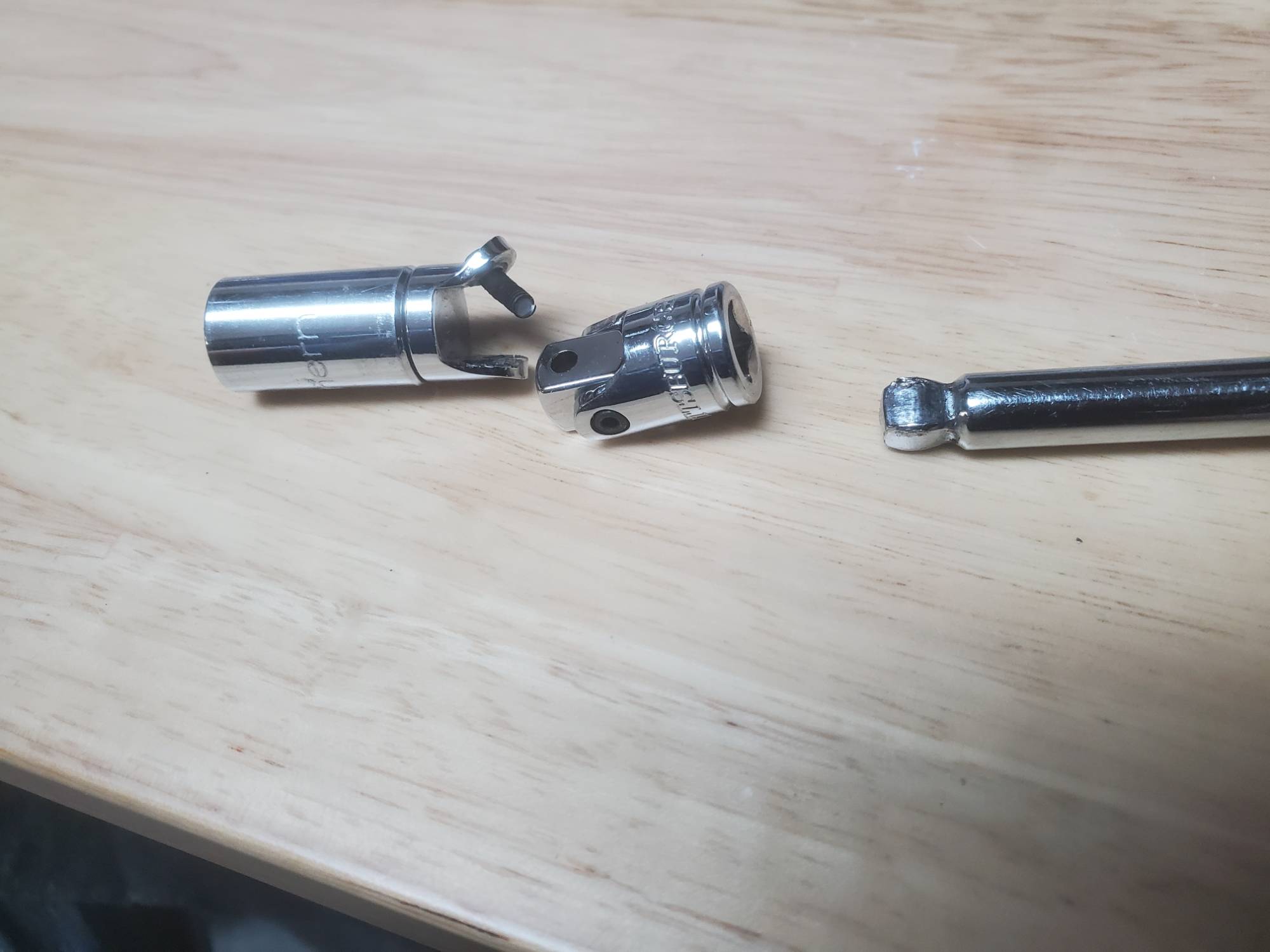

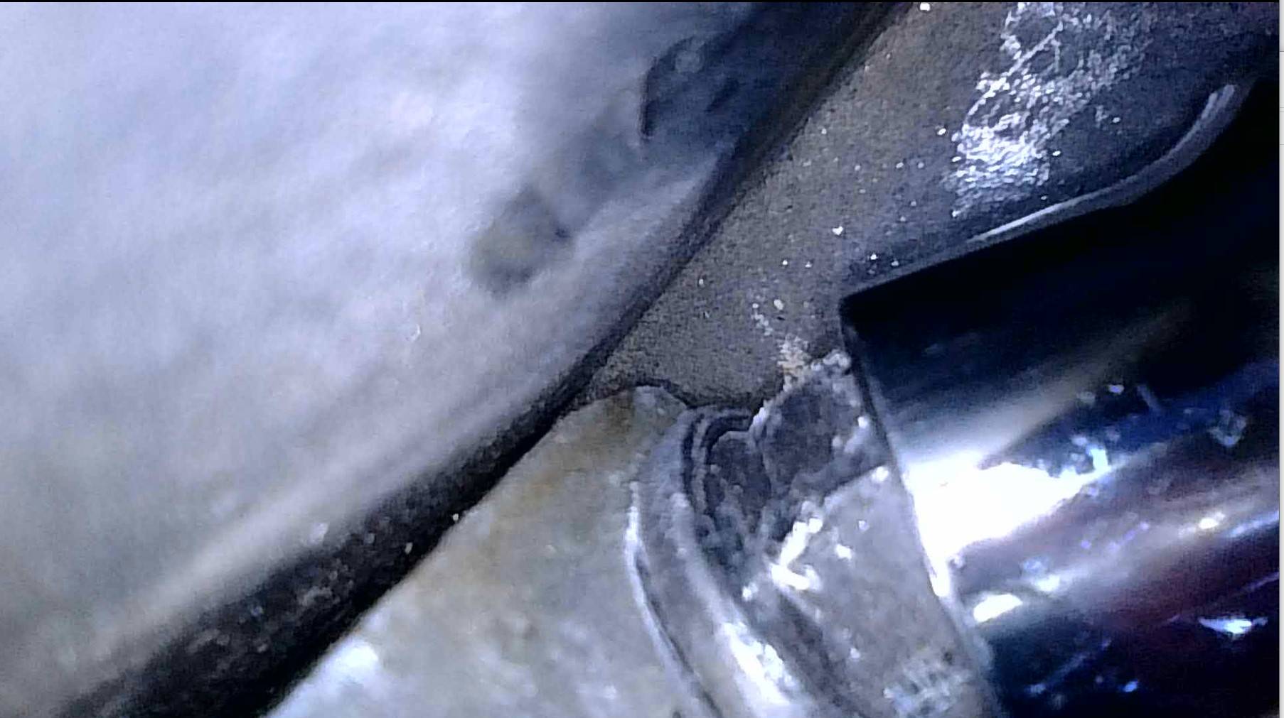

Well the good news is I got the 2nd bolt out. I had to chew the crap out of it with a 3/8 12pt since my 1/4 u joint bit decided to explode. I used a borescope to guide my socket placement and I could not get more than a 60 degree bite on this bolt head.
This was the barely winning combination.
I have no idea how I'm going to bolt this pipe back in place at the end.

Ah, the infamous water pipe M6 bolts. It’s much easier to put it in with the exhaust manifold off the car
Up the game to some Tektron sockets for that M6 , Pittsburghs and Kobalts are ok, but they will break on a tough application
Tektron, Matco, or snap on if you are loaded
You can get a straight shot on them with the right length extension. Use a six point to get a good fit

I have a set of tekton 6pt ratcheting flex head box end wrenches. I could not get them seat due the timing cover and no room to actually move them. I'm also trying to do this without removing the exhaust manifold. I tried the 6pt first but the u joint bit grenaded itself leaving me with only the 3/8 12pt as an option.abscate wrote: ↑29 Apr 2023, 18:20 Ah, the infamous water pipe M6 bolts. It’s much easier to put it in with the exhaust manifold off the car

Could you replace it with a cap head bolt, with a recessed allen head? The tool should be much narrower and might fit in there.

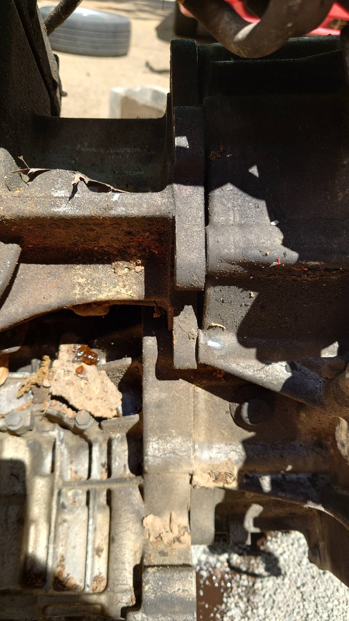

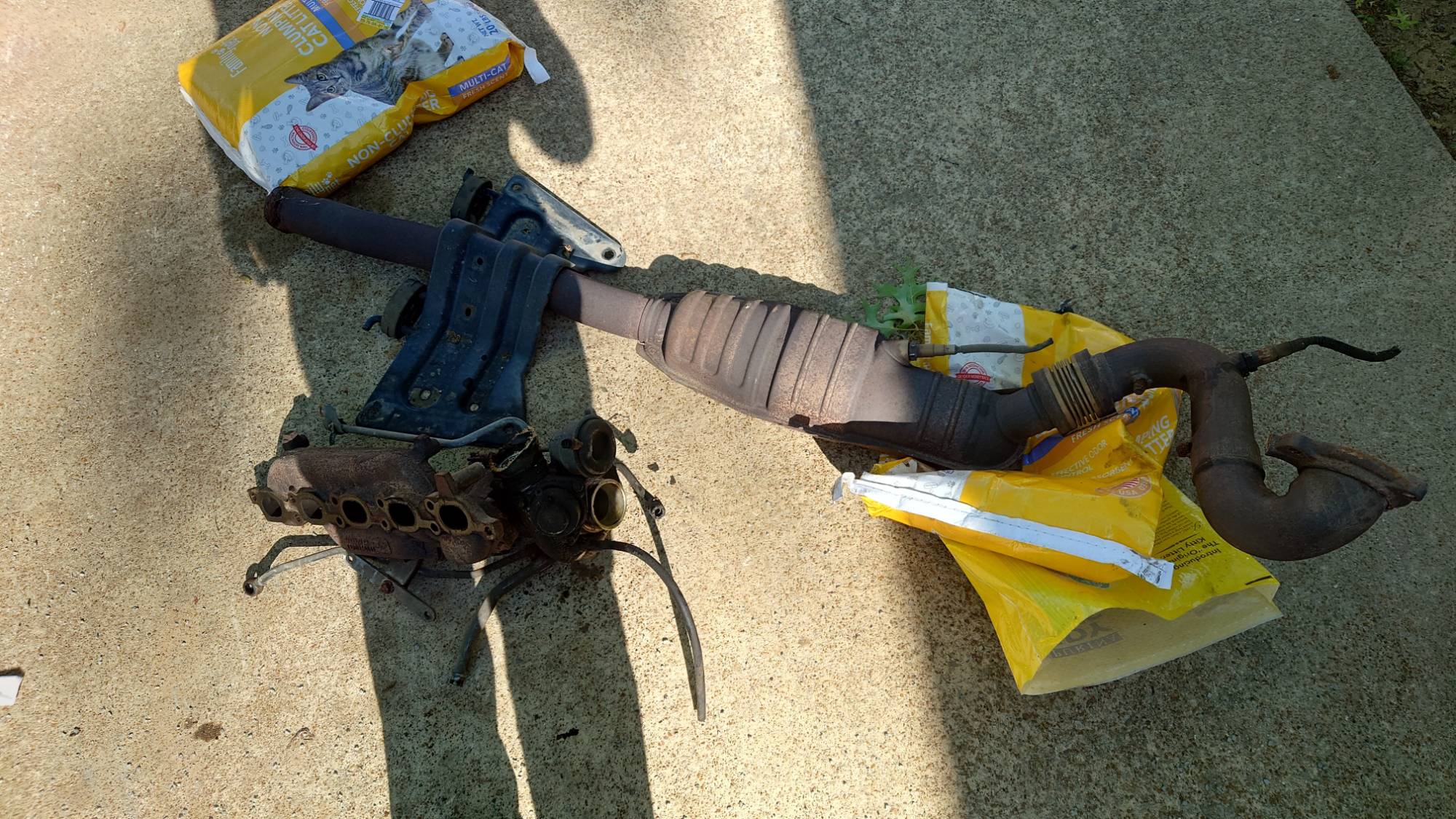

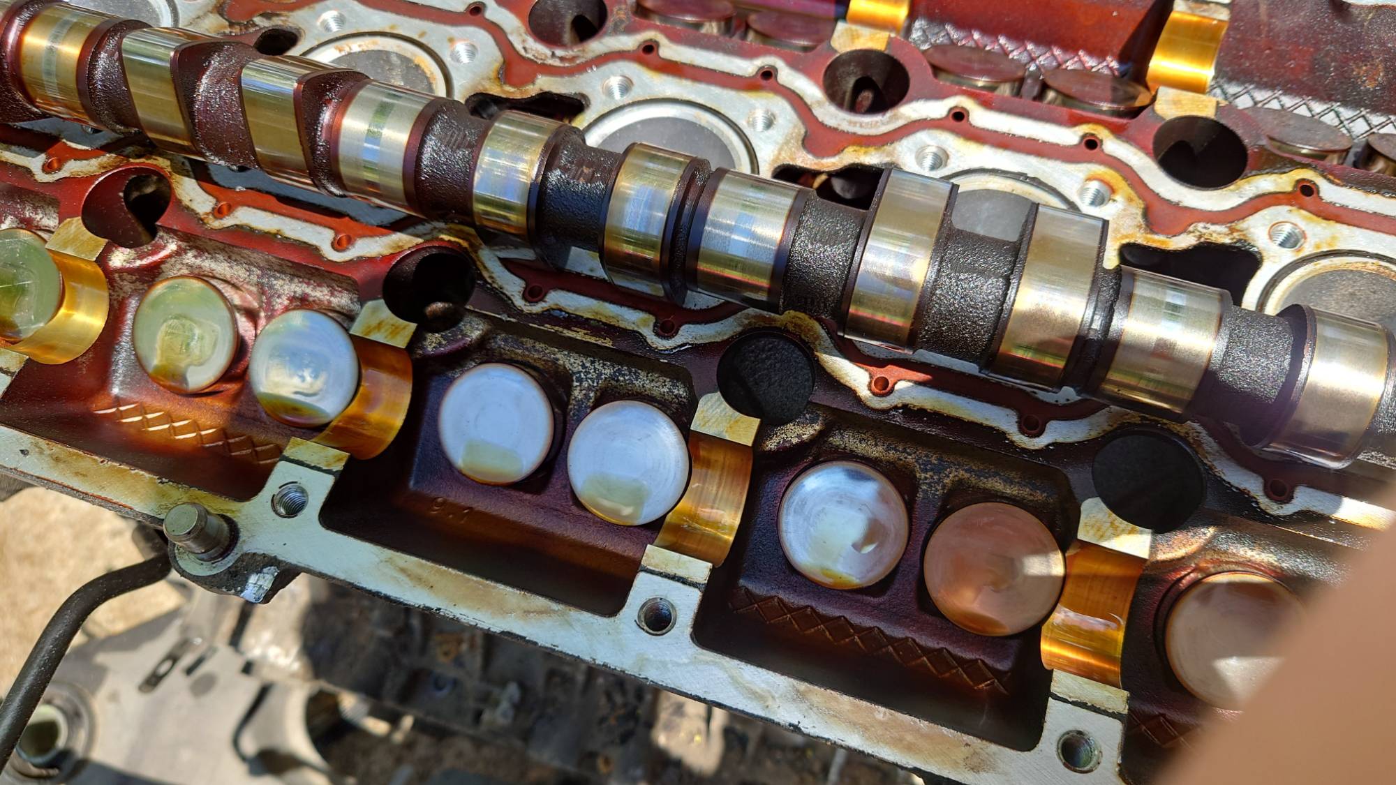

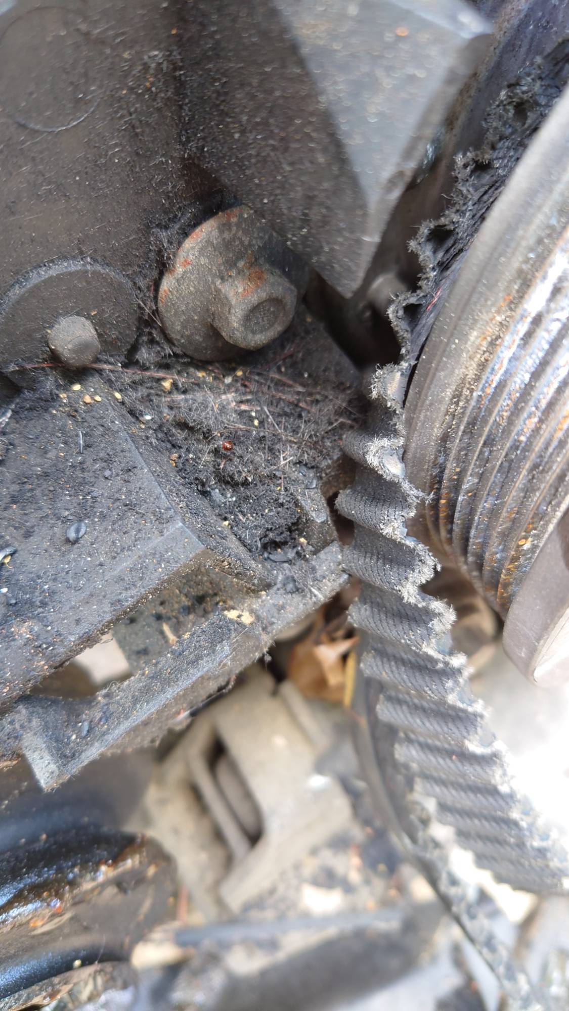

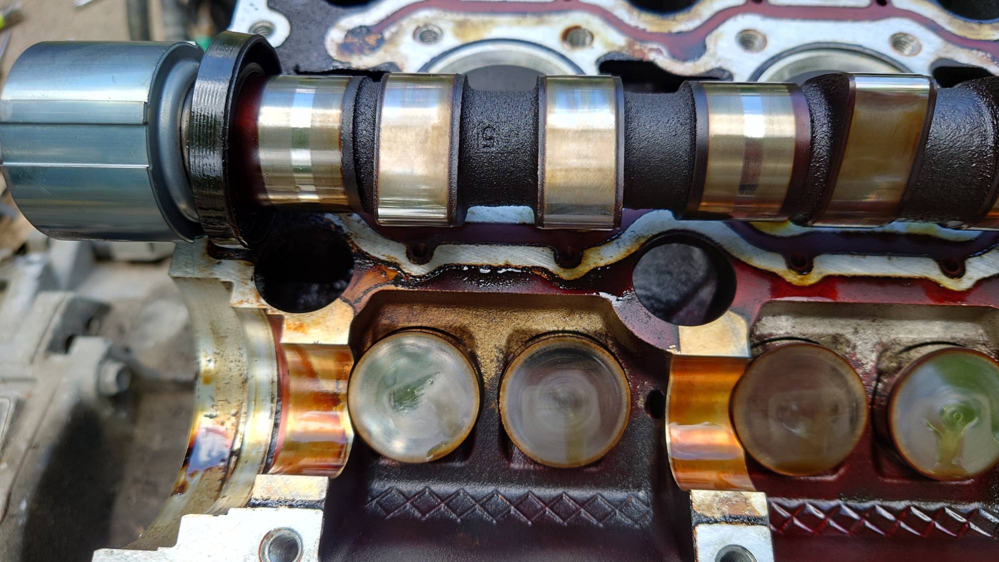

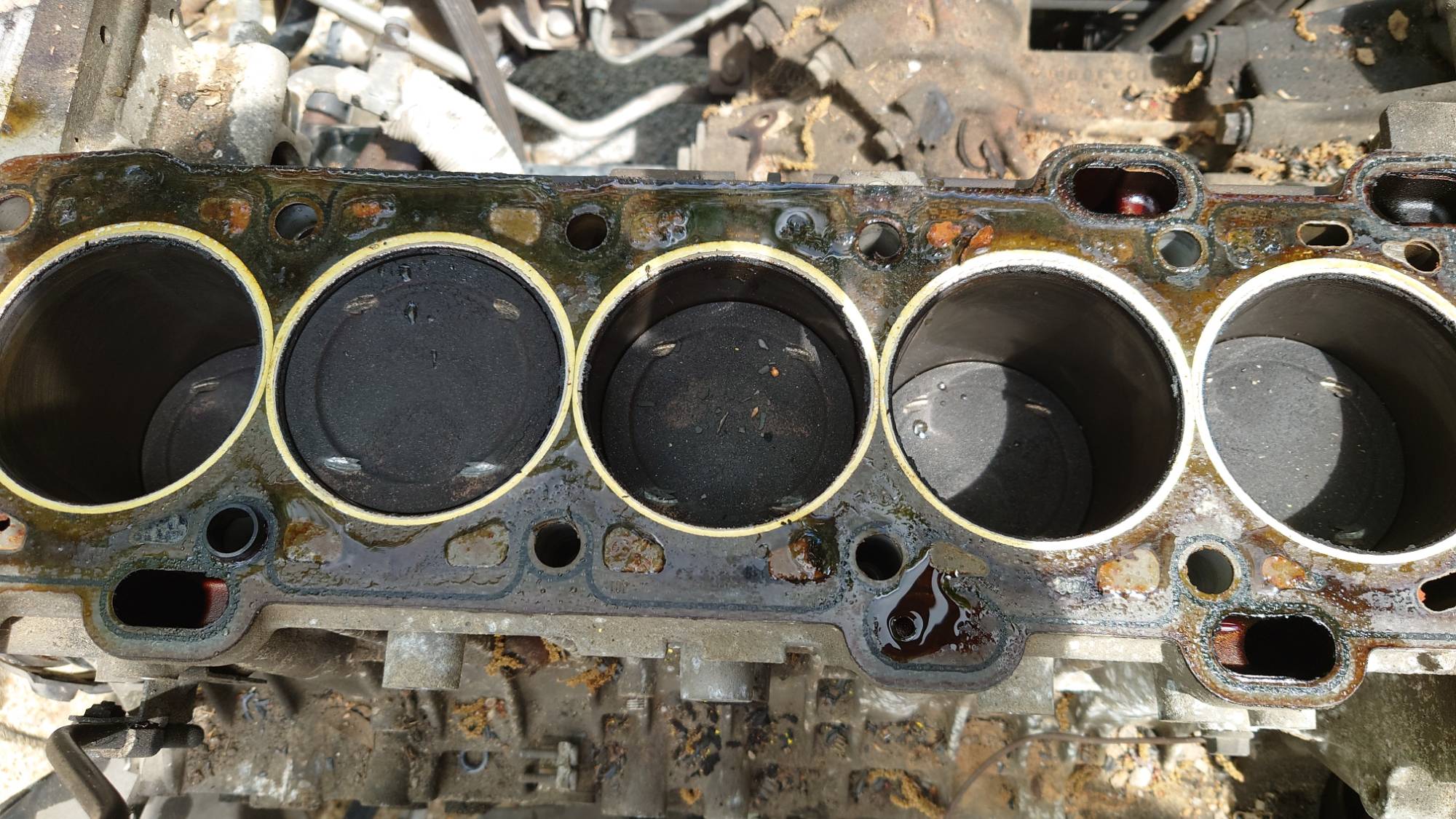

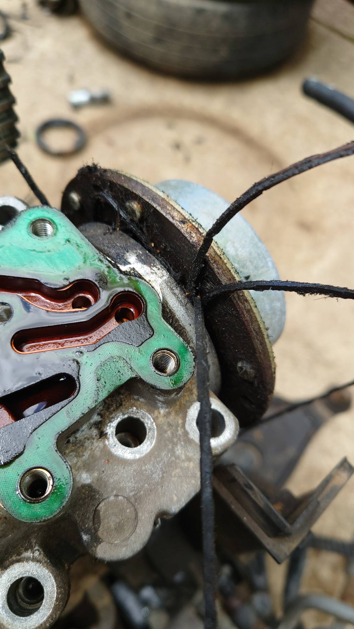

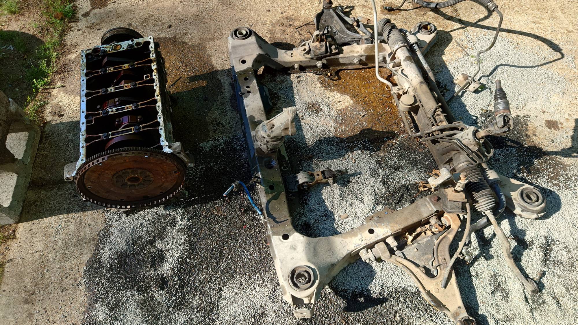

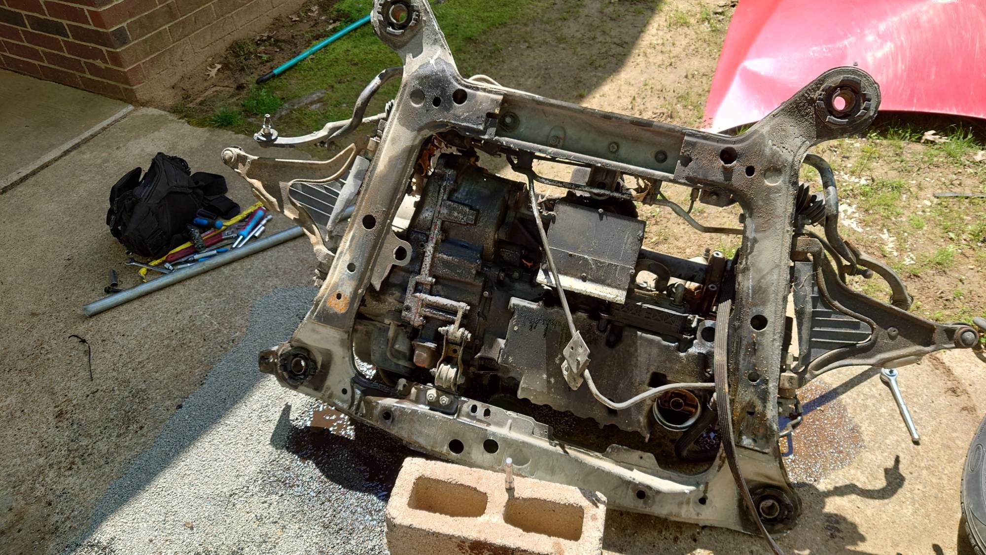

Today from about 830am to 7pm (minus an hour) I spent my time tearing down engine/trans assembly from donor car. got down to block and crank. gotta take to auto place on monday to get the 29mm crank bolt out so i can get the crankcase off. 29mm socket stuck on it.

ZionXIX wrote: ↑29 Apr 2023, 16:22 Got all the exhaust manifold bolts removed, all but 1 stud came out with the nuts. Now the coolant lone is giving me a lot of grief. How do I remove this lower bolt? I can get a 10mm box end wrench on but it's touching on both sides so you can't actually turn the wrench. Sockets will fit but the ratchet is too wide. I assume I cannot remove the head with this in place.
I wasn't able to remove the coolant tree without removing the exhaust manifold, due to the bolt closest to the drivers side in your pic.
As I recall it was tucked up behind the manifold.
