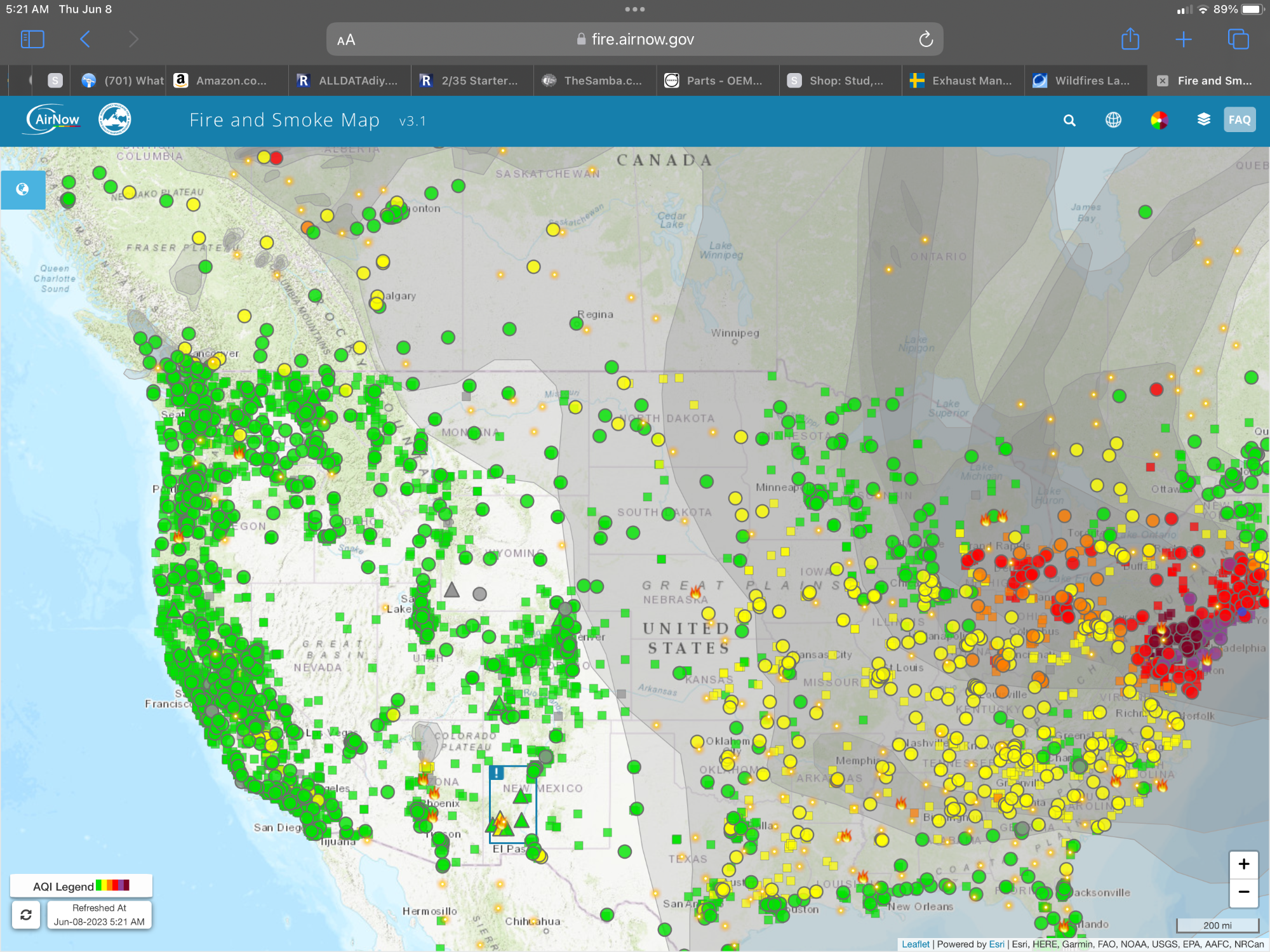

We are under a nasty air quality emergency in NYC for a few days, ooof. No outdoor work

Code Purple here in DE at the moment (AQI 201-300), airport closed in Philly. At one point last week smoke detectors were going off inside peoples houses mid-state, but that may have been a smoke event from the forest fires in NJ.abscate wrote: 08 Jun 2023, 03:35 A good deed fully punished….indeed.
No outside for me today either. Power went out earlier, burning diesel now.
Folks up in Ontario have their hands full with this mess.
