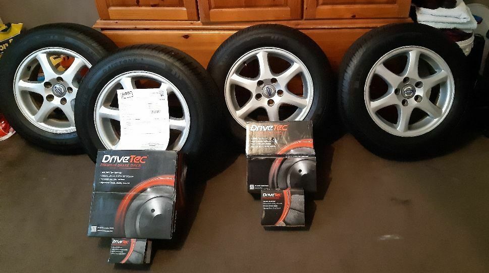

One of the first things I did when I bought the car was to have 4 new tyres fitted. I ordered 4x 205/50R16 tyres from National Tyres and they were fitted the very day the UK went into Covid lockdown. Once fitted the car was taken a short drive and then tucked away in the garage as we were not allowed to go out, I did notice on the drive that the balance was not correct but with everywhere closed there was nothing I could do. A few weeks later when in the garage tinkering I noticed the front nearside and rear offside tyres were 205/55R16 and the other two were the correct size. I contacted National tyres and they ordered in another two tyres the correct size. When I went to have them fitted I told them that I thought the balance was out and after they fitted the correct size tyres they re-balanced the wheels saying they were indeed out, however there has always been a slight vibration starting at around 65mph.

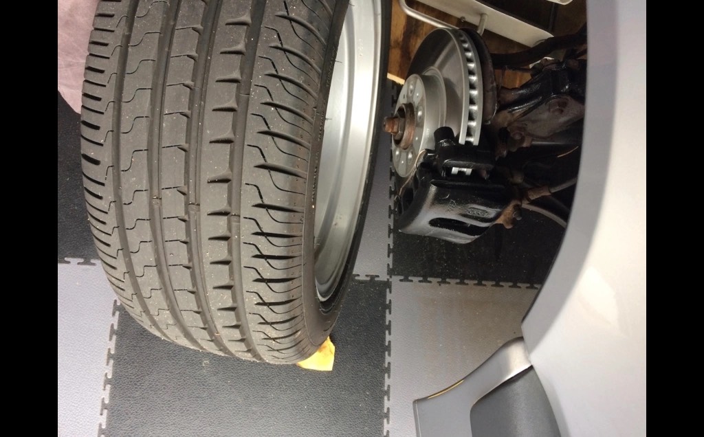

3 years on and coming back from Dumfries at the weekend and at motorway speeds I decided I had enough and took the car into RD Tyre Service to have them re-balanced, Gerry was a pleasure to deal with, he was careful not to mark the wheels and torqued them to the correct 110Nm. His findings were O/S front 10 grams out, N/S front 15 grams out, O/S rear 30 grams out, N/S rear was fine.
Took the car a blast up the motorway and it's as smooth as butter.

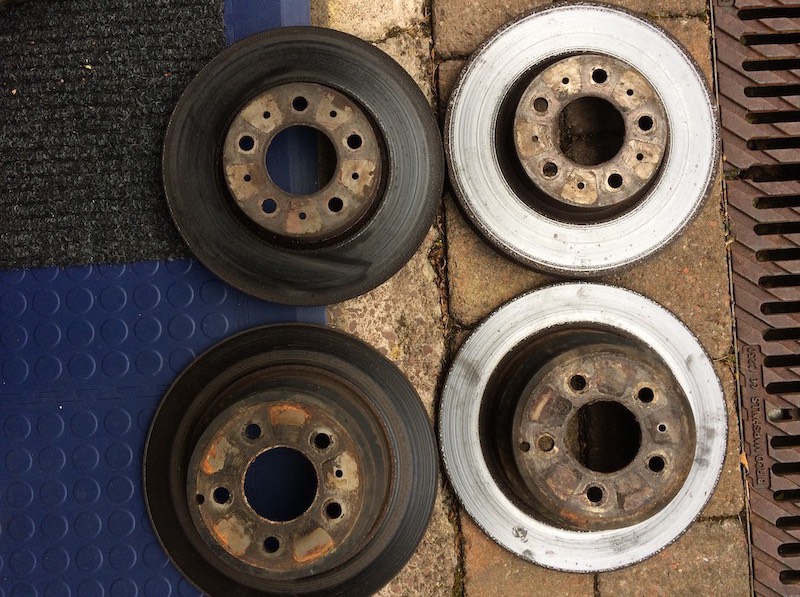

They are now 3½ years old and the only non Volvo part on my car. When I purchased the 850 the original factory discs were still on the car, these discs (rotors) were in a box in the boot (trunk), the previous owner never got round to having them fitted. Because they were non Volvo I was going to sell them but decided to give them a try and I'm glad I did, if I had fitted Volvo discs they would be rusty by now. Some aftermarket parts are better than others
Original discs from 1996 New discs & pads were supplied with the car This was after 2 years of use
- Posts: 14876
- Joined: 5 April 2010
- Has thanked: 1841 times
- Been thanked: 1710 times
Any chance they are coated Zimmermans? Even here with the noxious de-icer they use on the roads all winter they take a long time the corrode.
