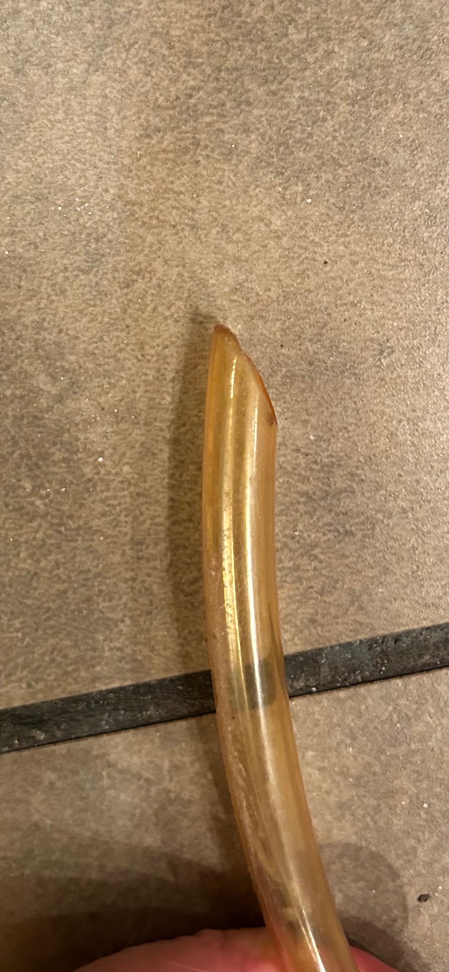

You can empty some/most? fuel tanks using a small tube into the fuel filler tube. The tube must be about 3/8 inch or smaller to get it worked past the anti syphon flapper in the tube. If it gets stuck, twist, push and pull to work it loose. A hard nylon tube has worked best for me. Soft rubber will not get to the bottom of the tank. You will not be able to see where the tube goes, so you must twist and push the tube until you can pump out fuel.
There are small hand crank pumps that work, but are slow. You could also set up an electric replacement fuel pump to do the work of pumping out of the filler tube.

I use this cheap siphon rig, works well on P2 cars (S60, V70, XC70 01-07). Just did an S60 fuel pump with it this weekend. The nylon tubing I just had laying around, not sure the dimensions, but 7/16 OD x 1/4 ID is close. With the tubing cut to an angle on the input end, the point slips right past the flapper mentioned by volvolugnut.
