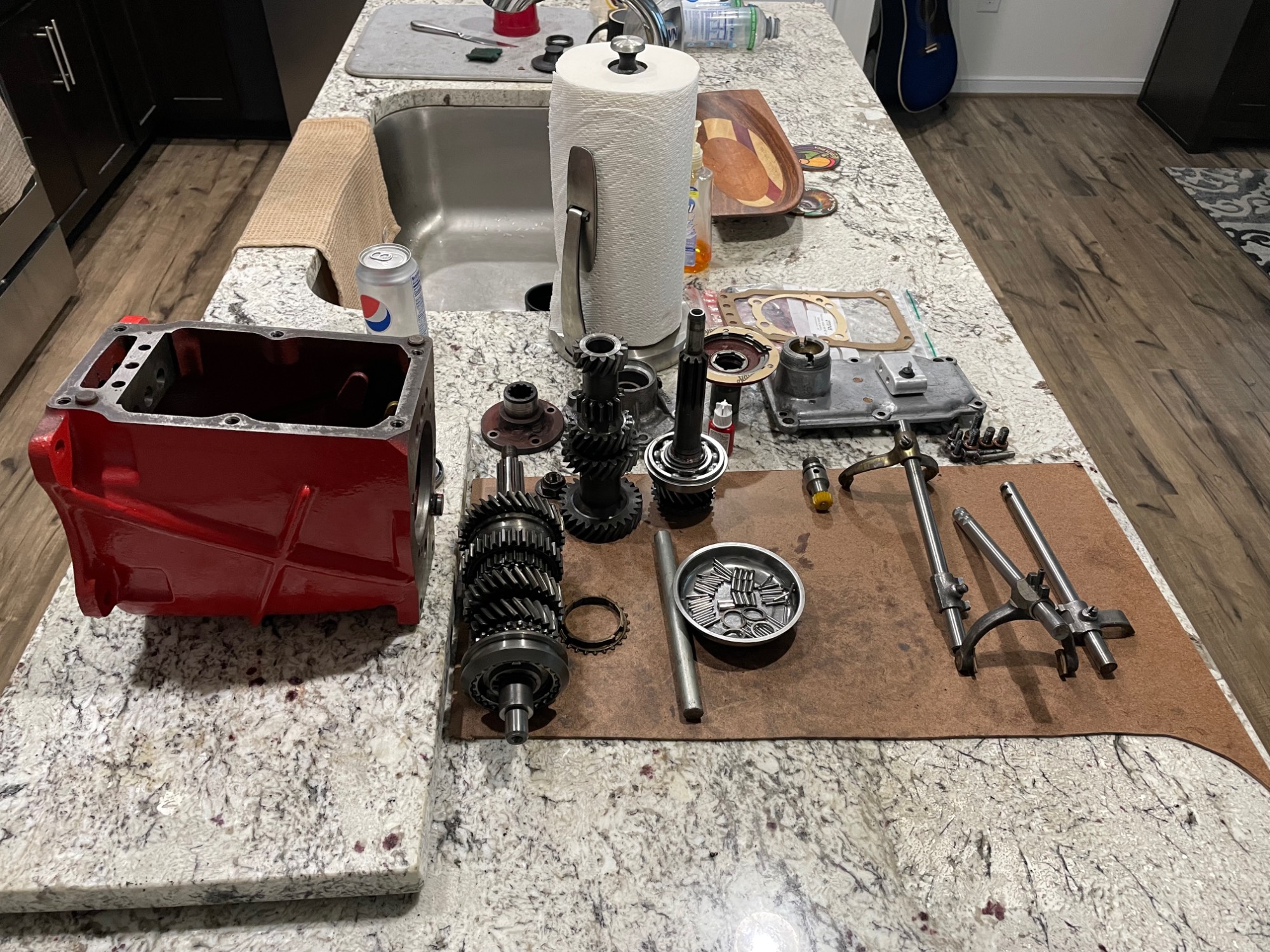

Transmission is still apart. I’m waiting on a counter shaft. When I ordered my parts last week I found out afterwards that the shaft just ran out of stock and I told them to ship what they have. Once I got it apart I discovered that the counter shaft for the lay gears had a groove worn into it through the hardened surface on the input shaft side of the box. The needle bearings were buggered up at that location as well. I spoke with VP today and they have a counter shaft for me. I had them ship that and a full set of needle bearings for both shafts overnight. I ended up taking the main shaft apart b/c it came apart when I was taking the rear housing off the shaft to replace the bearing. I spent all day yesterday getting to know it very intimately.
I replaced all the springs for the dogs/synchronizers and picked the worst synchronizer and replaced it (I had one). But really, all the gears and well everything else looks real good. The gears show very little wear.

The old transmission in the kitchen sink - always a popular choice!

If I was married, I would be sleeping on the couch. I have this big country sink, perfect for washing bell housings and such..BlackBart wrote: 21 Aug 2023, 17:33 The old transmission in the kitchen sink - always a popular choice!

Nothing gets'em cleaner than a trip through the dishwasher.

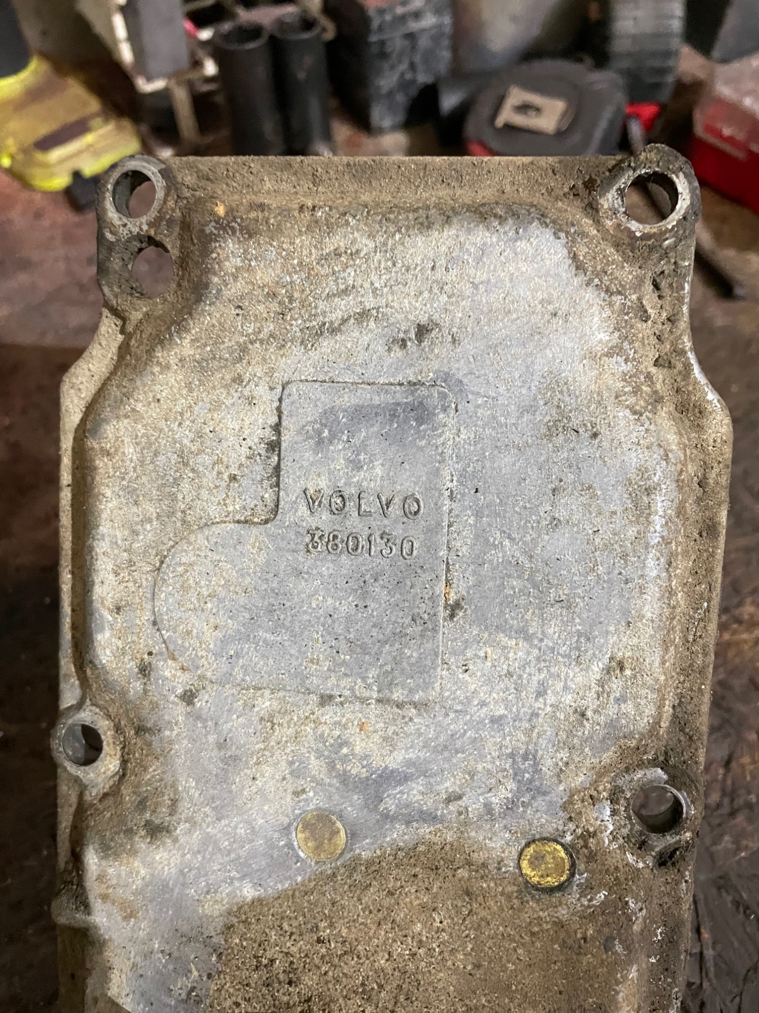

Still waiting on my overnight delivery… Thanks FedEx. Over bill, under deliver. Anywho, more easter eggs pointing to its possible race heritage. While I was piddling around waiting for parts that would never come today, I cleaned the top cover amongst other things. I didn’t know what the 62 stamped into the cover meant. Was it a factory thing. Well scratched into the cover is “62 Cover”. Wondering if they numbered their transmissions to keep things together. Possible. Also, there is no “Volvo” stamped into the cover above the part number. Two pics of my race cover.
And a couple pic’s of a trans cover I got at a junk yard in Culpeper yesterday. FYI, they have a few 140’s and two 130’s.
