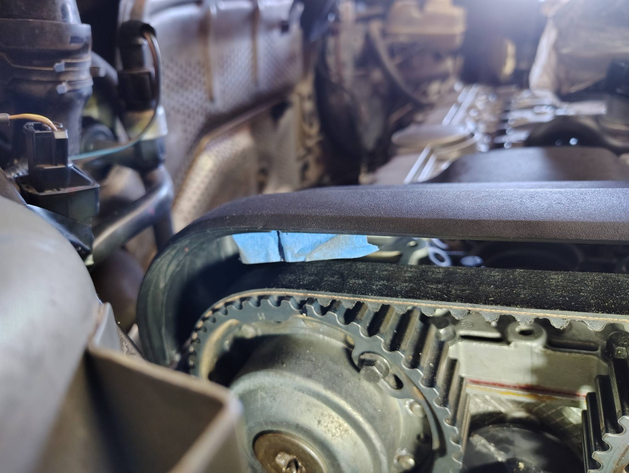

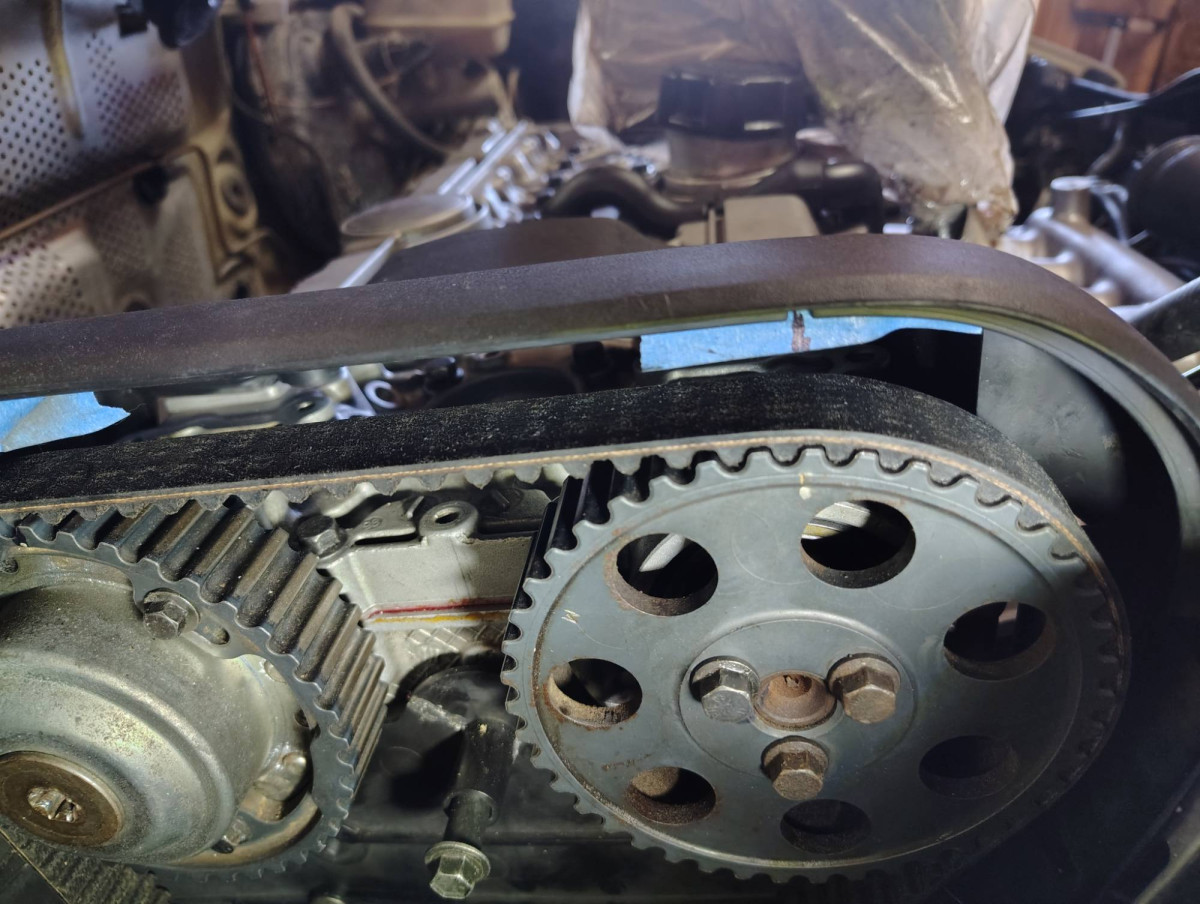

Well I installed the timing belt today, and that exhaust vvt hub is a challenge. Following instructions, I set and tightened the hub 1 tooth retarded from the mark on the cover. Then when I went to install the belt, I cranked the hub clockwise to its limit. But I see that I am 3/4 - 1 tooth past the mark now. Is this taken up in the hub, or should I loosen the gear, rotate it one tooth counterclockwise and reinstall ?

Decided to go ahead and loosen things up and set that gear a tooth back. Going to wait till I have a second set of hands to help hold things.
850's are without a doubt easier to do this on. I hope there is a noticeable difference in operation with the VVT that makes it all worth while.

You get a nice HP boost with VVT. It can take a few tries to get it snicked in but it’s worth it
