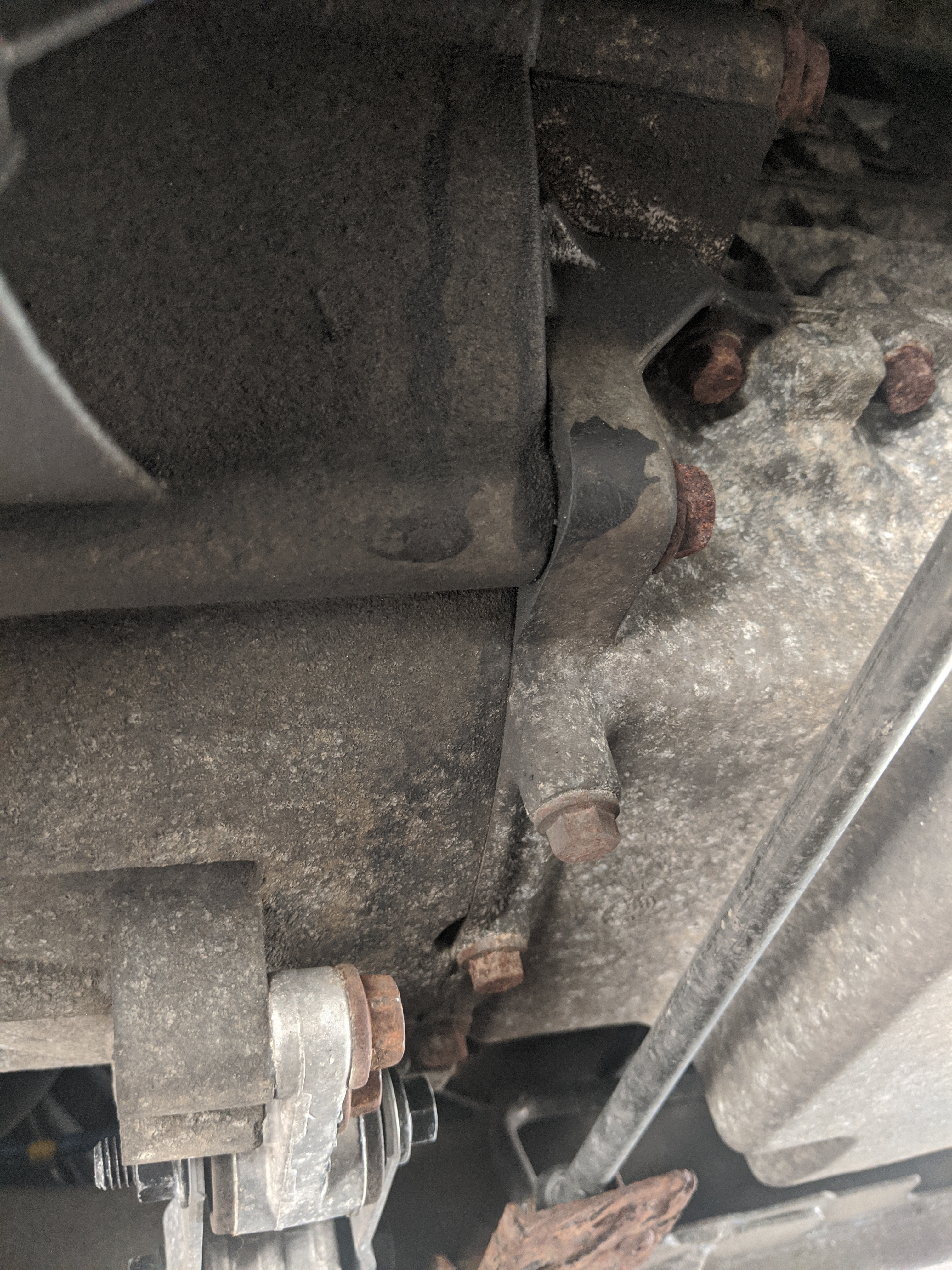

Post by smacknab »
Anyone know if the process is the same for a m56 transmission? The mating of the oil pan and transmission makes me worry a bit that I don't have the right seals etc

Post by JimBee »
smacknab wrote: 23 Apr 2020, 13:44 Anyone know if the process is the same for a m56 transmission? The mating of the oil pan and transmission makes me worry a bit that I don't have the right seals etc
Your photo is looking at the back of the engine. There are no seals back there. All the seals at the front.
Posts: 36174
Joined: 17 Feb 2013, 17:54
Has thanked: 1614 times
Been thanked: 4078 times
All data says there are 2 bolts that go from transmission in to bosses in the oil,pan. These don’t need sealant
