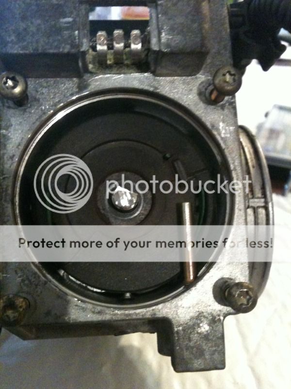

First of all, thanks to all of you who posted on this topic. You've been very helpful. I've read all the information, but would like clarification on the connections of the new sensor. Do the three prongs of the Sacer unit get soldered to the corresponding prongs protruding out of the ETM? One photo appears to have wires attached to the two outside ones, which creates a question in my mind.
precopster
- Posts: 7543
- Joined: 21 Aug 2010, 00:20
- Year and Model: Lots
- Been thanked: 128 times
RMSDave wrote:First of all, thanks to all of you who posted on this topic. You've been very helpful. I've read all the information, but would like clarification on the connections of the new sensor. Do the three prongs of the Sacer unit get soldered to the corresponding prongs protruding out of the ETM? One photo appears to have wires attached to the two outside ones, which creates a question in my mind.
No disrespect to the guys who have posted on this topic but my post on 6th April 2012 shows the terminals exactly as they are meant to be attacked. The TPS which has the bulbous protrusion should not be removed, it should just have the fourth terminal separated to take the black lead from the new Sacer sensor. Hope this helps.
However I must stress that no sensor should be removed until voltages from the original sensor are taken so that they can be matched by angle cutting the shaft or the magnet as per Jack's (Yucka) post.

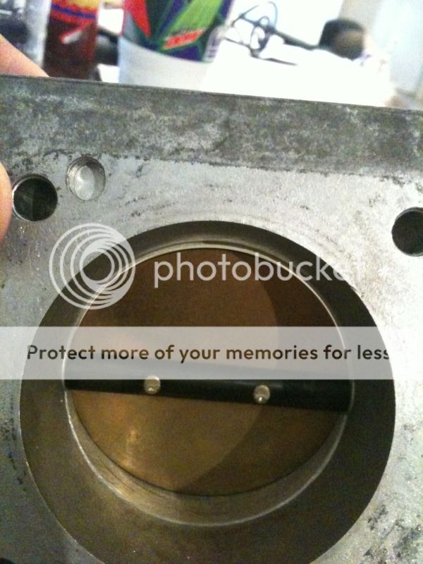

Hey guys, Thanks to Matt I now am knee deep into changing out this TPS for a Sacer unit.
So far so good except when I removed the throttle body I noticed that the flapper is not fully closed, is it supposed to be fully closed when it is at rest?
do I fix it?
how do I fix this?
is it a big deal?
do I fix it?
how do I fix this?
is it a big deal?
precopster
- Posts: 7543
Nothing to fix. The throttle plate has a resting angle of around 5 degrees. Keep it up and you'll have it done soon. Did you take voltages prior to cap removal?
