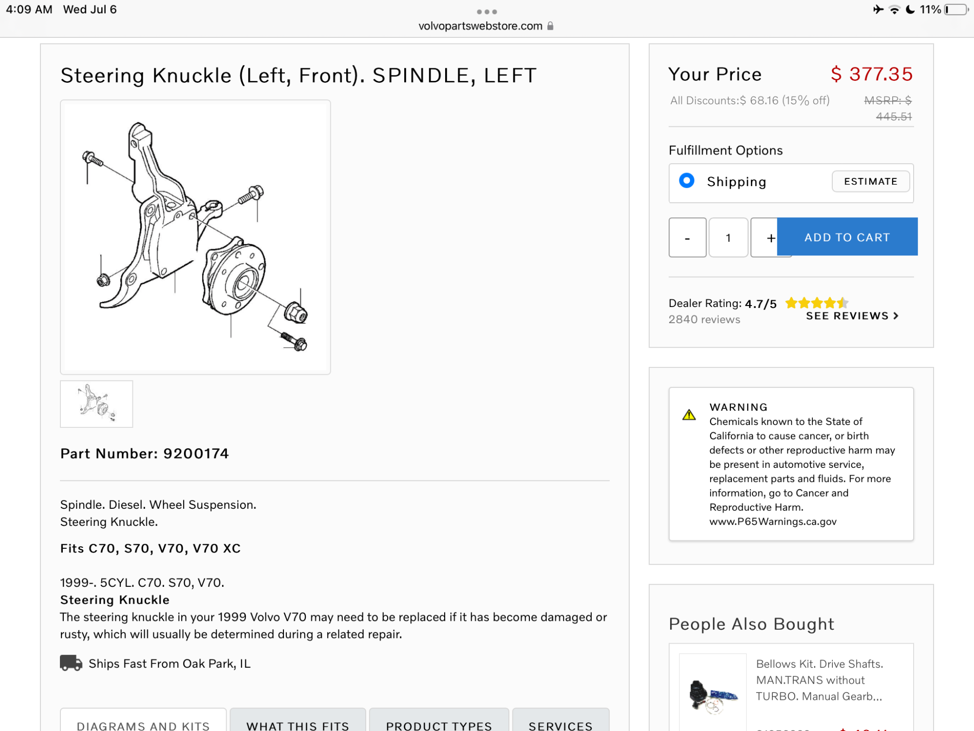

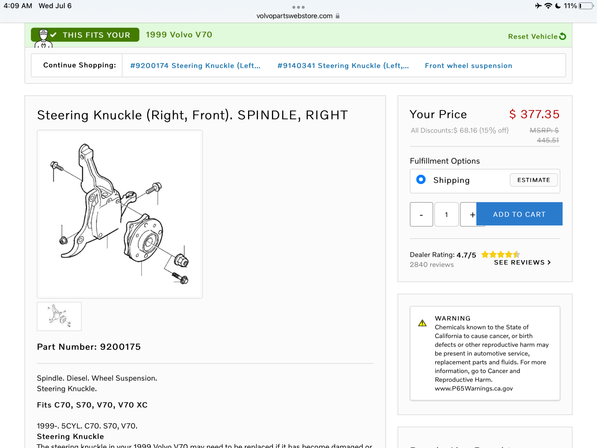

Spindles left/ right are 1999 2000 onlyabscate wrote: 13 Mar 2022, 07:02 Front wheel bearing hub part numbers change for 99,00
viewtopic.php?p=596081#p596081
1999 2000 MY - The "Bastards" Draft Info Thread
- Posts: 36147
- Posts: 15487
- Has thanked: 2199 times
Trying to think why it would be different. Yes you go from the 32/36mm nut on a thread for the axle to the threaded center axle bolt and washer, but can't think why they would otherwise be different. You also get the 4 bolt and 2 bolt lower control arms but would that make them different?
Hm??
Hm??
- Posts: 36147
Abs sensor and hole is different
- Posts: 15487
Ahhhh!

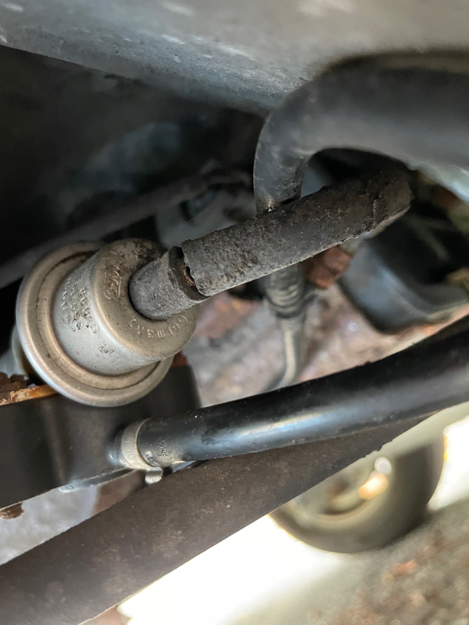

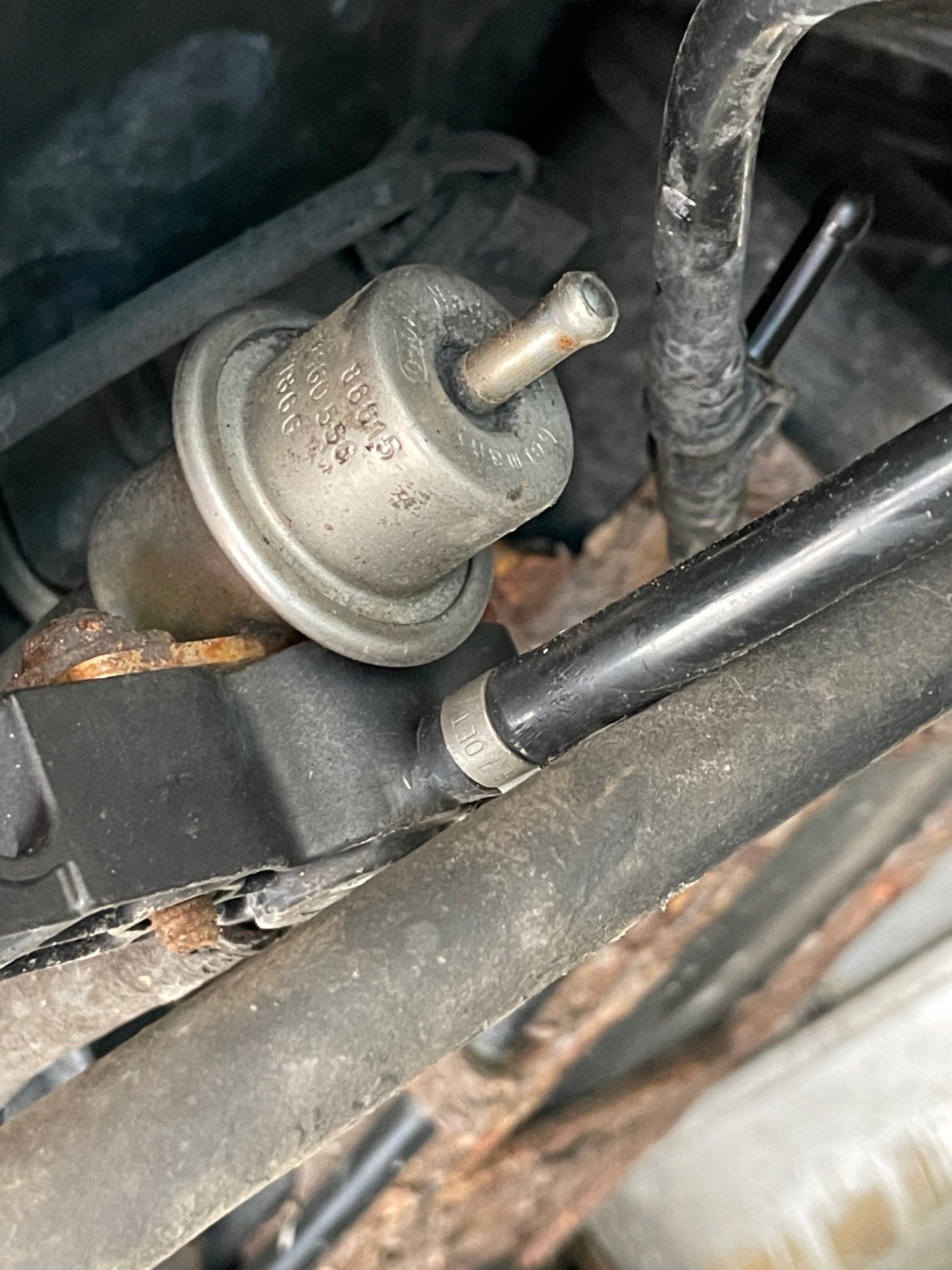

The fuel pressure regulator is moved to the back of the car, right rear wheel on FWD and on top of tank for AWD
The dump for excess pressure goes back to the pump in FWd and is used for siphon saddle tank pumping on Awd
The vacuum for the FPR is a tee of the evap purge line vacuum line. No one has figured out how Volvo uses that signal to regulate fuel pressure in real time
Update! With motronic 4.4 the engine management is clocked fast enough that injection time mitigates manifold pressure. Variation. This happened with NA motors in 1998, and means the fuel pressure is now just regulated to the 42 psi relative to atmospheric, Volvo uses fuel tank pressure as reference.
In 1999 ME7 was even faster and this applied to turbo models , too

That is a classic example of hose embrittlement failure.
