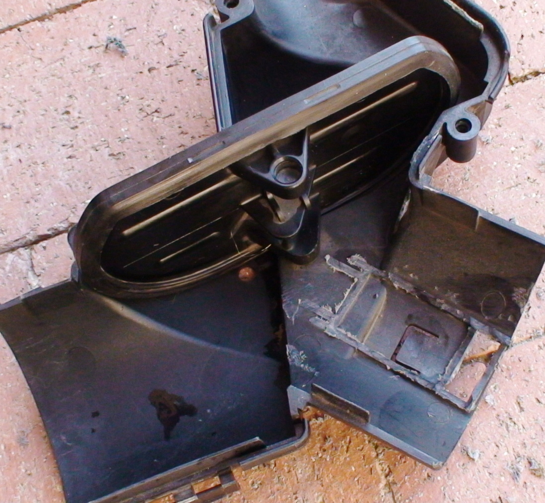

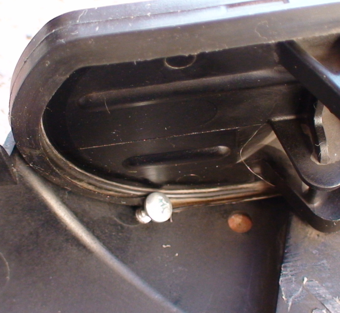

I just ran across this thread and checked the airbox t-stat on our '95 850. T-stat was stuck on the hot side as so many others are. Since we live in Texas and have mild winters I just removed the stat, ground down the housing and set the diaphram with a screw.

Good deal. Looks great. This thread is definatly one of the most useful and easy to do repairs on the site. haha
