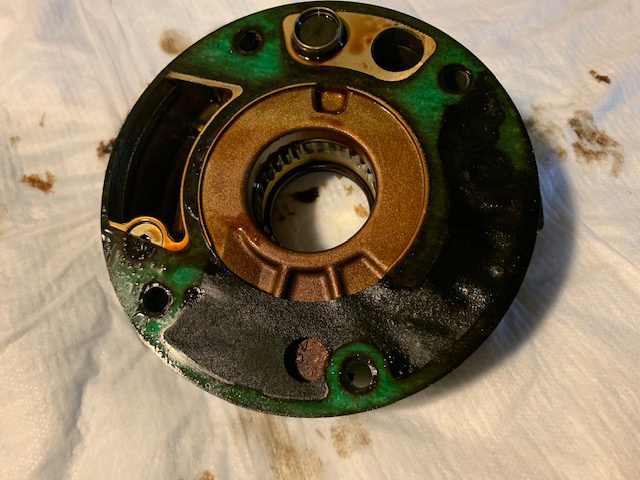

Now reached the oil pump, gave it a simple green 50/50 mix bath. I can turn the T-30 with stripping for next step.

Is there a special method of cleaning the oil pump?

Just make certain you get all the old gasket material off. I used a dollar store kitchen sink scrubby/yellow foam thing. You don’t want to abrade the surface too much. Other than that just spray it out with brake parts cleaner & blow dry with compressed air if you can. Or dunk it in your simple green solution & let dry.

The paper seal was crisp - crumbled in to pieces. Watching a cleaned pump can be a joy in itself -- a bath in 50/50 mix of simple green.

I agree! When you look at its design & see how it works it is very evident why these pumps are good to 500k & beyond.

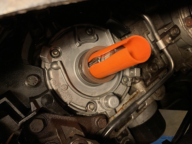

I installed the pump first and then the crankshaft seal using the magical cone.

Post by xHeart »
- Pete - wrote: 21 Mar 2020, 22:32 How many tries did it take you?
The four T-30 screws were coated with anaerobic sealant at the screw head.
The slit on the cone is a clue to watch as the seal transfers -- generous lubrication and 2 tries. Here is a set up of Pete Method:
