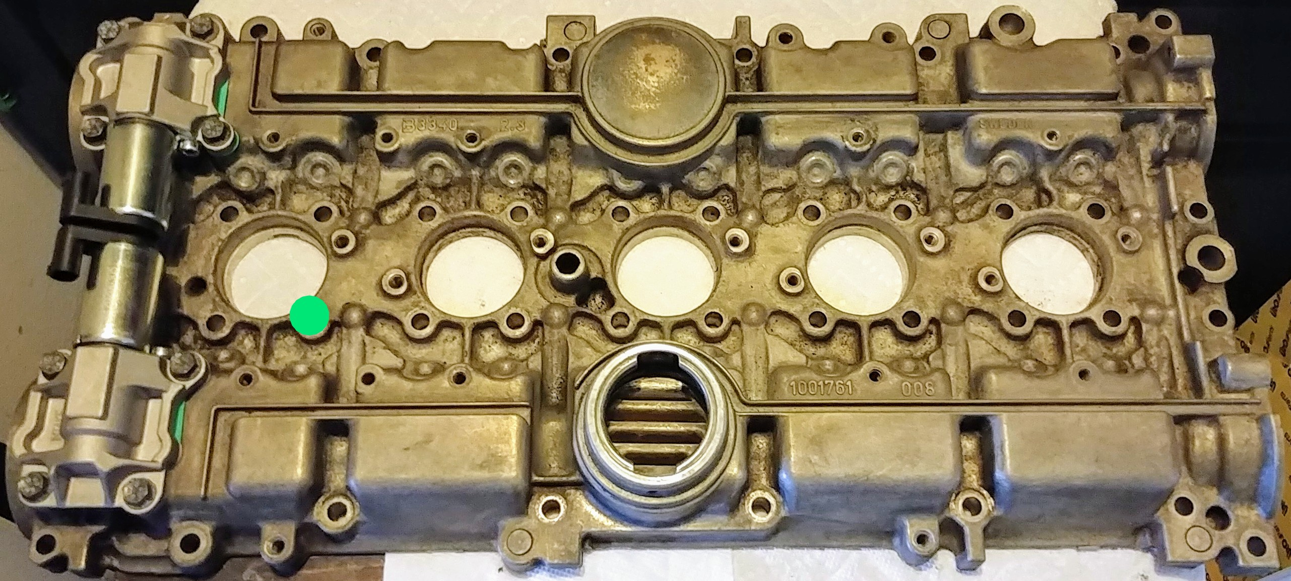

Can you help me figure out what bolts are for the cover over the cams. They're a 10mm head and about 40mm in length with a little bit more grip than the intake manifold bolts. Basically the intake manifold bolts but a little longer with a little more grip. I lost one and need to buy one but couldn't find them. I dont know what the bolt is called.
These are intake bolts in picture.
And place which I have lost a bolt is the green dot.

TyRawr wrote: 19 Aug 2020, 19:06 Can you help me figure out what bolts are for the cover over the cams. They're a 10mm head and about 40mm in length with a little bit more grip than the intake manifold bolts. Basically the intake manifold bolts but a little longer with a little more grip. I lost one and need to buy one but couldn't find them. I dont know what the bolt is called.
Its called 985135 which supersedes the old part number
Flange screw.
