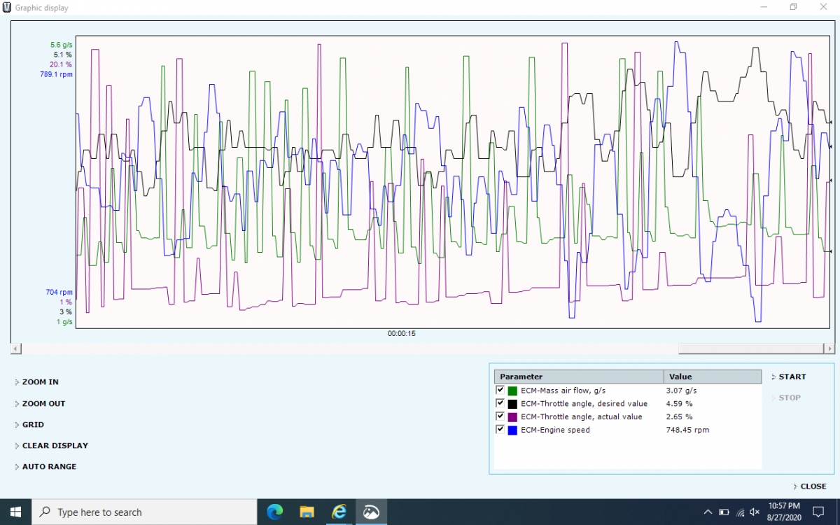

I've checked everything else that I could think of so far, along with others suggestions to check.
I wish it wasn't so expensive to replace the ETM. I looked at different tutorials on fixing it myself by replacing the TPS, but it doesn't look like something I can do myself without causing more problems.
I really appreciate the help from everyone here, both with parts and advice. If someone could help with the cost of the XeMODeX ETM, I could make payments to pay it back. I just can't afford the whole amount at once. It'll probably take me 4 to 6 months to pay back, but if someone is ok with taking payments I can pay it back.

I did go through the flow chart, and when I got to the step where I removed and reinstalled fuse #7 the ETM clicked on, whined for about 10 seconds, and then shut off. I did that about a six times to make sure, thinking maybe the clicking sound only showed up when it wanted to. The flow chart says it should whine for 6 seconds. I don't know if the difference in time matters or not. The flow chart then had me check for MAF codes, which I don't have any codes related to the engine at all. I attached a graph of the different parameters that keep jumping around. Can anyone tell by looking at the pic if it's the MAF, ETM, or possibly both? Maybe something else altogether? I didn't find any vacuum leaks anywhere, and looking at the graph I don't really know what's causing my problems.volvolugnut wrote: 27 Aug 2020, 18:49 gnalan, Did you run through the XeModeX ETM test flowchart? Did results point to ETM failure?
- gnalan
- Posts: 968
- Joined: 21 Jul 2020, 13:39
- Year and Model: 2001 S60
- Location: Ohio
- Has thanked: 557 times
- Been thanked: 135 times
The graph is with the car at normal operating temp. When it was cold it did the same thing, but I didn't get a screenshot.
