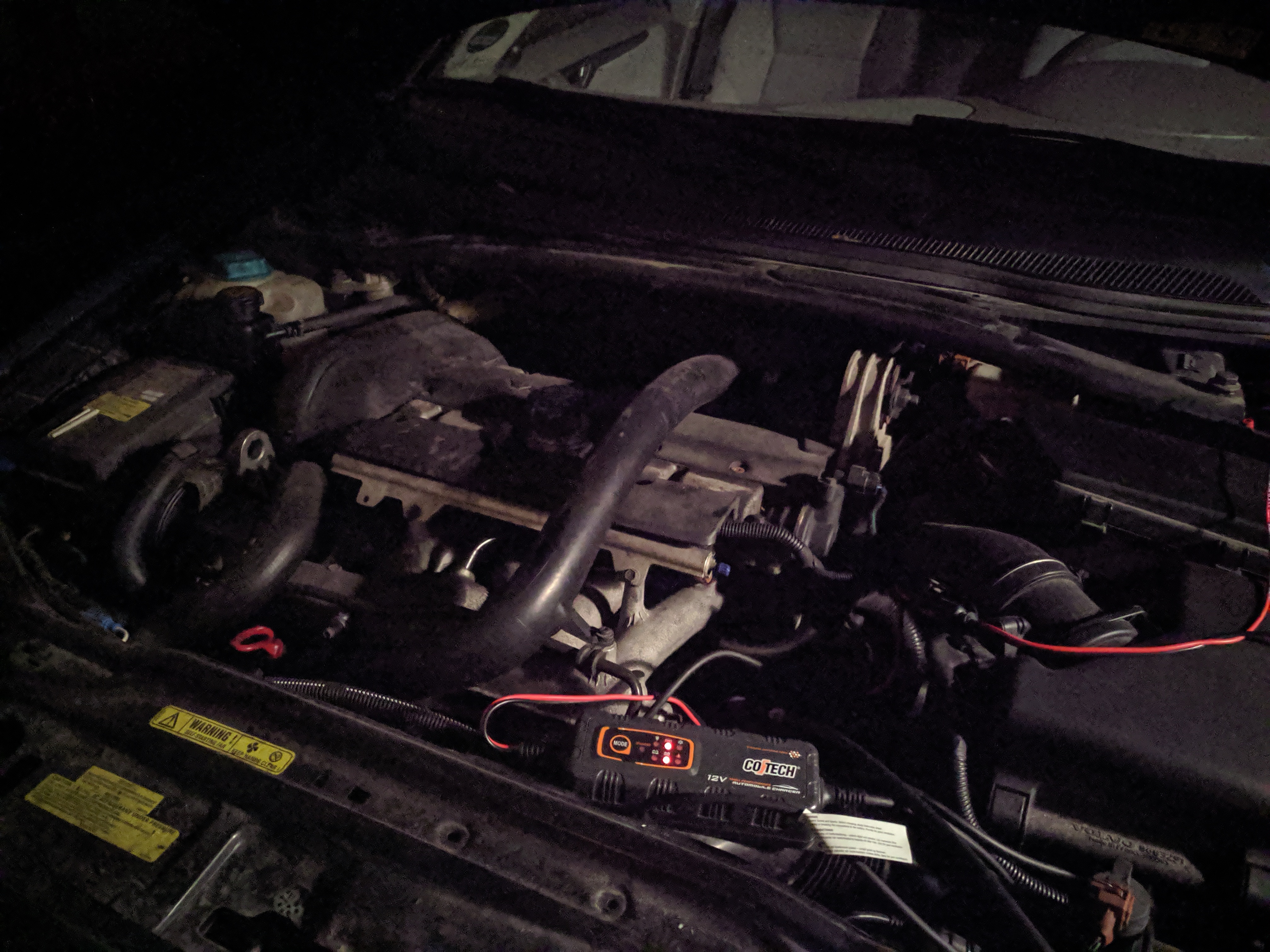

Not really. Just above freezing and drizzle so the snow was saturated with water.
Today I took the battery of the charge it's been on the last two days. It's been ages so I thought it was time for a top-up.

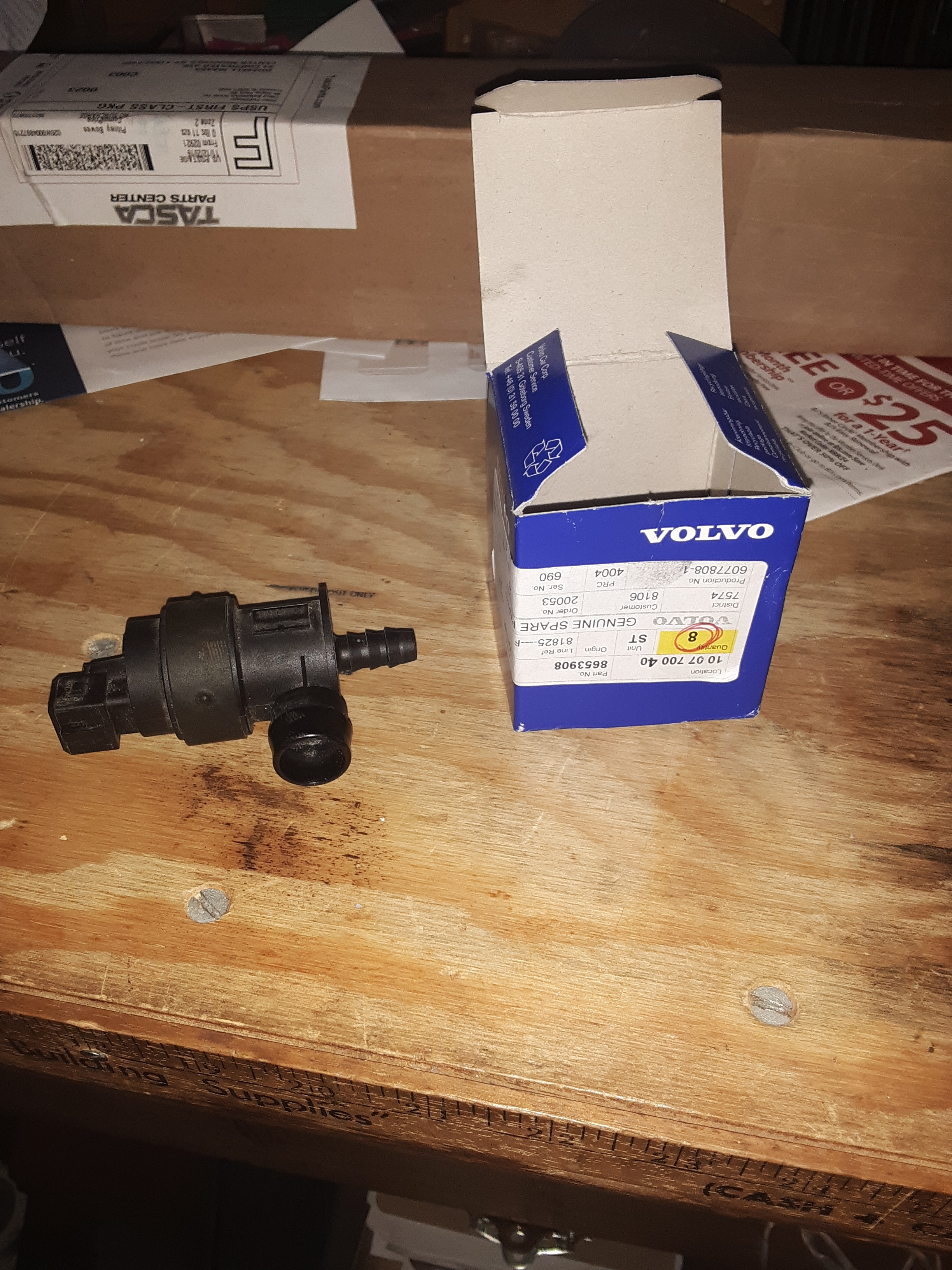

- shiloh51933
- Posts: 1005
- Joined: 5 March 2010
- Year and Model: 04 XC70/'98 V70XC
- Location: New York
- Has thanked: 28 times
- Been thanked: 17 times
I replaced the factory purge valve along with some of the EVAP line by the IM. This is the second time I'm replacing the purge valve on this vehicle, 2004 XC70. Fortunately I purchased the first one from FCPEURO.COM, so replacements are covered for life.
