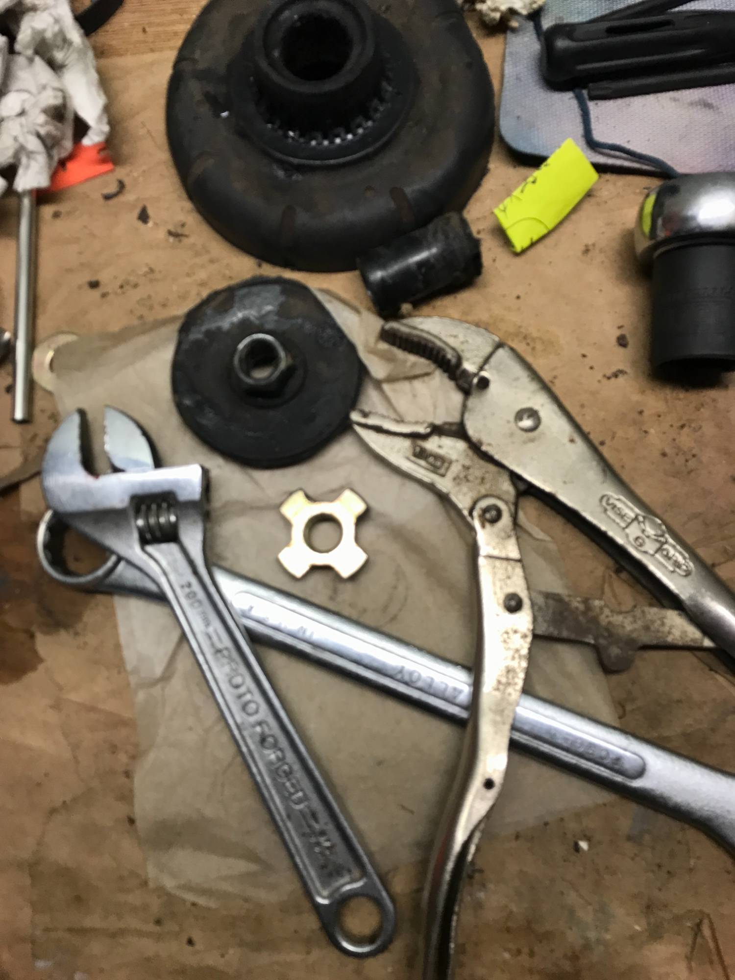

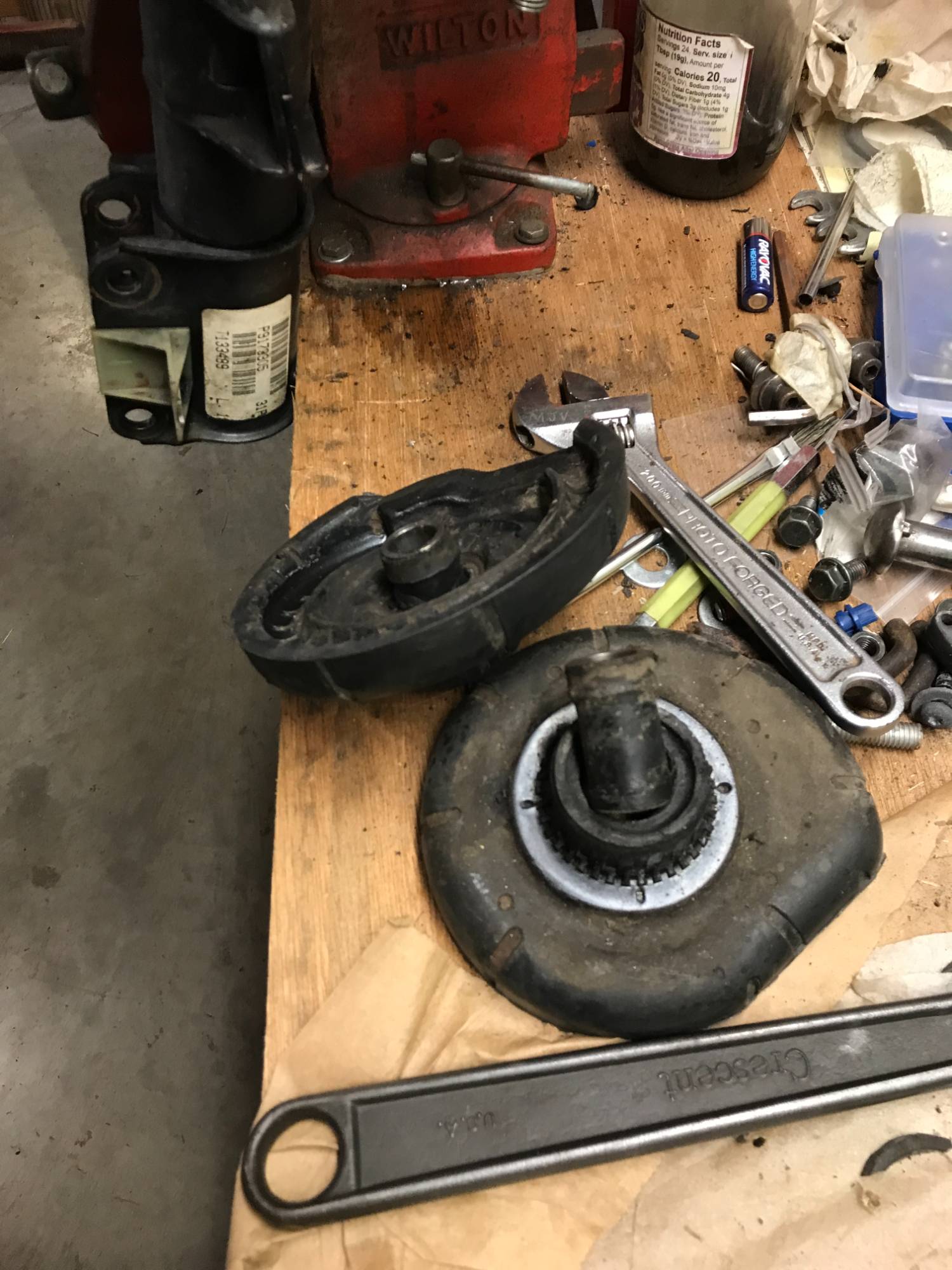

Into the breech once more (Actually days ago when it was >90F)
Fast food iced tea and semi-conditioned workspace made it tolerable.
iPhone 7s are notorious for taking junk pics - from new.

Or is that pictures of junk.......!
Those are slightly past their best.
