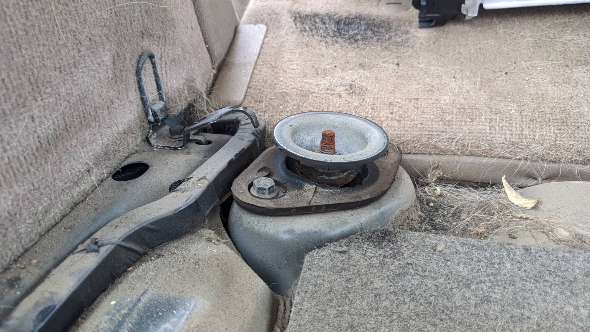

Replaced the rear shock mounts on the '98 V70 today... Was doing the california lowrider/hydraulics thing when you stepped on the brakes. This would be why...

OMG mine were just as bad. I had to use a grinder to cut out the frozen nut on left side though. Off topic though: What dog do you have? Whenever I buy a new car, I strip all seats and covers out (excluding trim) to clean all that up. Occasionally (like once every 6-8mo) I do it again to keep the interior air clean.wizechatmgr wrote: ↑29 Aug 2023, 23:32 Replaced the rear shock mounts on the '98 V70 today... Was doing the california lowrider/hydraulics thing when you stepped on the brakes. This would be why...

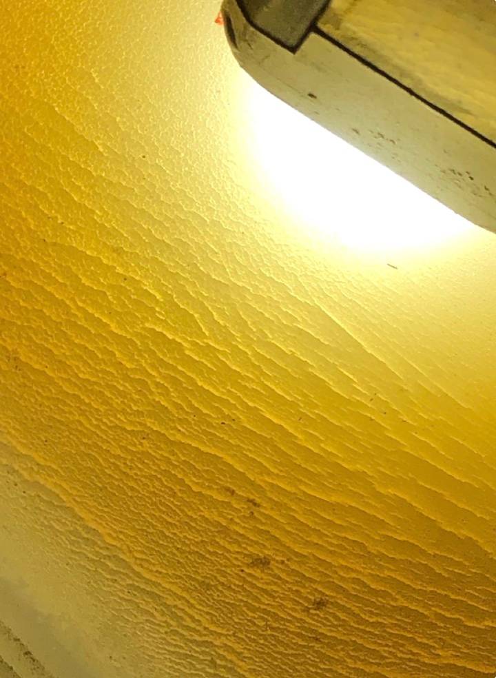

Finally replaced the coolant reservoir on my 99 s70.
Every now and then I would notice that my coolant level would dip. I'd add more. and it would vanish.
I suspected the cap, maybe something else, but then I shined a light into my reservoir and noticed all the crazing.
Maybe some of these cracks were letting pressurized vapor escape over time. Who knows.
I figured I'd replace the reservoir and cap to see if that made a difference. Super easy job once you figure out how to separate the coolant and power steering reservoirs . That was super frustrating until it because super easy. Just had to get a screw driver to release the top tongue of the power steering reservoir that locks it to the coolant reservoir.
we'll see if this solves my problem
