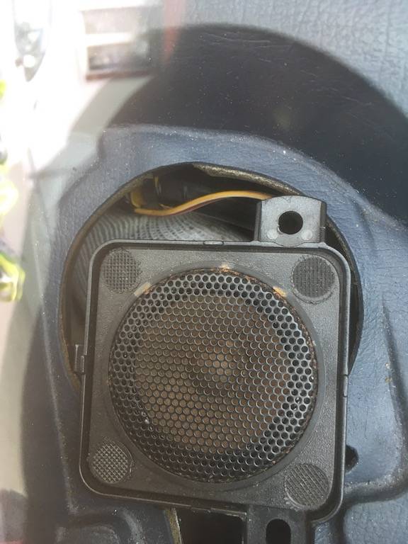

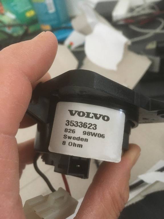

Have replaced dashboards speakers, dead ones, with the ones from a V70. It works fine. Sound equilibrium back again. But one of my speaker is out. Need to find another one. Do you think speakers from a more recent V70 could fit ?
